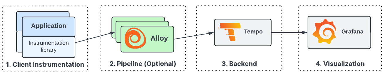

Along with metrics and logs, tracing is one of the three pillars of modern observability. Tracing is a way to track a single request across all of the services in your infrastructure.
Grafana Cloud Traces exists as a pre-configured Tempo data source within each Grafana Cloud stack. If you want to configure a different Tempo data source, refer to Connect to data sources.
How to send traces
Traces emitted by your instrumented applications or services can be sent to Grafana Cloud Traces. To send traces to Grafana Cloud Traces, you need a running Grafana Alloy (preferred) or Grafana Agent (legacy) instance or an OpenTelemetry Collector instance in your environment.
