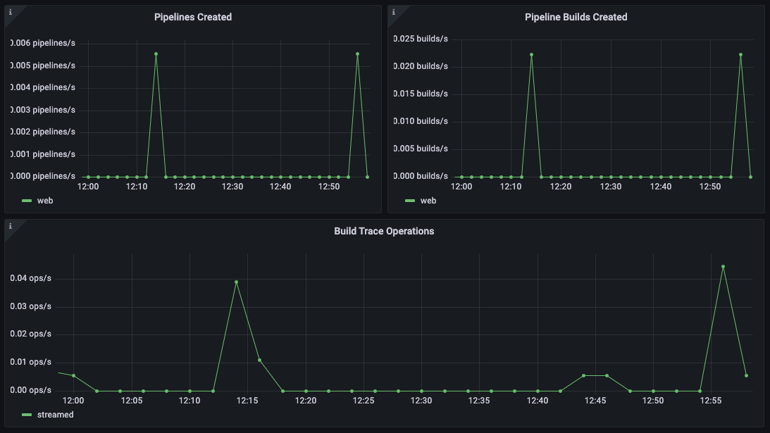

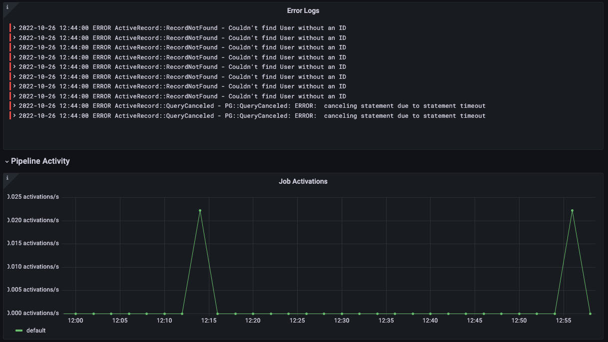

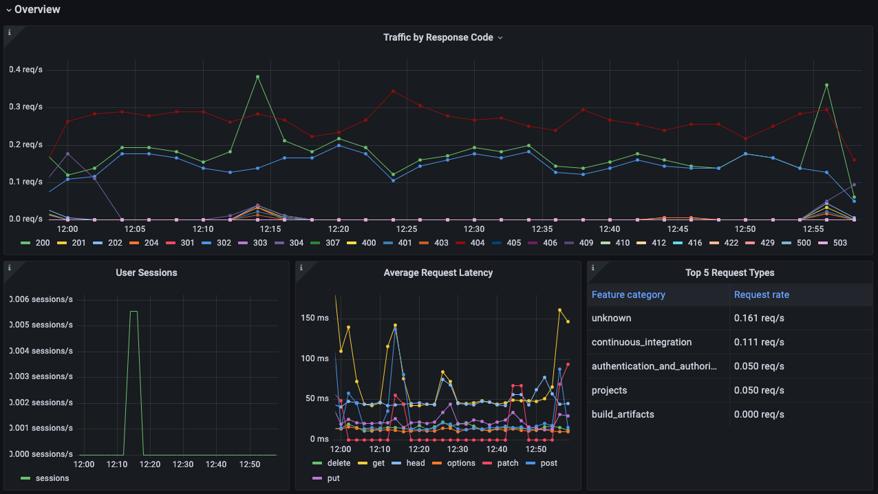

GitLab overview dashboard 1
GitLab overview dashboard 2
GitLab logs
