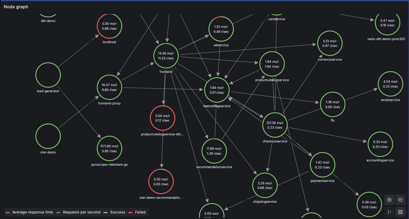

Each circle in the graph represents a service. Numbers inside the circles indicate the response time and requests per second.
Each circle’s color shows the proportion of successful and failed requests:
| Color | Meaning |
| Green | Success |
| Red | Fault |
| Yellow | Errors |
| Purple | Throttled responses |
The color mix of each circle shows the proportion of each state. A mostly green circle indicates healthy traffic; visible red, yellow, or purple arcs indicate faults, errors, or throttling respectively.

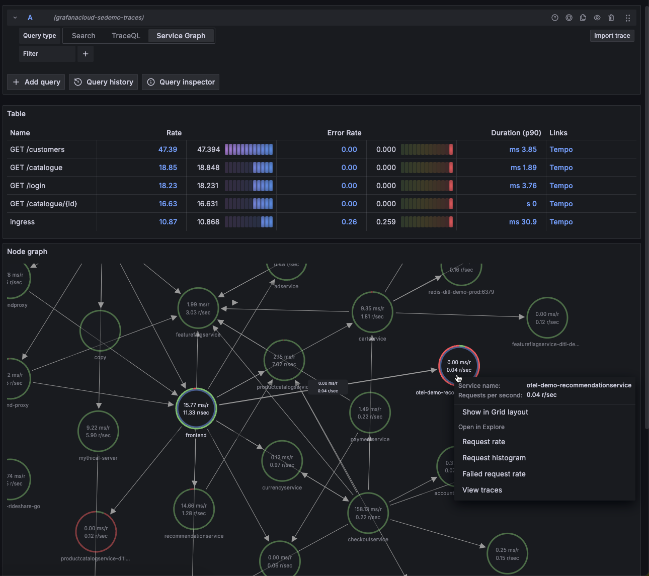

To open a context menu with links for quick navigation to traces, metrics, and related views, click a service.

Service Graph view
The Service Graph view displays a table of RED metrics (rate, error rate, duration) alongside the node graph. The table uses a different set of metrics from the node graph:
traces_spanmetrics_calls_total: Rate and error rate columns.traces_spanmetrics_duration_seconds_bucket: Duration column.
These span metrics must be present in your linked Prometheus data source. Span metrics generation must be enabled in your Tempo or Alloy configuration. Refer to Enable service graphs in the Tempo documentation.
For details on the Service Graph view, refer to the Service Graph view documentation.
To open the Service Graph view, follow the same steps as Display the Service Graph. The table appears alongside the node graph after you run the query.
To open a query in Prometheus with the span name of that row automatically set in the query, click a row in the rate, error rate, or duration columns.
To open a query in Tempo with the span name of that row automatically set in the query, click a row in the links column.
