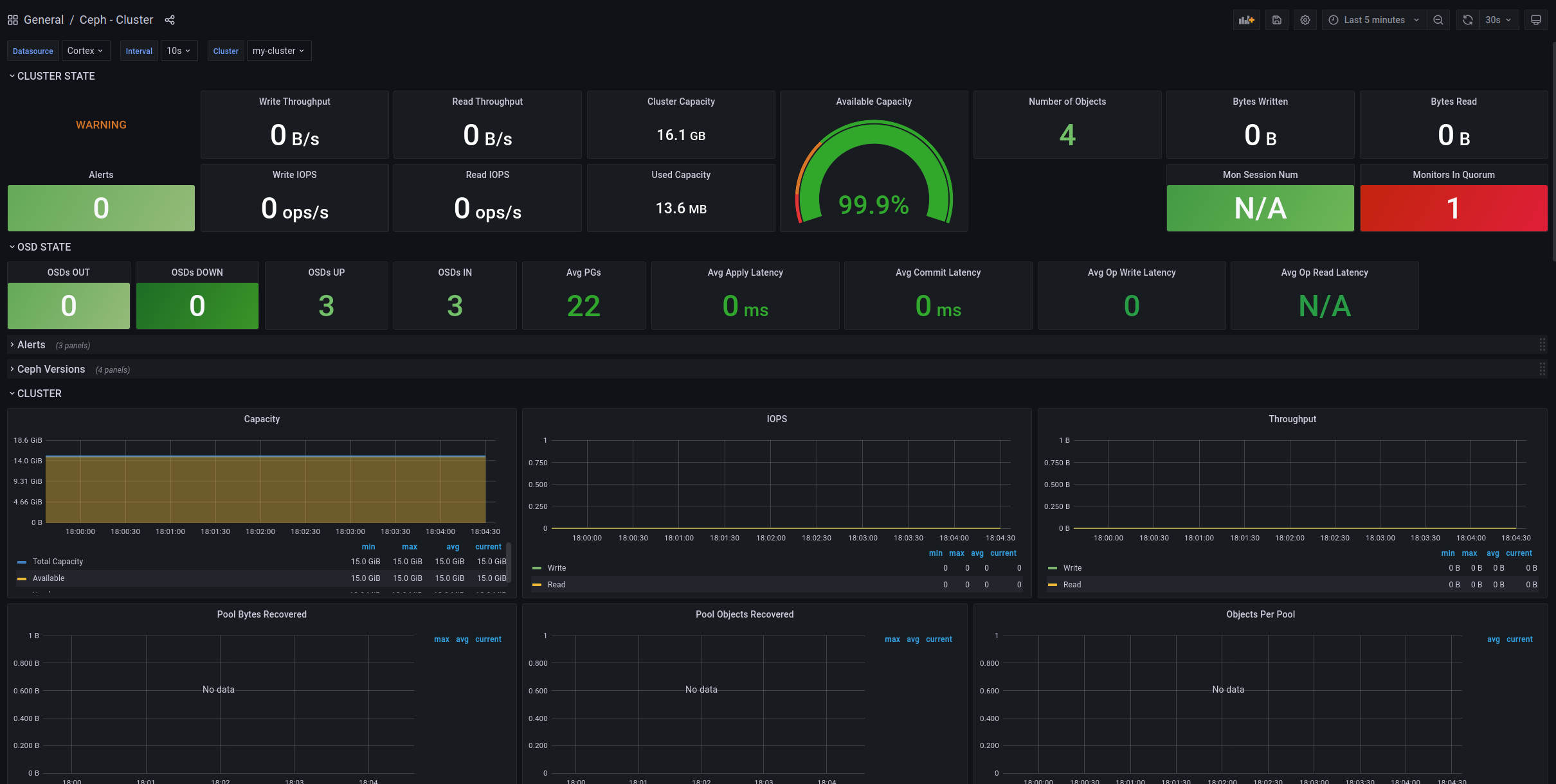

Dashboards
The Ceph integration installs the following dashboards in your Grafana Cloud instance to help monitor your system.
- Ceph - Cluster
Ceph Cluster
