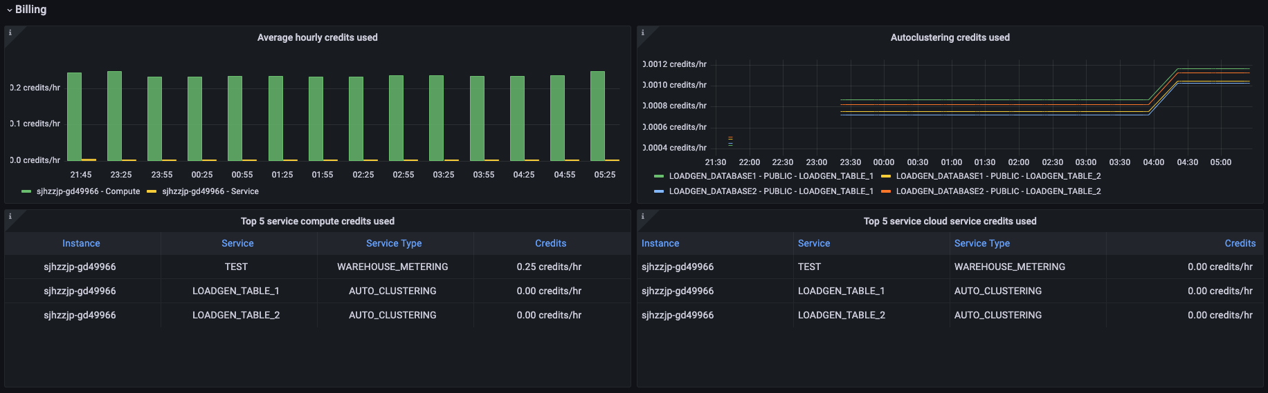

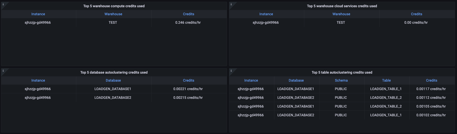

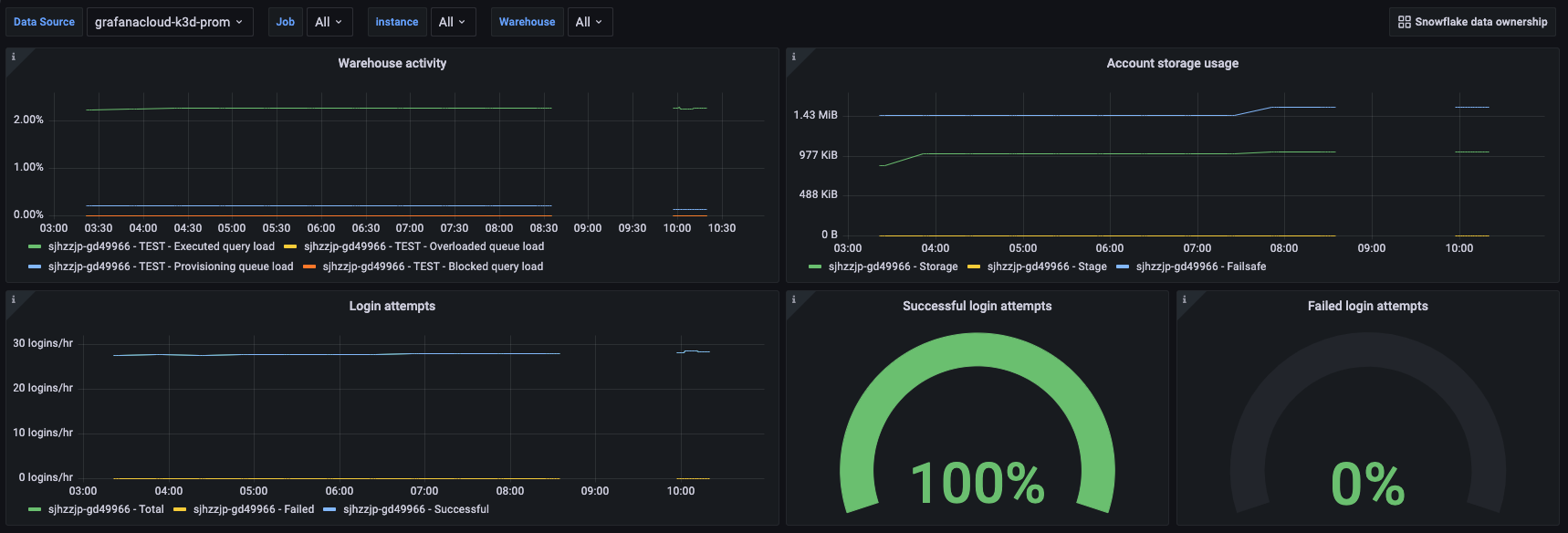

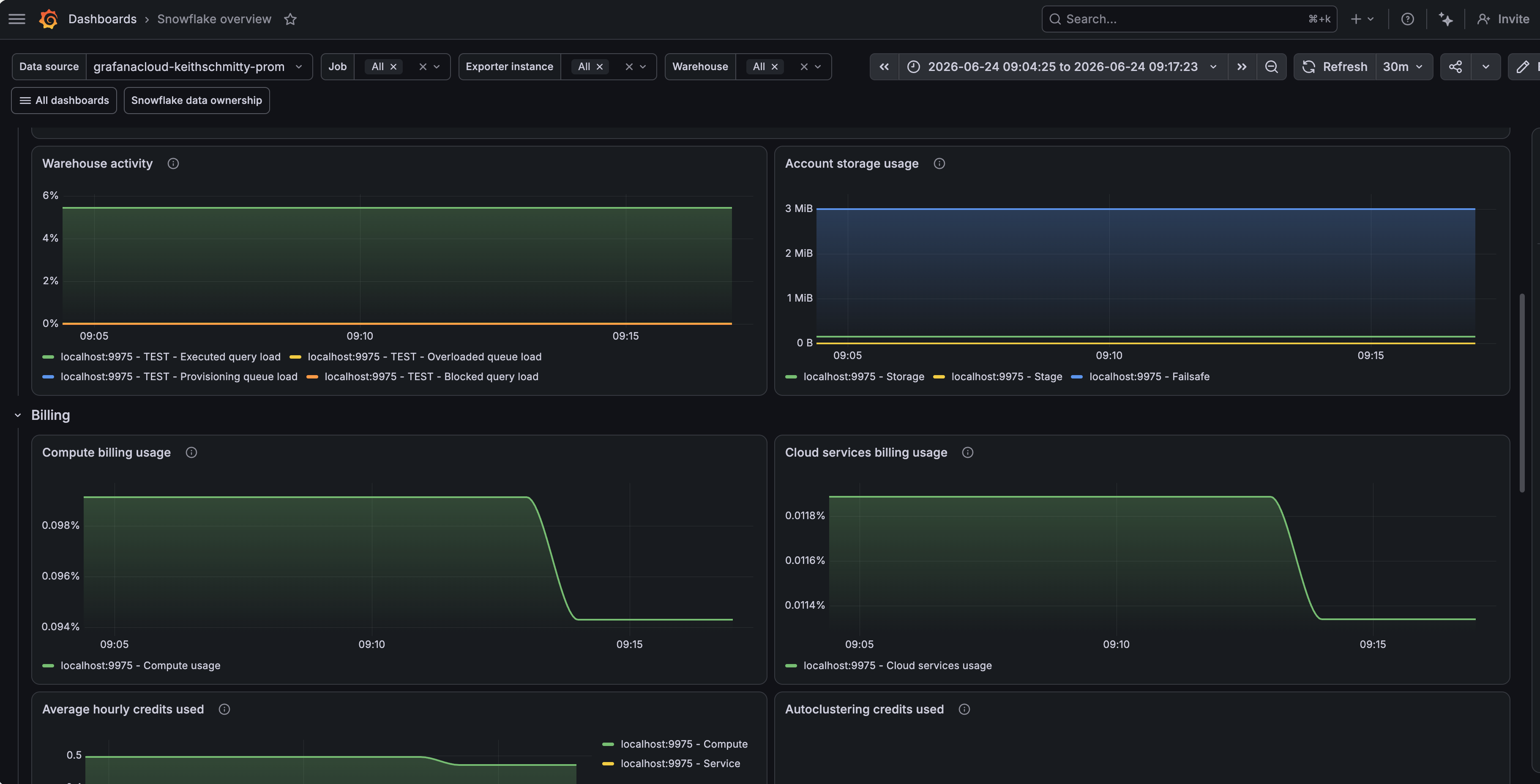

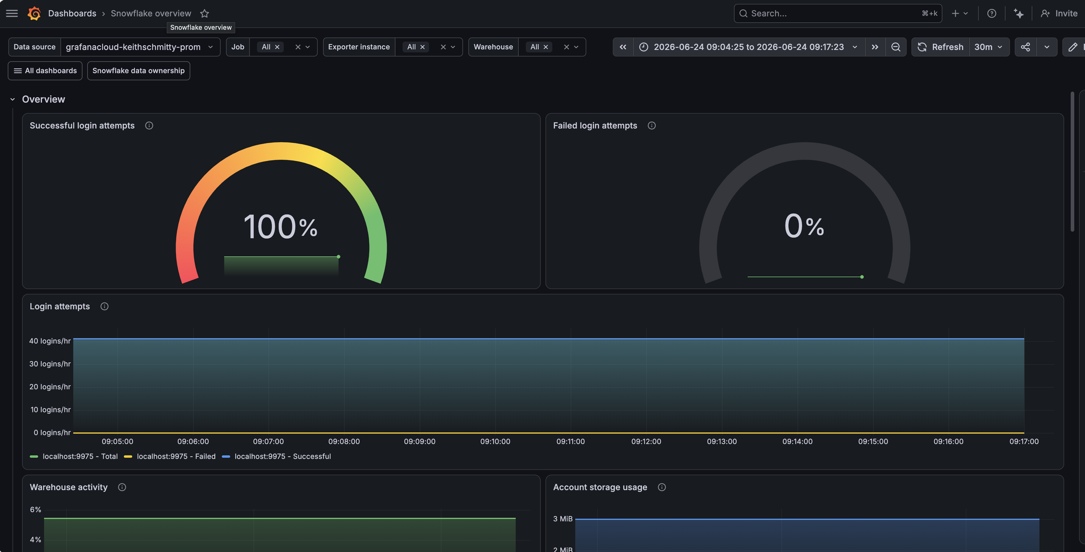

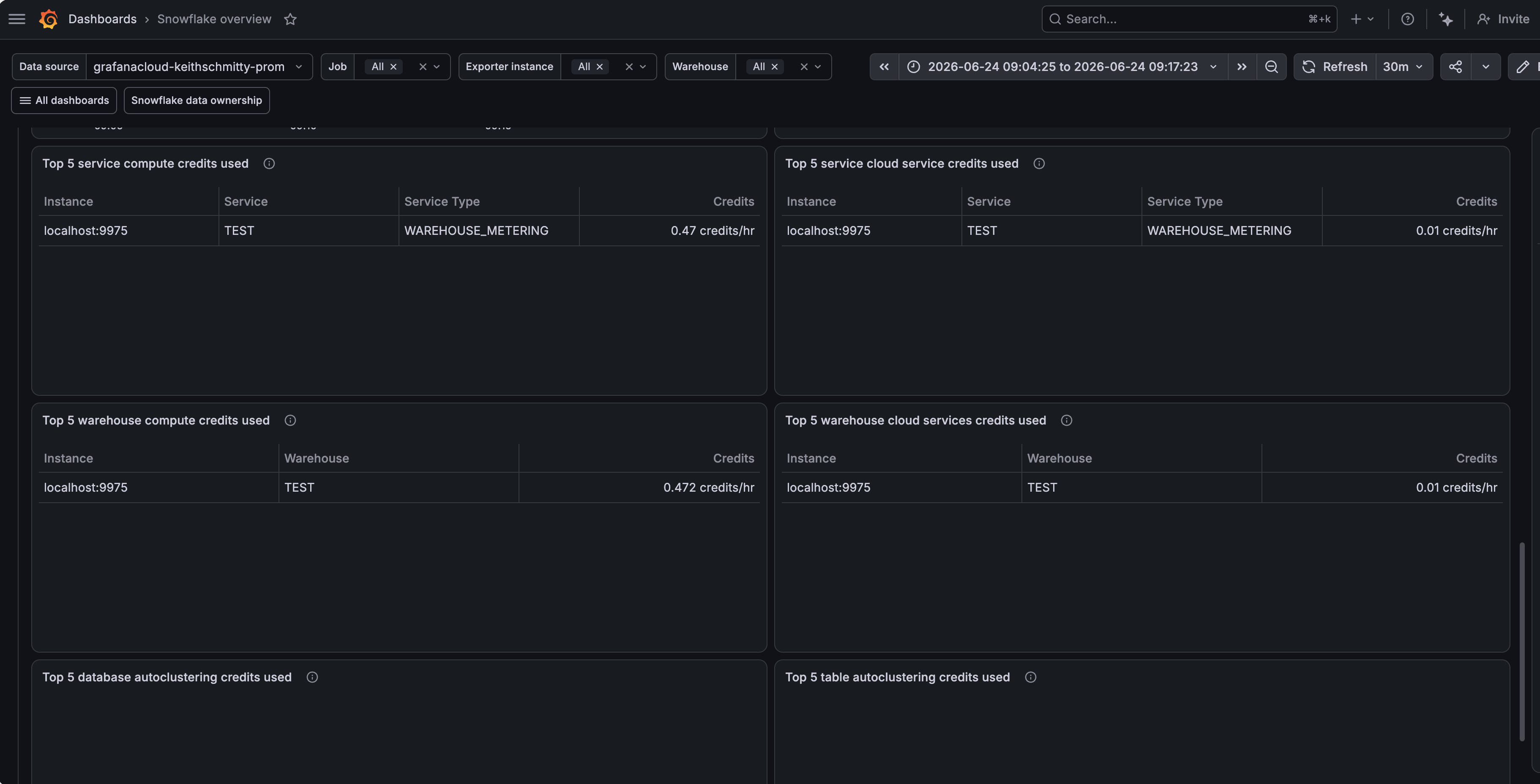

Dashboards
The Snowflake integration installs the following dashboards in your Grafana Cloud instance to help monitor your system.
  • Snowflake data ownership
  • Snowflake overview
Snowflake overview dashboard (1/3).
Snowflake overview dashboard (2/3).
Snowflake overview dashboard (3/3).
