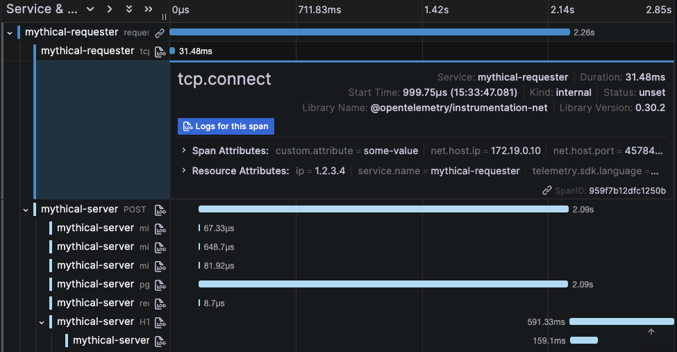

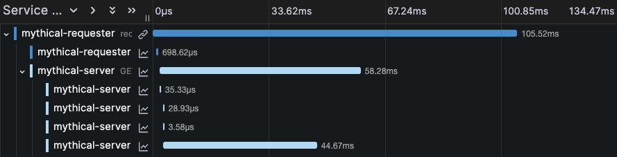

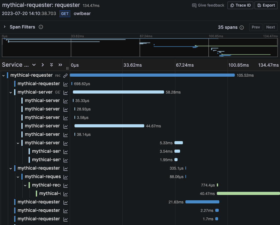

Timeline
Timeline shows list of spans within the trace. Each span row consists of the following components:
  • Expand children - Expands or collapses all the children spans of the selected span.
  • Service name - Name of the service logged the span.
  • Operation name - Name of the operation that this span represents.
  • Span duration bar - Visual representation of the operation duration within the trace.
Click anywhere on the span row to reveal span details.
Trace view timeline
Trace view timeline

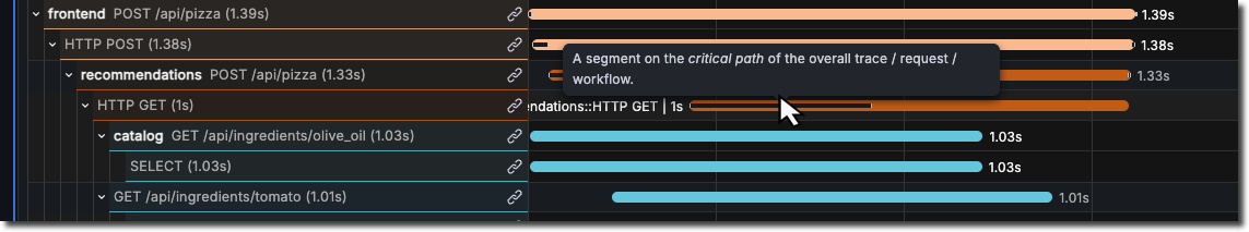

The Span duration bar highlights the trace’s critical path with a darker segment. This darker segment means the span lies on the trace’s critical path, following the CRISP (Critical Path for Service Performance) algorithm.
Use the highlight to focus on spans that drive end‑to‑end latency. Spans outside the critical path do not increase the trace duration.
Critical path span
Critical path span
You can also focus on this path by clicking the Show critical path only button in the Span filters options.
Span details
Traces are composed of one or more spans. A span is a unit of work within a trace that has a start time relative to the beginning of the trace, a duration and an operation name for the unit of work. It usually has a reference to a parent span, unless it’s the first span, the root span, in a trace. It frequently includes key/value attributes that are relevant to the span itself, for example the HTTP method used in the request, as well as other metadata such as the service name, sub-span events, or links to other spans.
You can expand any span in a trace and view the details, including the span and resource attributes.

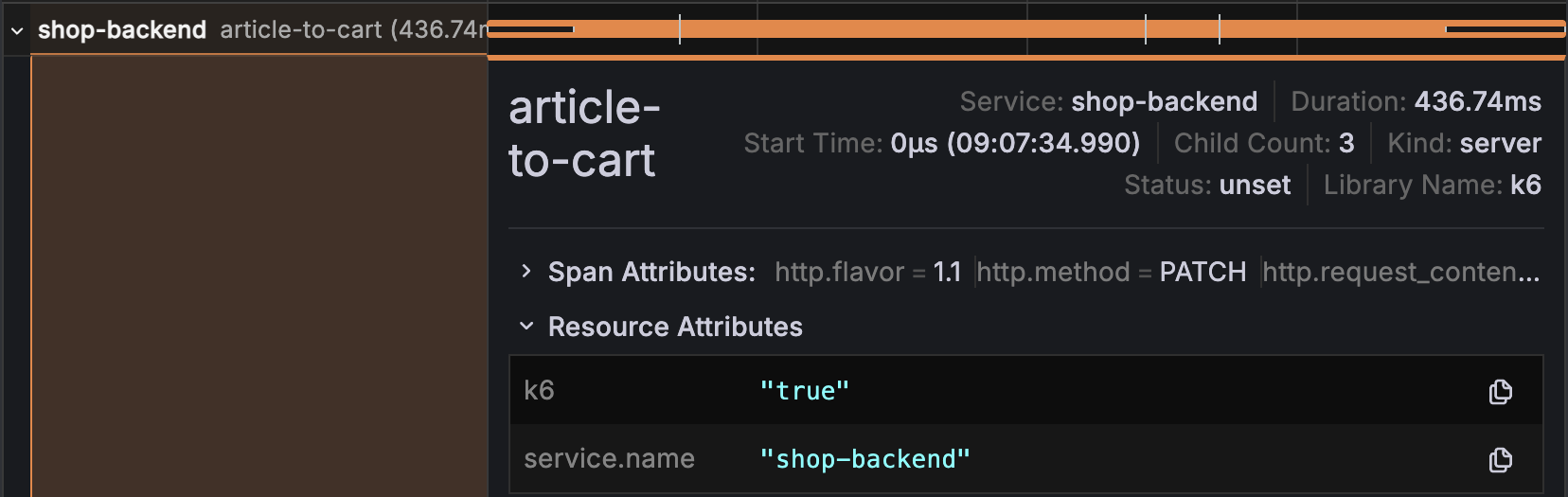

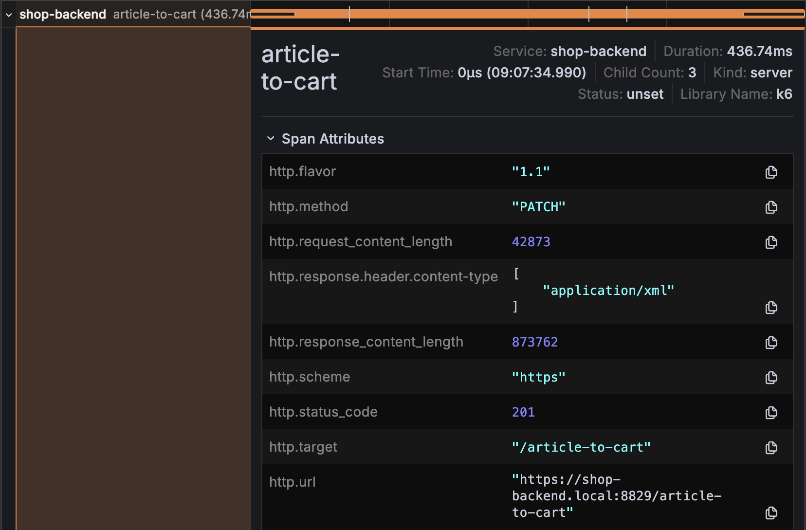

Span and resource attributes
Span attributes are key-value pairs that provide metadata about a specific span. They give context to the operation being performed, such as information about the request, response, or any relevant operational details. For example, if the span deals with calling another service via HTTP, an attribute could include the HTTP URL (maybe as the span attribute key http.url) and the HTTP status code returned (as the span attribute http.status_code).
Trace view span attributes
Resource attributes are key-value pairs that describe the environment or entity that is producing the trace. They capture static information about the origin of traces, like the application name or the service version.
Trace view span resource attributes
Span attributes are specific to a particular operation, while resource attributes are associated with the whole trace or the entire service emitting the spans. Refer to Span and resource attributes for more detail.

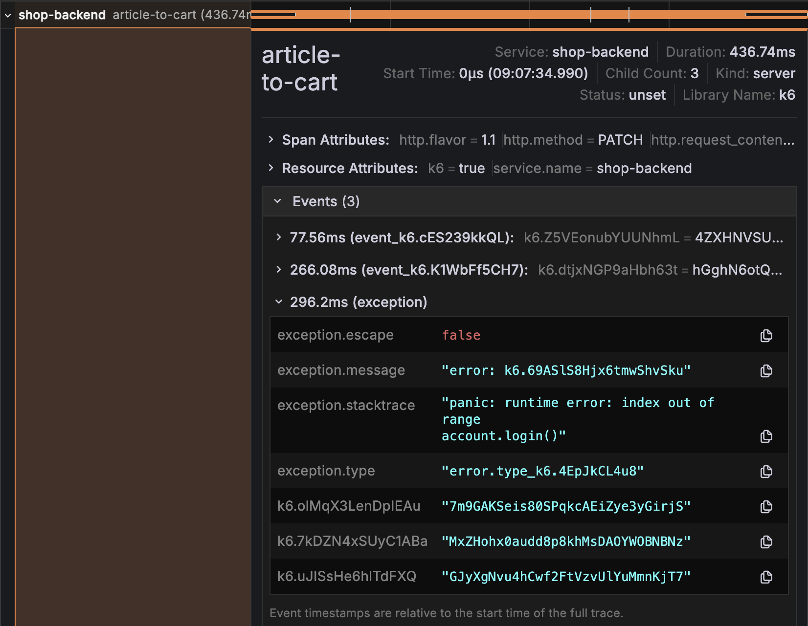

Events
Events are log-like records attached to a span that represent an occurrence during its execution. They record notable moments or occurrences within the span’s lifecycle, such as errors, warnings, or checkpoints. If an error occurs during an operation, an event can be added to the span to indicate what went wrong and when. Events include a timestamp, name, and key-value pairs attributes that provide additional context or details about the event.
Trace view span events

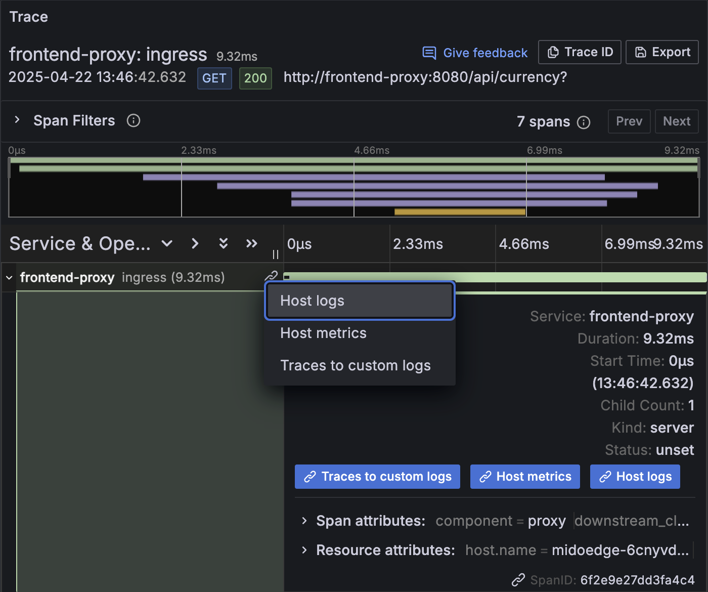

Trace to logs
You can navigate from a span in a trace view directly to logs relevant for that span. This feature is available for the Tempo, Jaeger, and Zipkin data sources. Refer to each individual data source’s documentation for configuration instructions.
Click the document icon to open a split view in Explore with the configured data source and query relevant logs for the span.
Trace to logs
Trace to logs

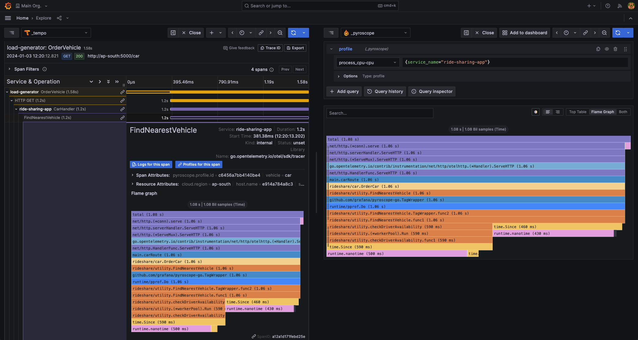

Trace to profiles
Using Trace to profiles, you can use Grafana’s ability to correlate different signals by adding the functionality to link between traces and profiles.
For Tempo, refer to Trace to profiles for configuration instructions.
Selecting a link in the span queries the profile data source

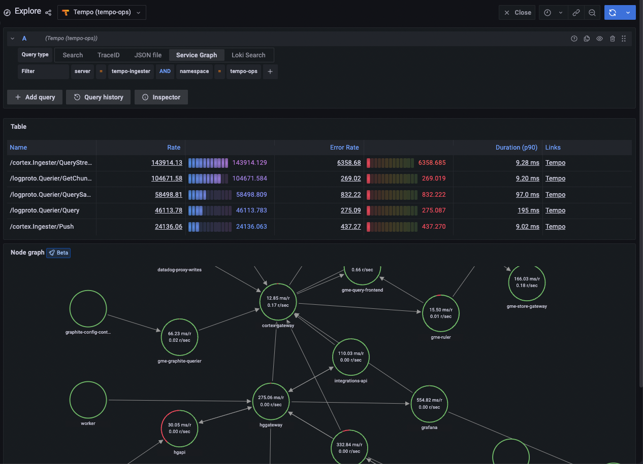

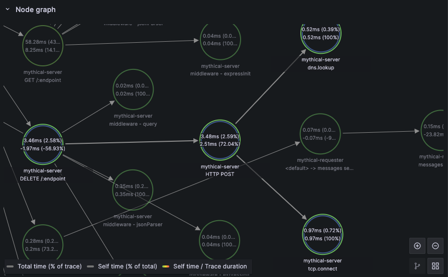

Node graph
You can also expand the node graph for a displayed trace. If the data source supports it, this displays spans of the trace as nodes in the graph, or provides additional context, such as a service graph based on the current trace.
Refer to Node graph for additional information.
Note
The node graph requires data to be returned from the data source in a specific format to display correctly. Refer to Data API, Nodes data frame structure and Node graph data requirements for additional information and configuration instructions.
Node graph
Node graph
Service graph
A service graph visualizes rates, error rates, and durations (RED), along with service relationships. After the requirements are configured, this pre-configured view is immediately available.
For additional information refer to the following documentation:
