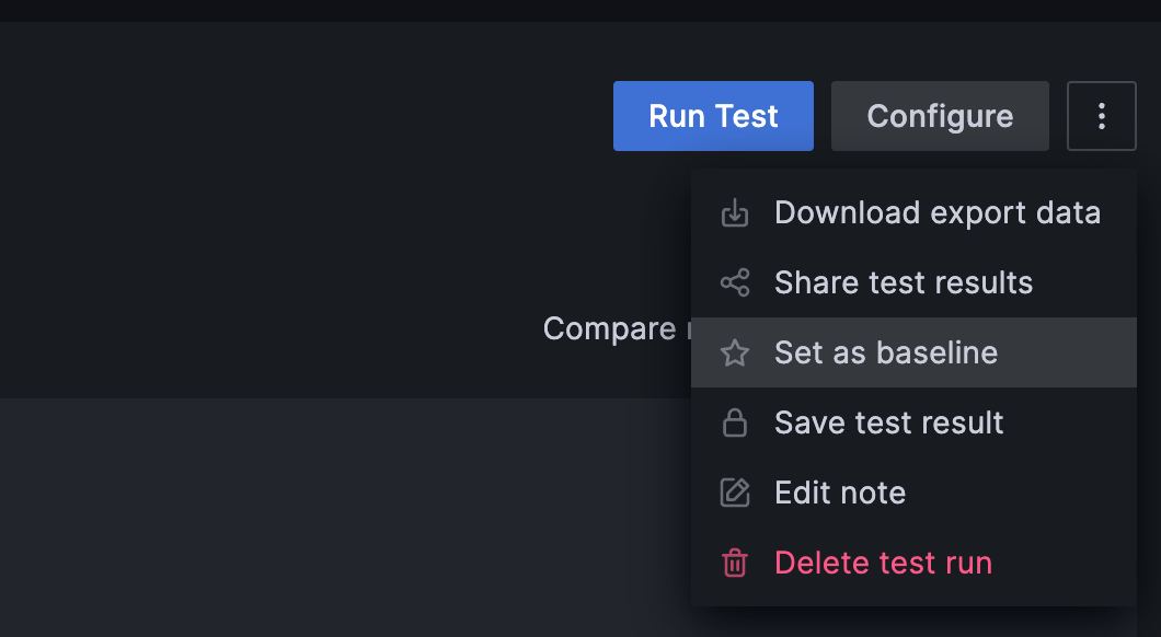

To star a test run, follow these steps:
  1. Open the test run page you want to star.
  2. Click the star icon next to the test run name.
Alternatively, use the three-dot icon in the top-right corner of your test run and select Add to starred.
Starring a test run marks it for comparison. It doesn’t change how long the run’s data is retained. Starred test runs follow the same data retention policy as your Grafana Cloud Metrics data.

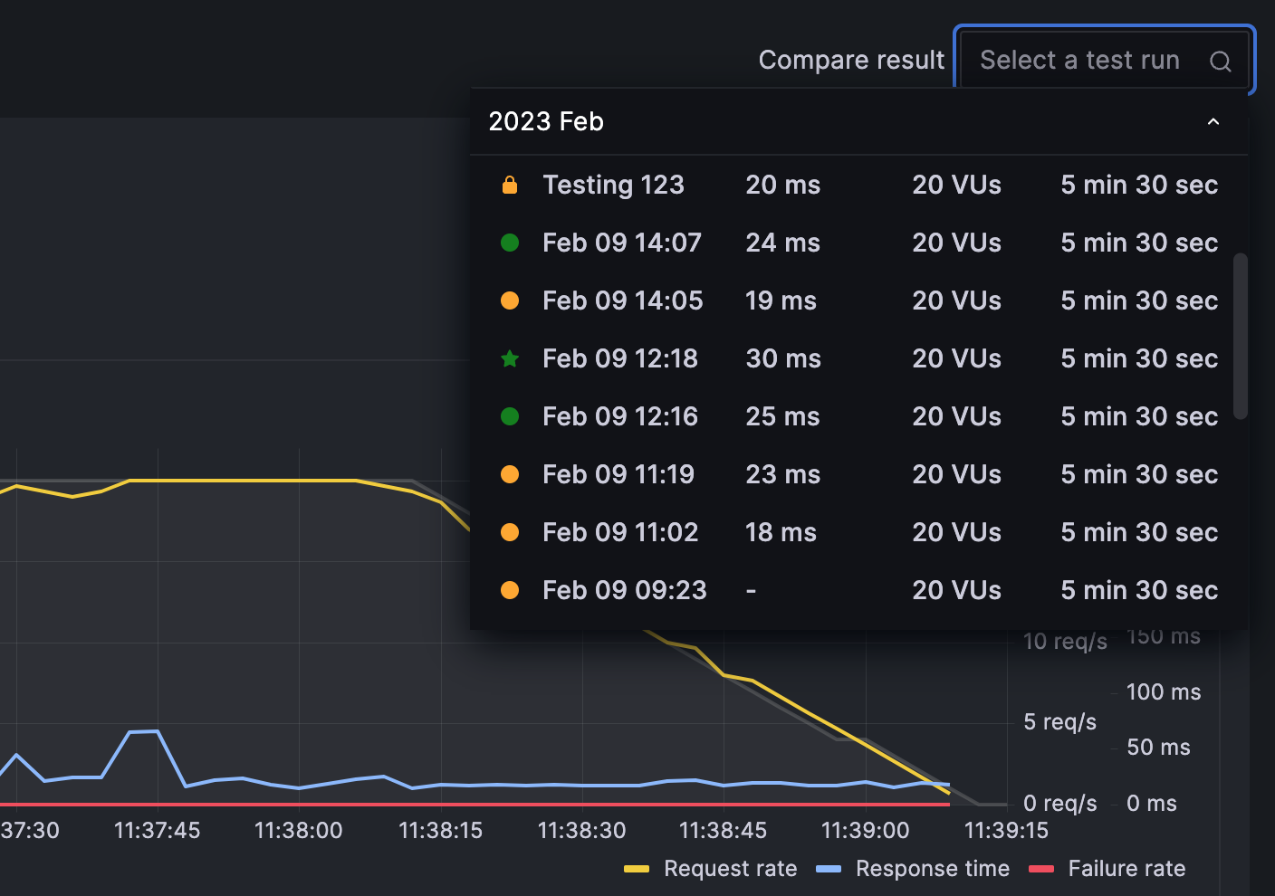

To compare two test runs, follow these steps:
  1. Open a test run
  2. In the upper-right corner, next to Compare with, click Select a test run
  3. Select the test run you want to compare the test to
Starred test runs appear at the top of the dropdown, grouped under Starred, so you can find them quickly.

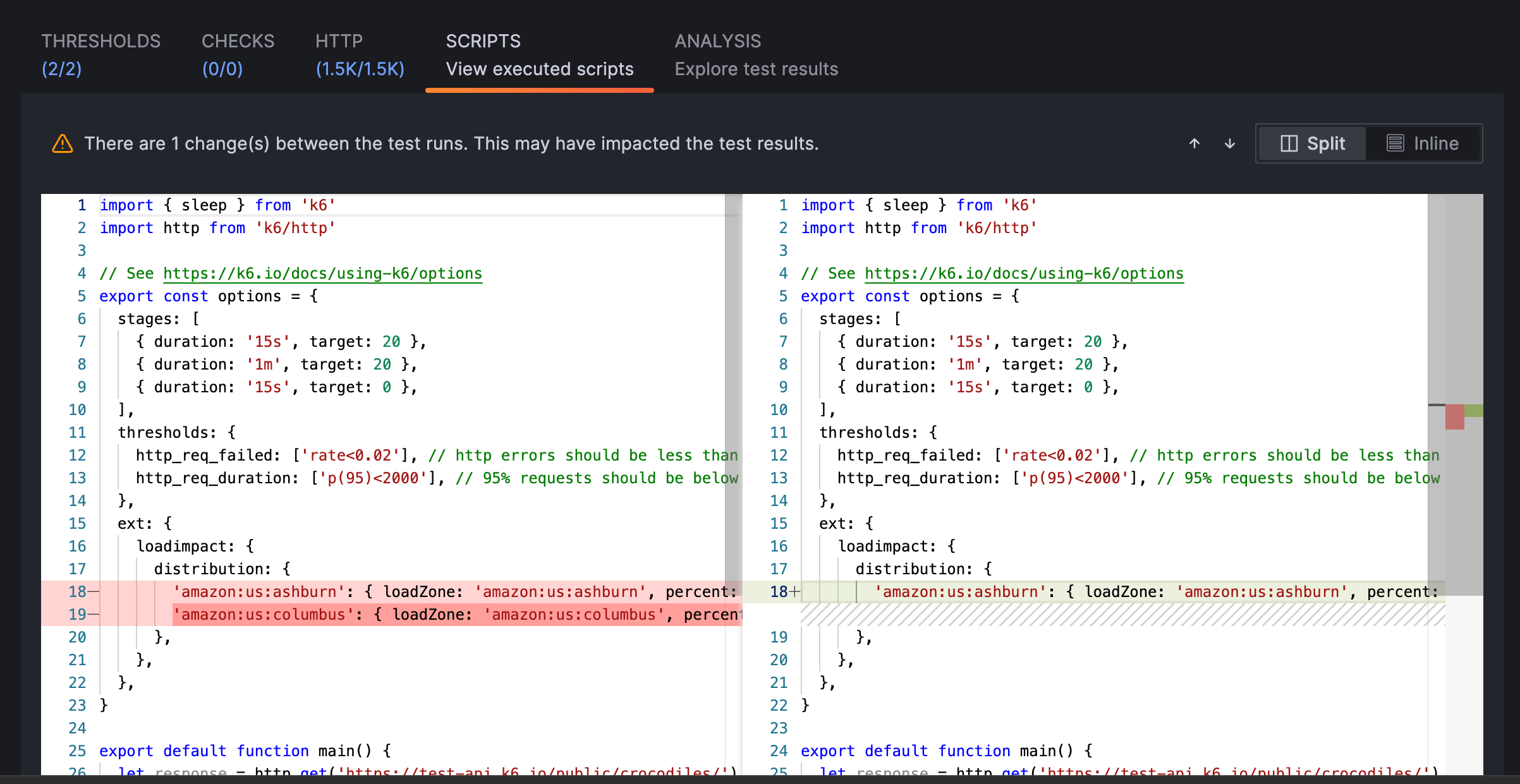

Compare scripts
To compare scripts, use the Scripts tab. You can view the scripts for each test run in the read-only editor mode.
At the top of the tab, you can:
  • See the total number of changes between the test runs.
  • Click the up and down arrows to navigate on the editor to the next/previous script change.
  • Select a Split or Inline view mode
The editor works similarly to other code editors, highlighting any lines that were updated, added, or removed.
Compare scripts to see whether modifications to your test script caused differences in the test results, similar to comparing other types of test data like checks or thresholds. As your test scripts evolve over time, it can be helpful to create a new test whenever significant alterations are made, as this lets you more accurately evaluate the performance of your systems.

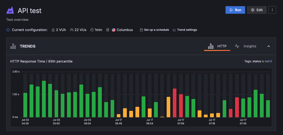

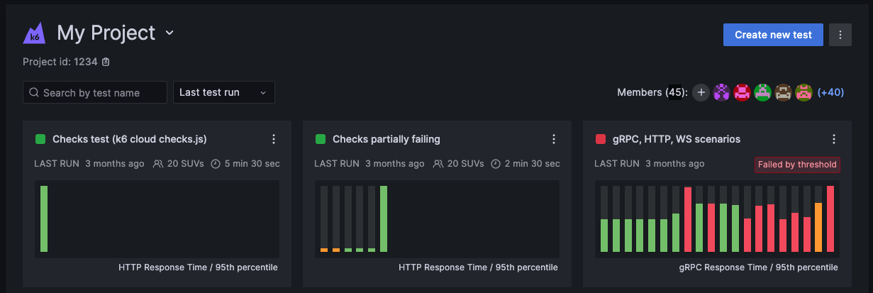

To compare runs for a test across time, use the performance-trending chart. The chart displays test-run metrics, using colors to signal the status of a specific run.
To view the performance-trending chart for multiple tests that belong to the same project, open the Project page:
Screenshot of the Project page showing the performance-trending chart for multiple tests

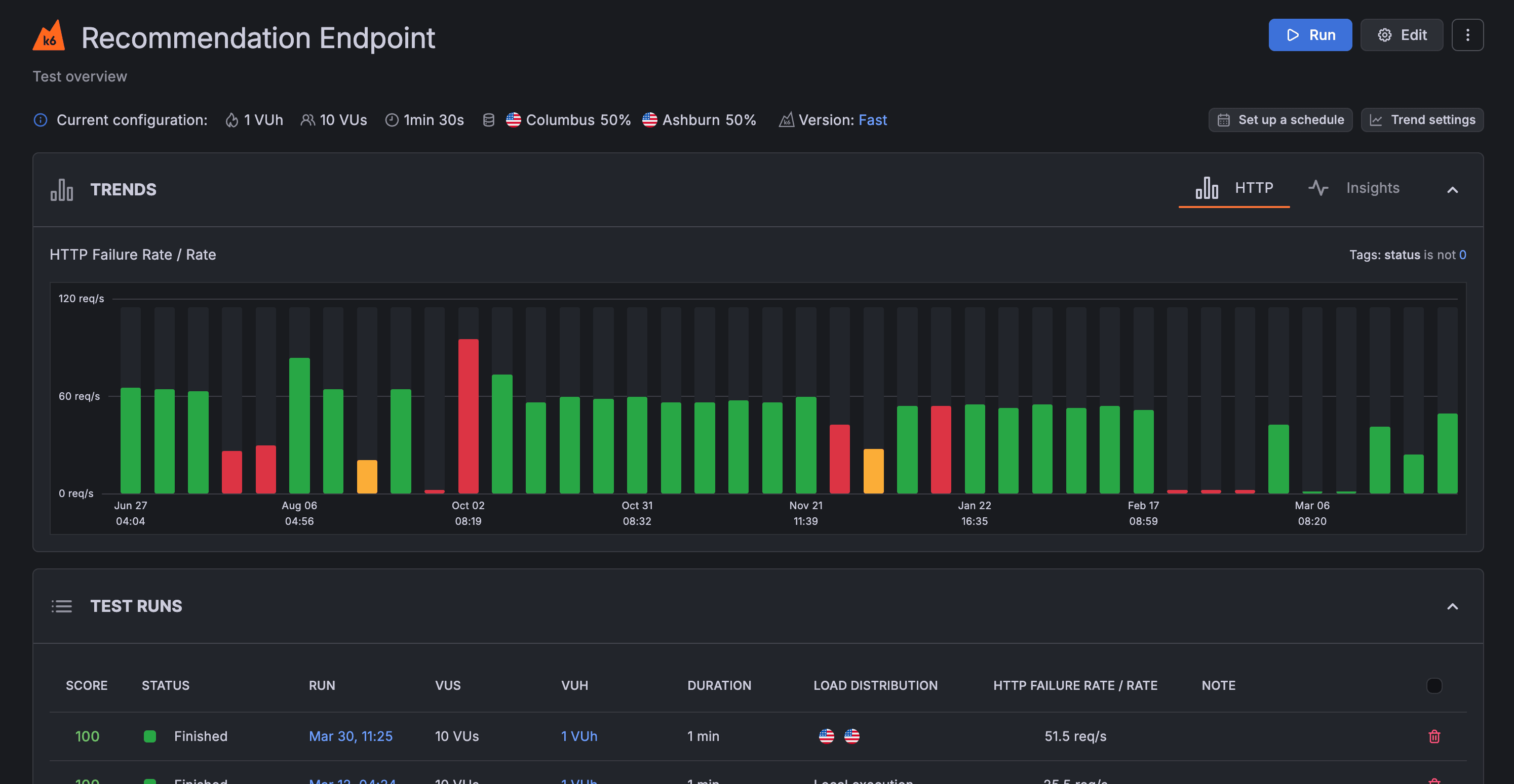

To view the performance-trending chart for an individual test, open the test’s page:
Screenshot of an individual test page showing detailed performance-trending data over time
This last chart shows more data points over time. For more information about an individual run, hover over any bar in the chart.
By default, the data displayed in the performance-trending chart is the p95 of the HTTP response time (http_req_time).
The chart displays a summary trending metric, an aggregated value for all metric data points in the test run. k6 produces a single value for each test run using the trending metric, and then plots each value the chart. You can customize the trending metric on a per-test basis.

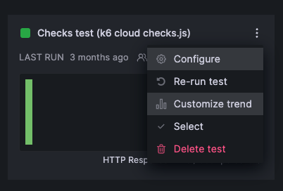

To customize the trending metric used for a test:
  1. Navigate to the Project page
  2. In the top-right corner of the test’s performance-trending chart, click the menu icon (three dots)
  3. Select Customize trend

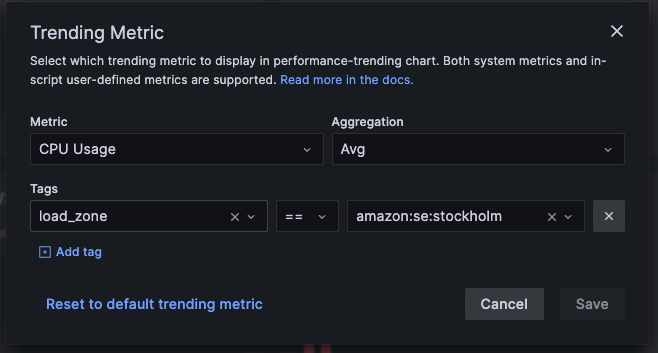

This opens a window where you can:
  • Select the metric to use in the performance-trending chart. The list includes both standard metrics (created by all k6 test runs) and custom metrics (user-defined).
  • Select the aggregation function to apply to the metric. In this case, “Avg” (Average) is selected.
  • Select or add one or more sets of tags and tag values. In this case, you can select values only from instances in the amazon:se:stockholm load zone.
After you select the desired parameters, click Save to apply the changes.
To reset the configuration, use the default trending metric with Reset to default trending metric button in the bottom left corner.
k6 calculates the required values, then plots them in the performance-trending chart.
