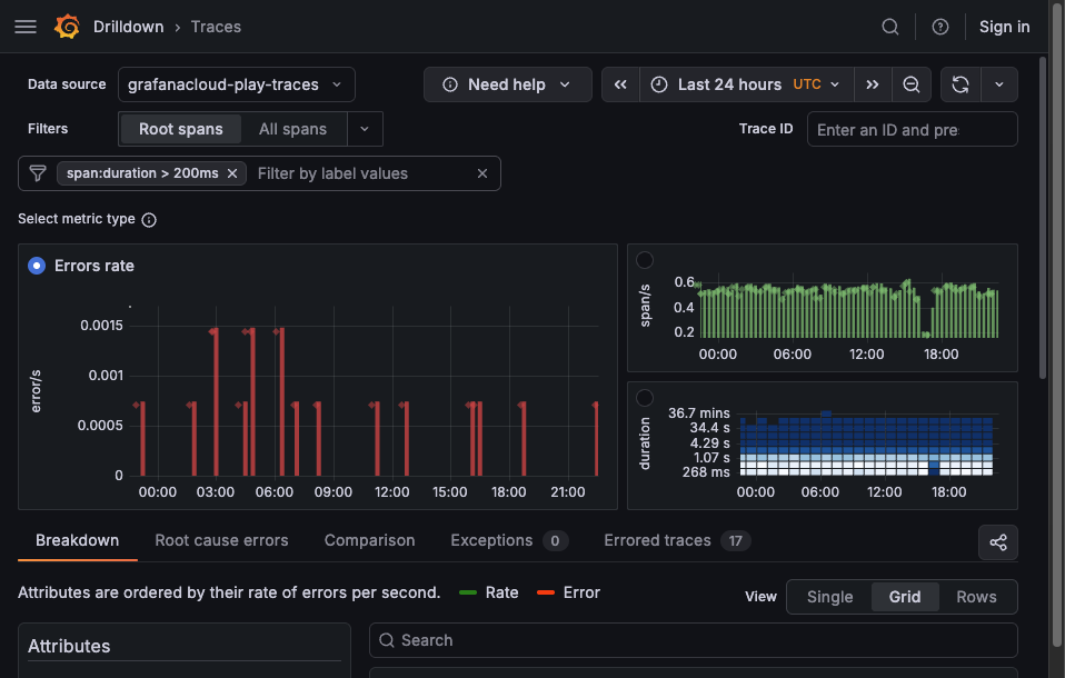

Let’s say that you want to investigate a spike in root spans with errors that are longer than 200ms.
- Select Root spans.
- Select the Errored traces tab.
- In Filter by label values, enter
span:duration, select greater than (>) from the drop-down list, and then enter200ms. - After the data updates, sort the table by the Duration column.
