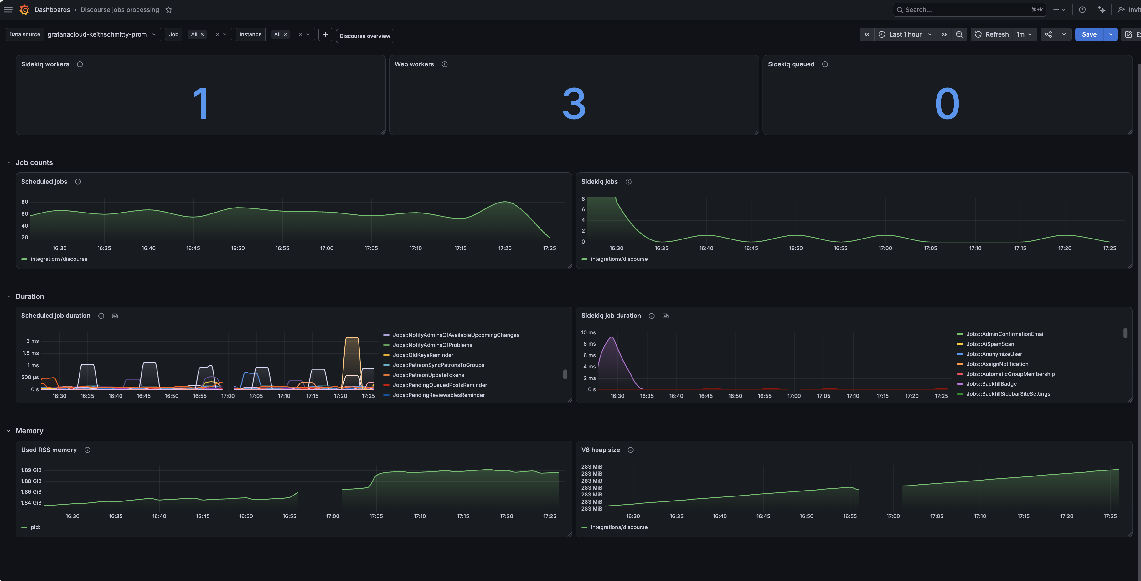

- Discourse jobs processing

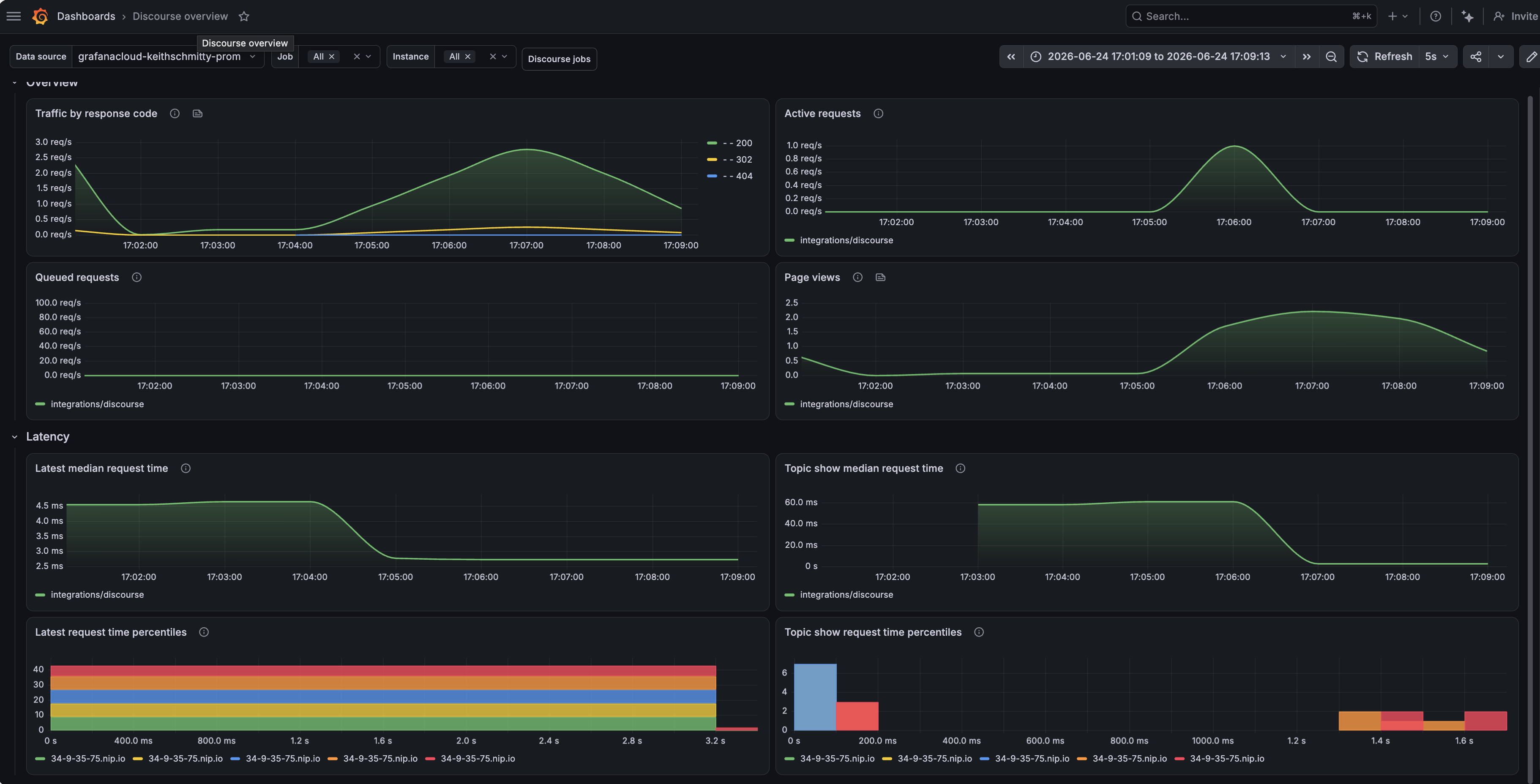

- Discourse overview

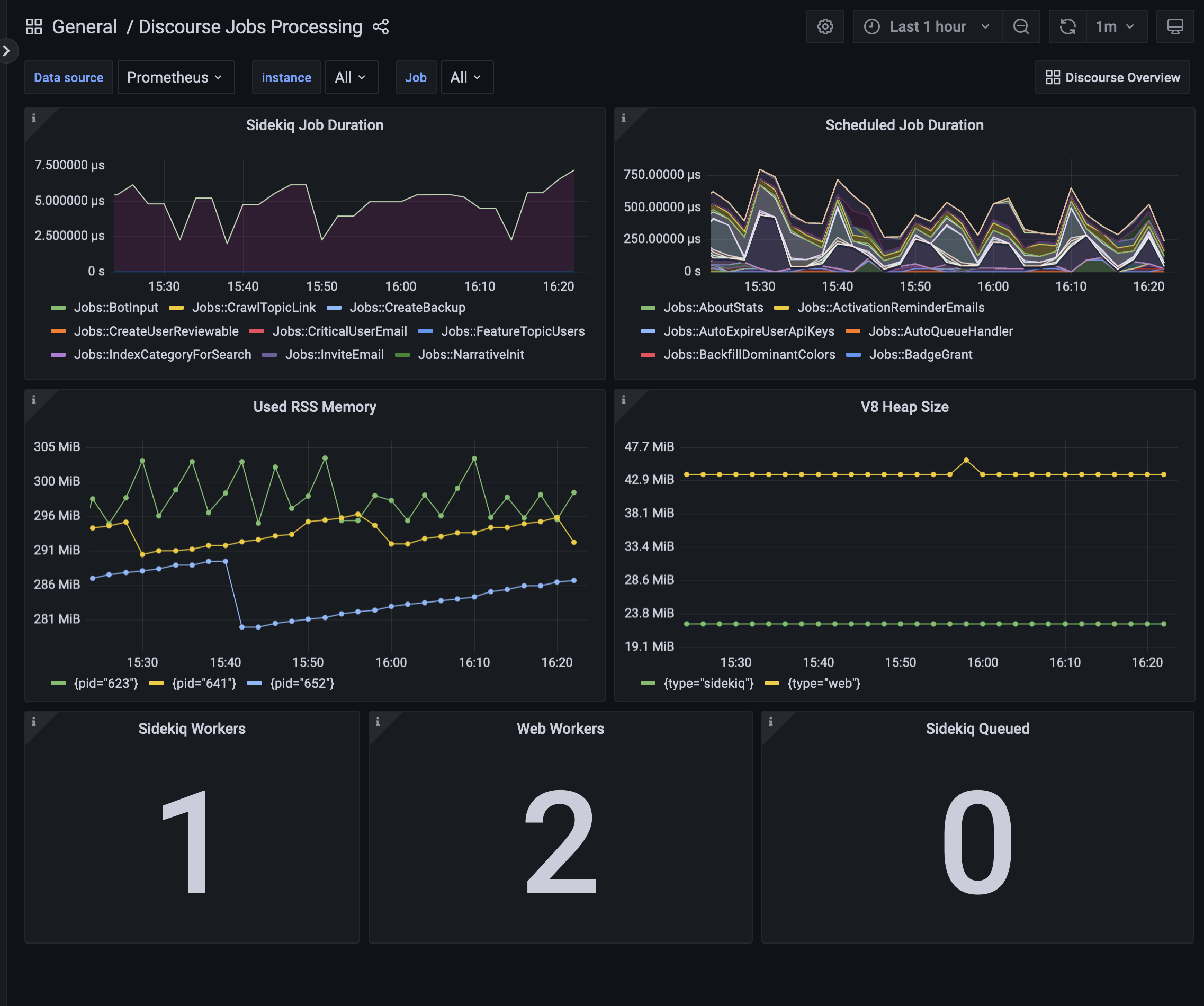

Discourse Jobs Dashboard

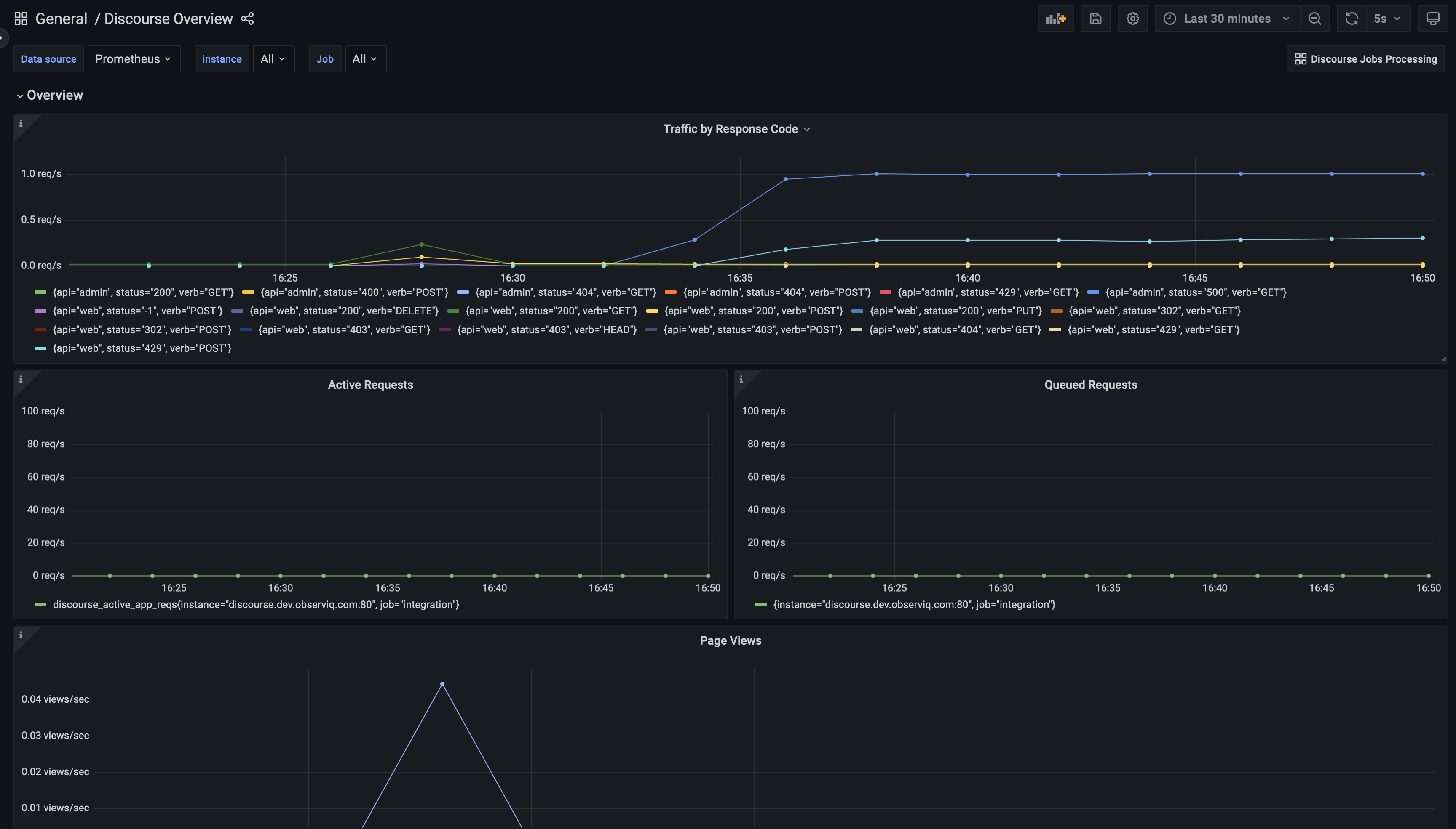

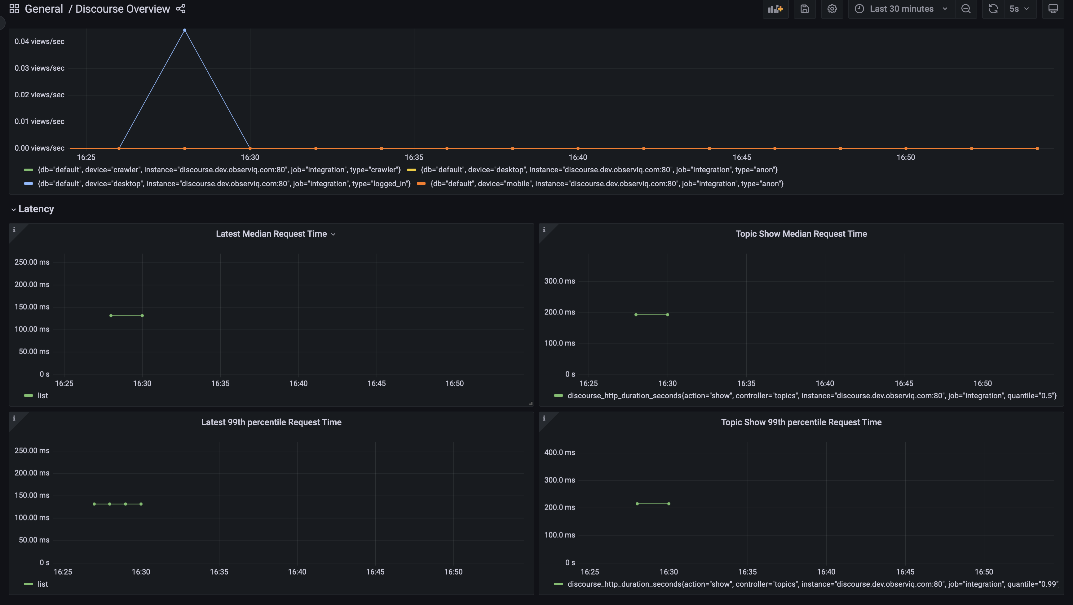

Discourse Overview Dashboard
