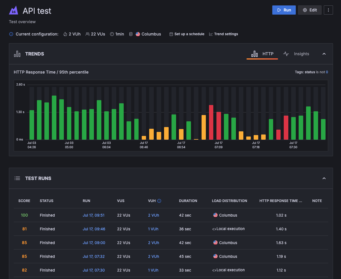

Navigate to the Test Result view
There are two ways to navigate to the Test Result view. From the project view:
- Select the test that want to view its test run results.
- On the Test view, select the test run from the Test Runs table.

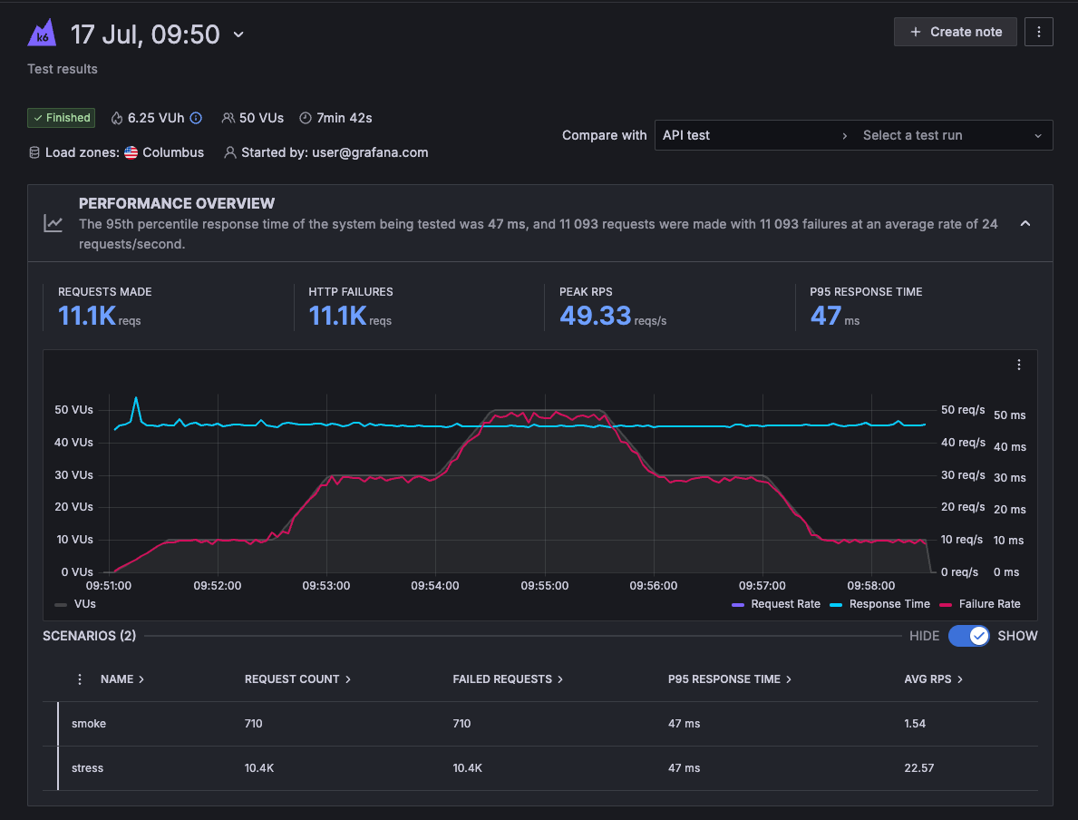

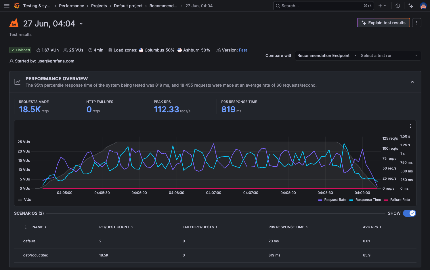

Performance overview
The Performance Overview section displays high-level data for your test. While the test runs, it displays live metrics.
Indicators of good and bad results
The first sign of a good or bad result is usually in the Performance Overview panel.
Typical signs of a good result:
- Response time has a flat trend for the duration of the test.
- Request rates follow the same ramping pattern as Virtual Users (if VUs increase, so does the request rate).
Typical signs of a performance issue or bottleneck:
- Response times increase during the test.
- Response times increase, then quickly bottom out and stay flat.
- Request rates don’t increase with VUs (and response times start to increase).
This is a non-exhaustive list. You should use these patterns as a first indicator of good or bad performance of your test.

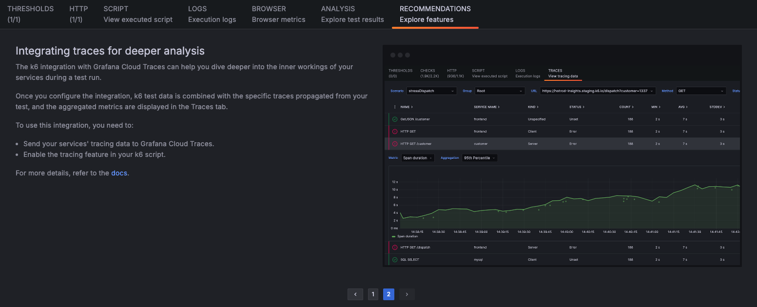

Recommendations
The Recommendations tab is an intelligent tool that analyzes telemetry data, such as metrics, logs, and traces, to provide tailored best practices to help you get the most out of Grafana Cloud k6. For example, it might suggest:
- Using Grafana Cloud products like Synthetic Monitoring
- Exploring Grafana Cloud k6 features such as Private Load Zones
- Correlating Results with Grafana Cloud Traces
You can find the Recommendations tab on the Test run results page.
