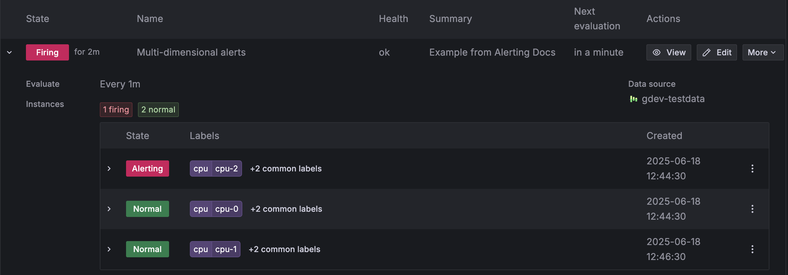

Each alert rule can generate one or more alert instances—one alert instance for each series or dimension, as shown in the multi-dimensional alert example.
Each alert instance of the same alert rule represents a different target and can be in a different state; for example, one alert instance may be Normal while another is Alerting.
The alert rule state and alert rule health are determined by the state of the alert instances.
