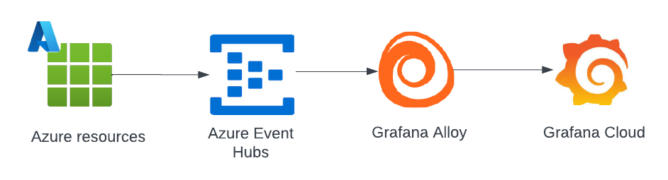

Azure Monitor streams log data from configured sources to an Event Hubs namespace that has been created with a Kafka endpoint. Grafana Alloy pulls the data from the Event Hubs namespace and sends it to Grafana Cloud.
The following diagram illustrates how Grafana Alloy pulls data from the Event Hubs namespace and sends it to Grafana Cloud:
