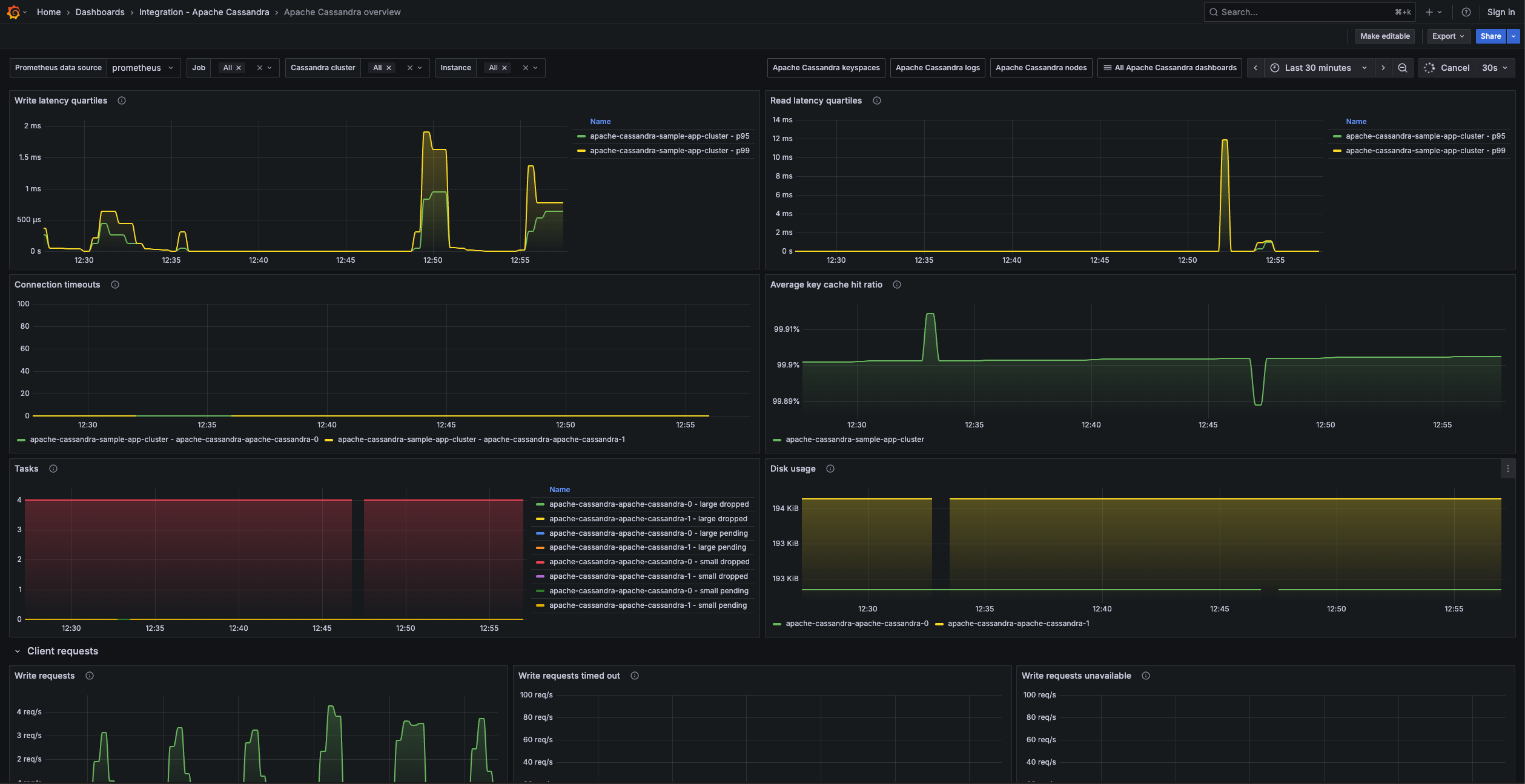

Apache Cassandra overview 1

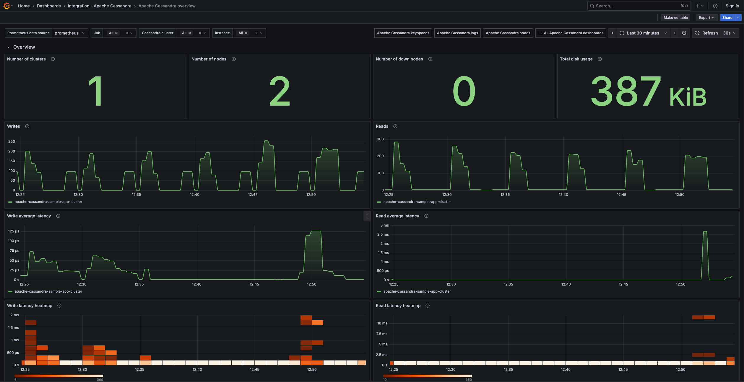

Apache Cassandra overview 2

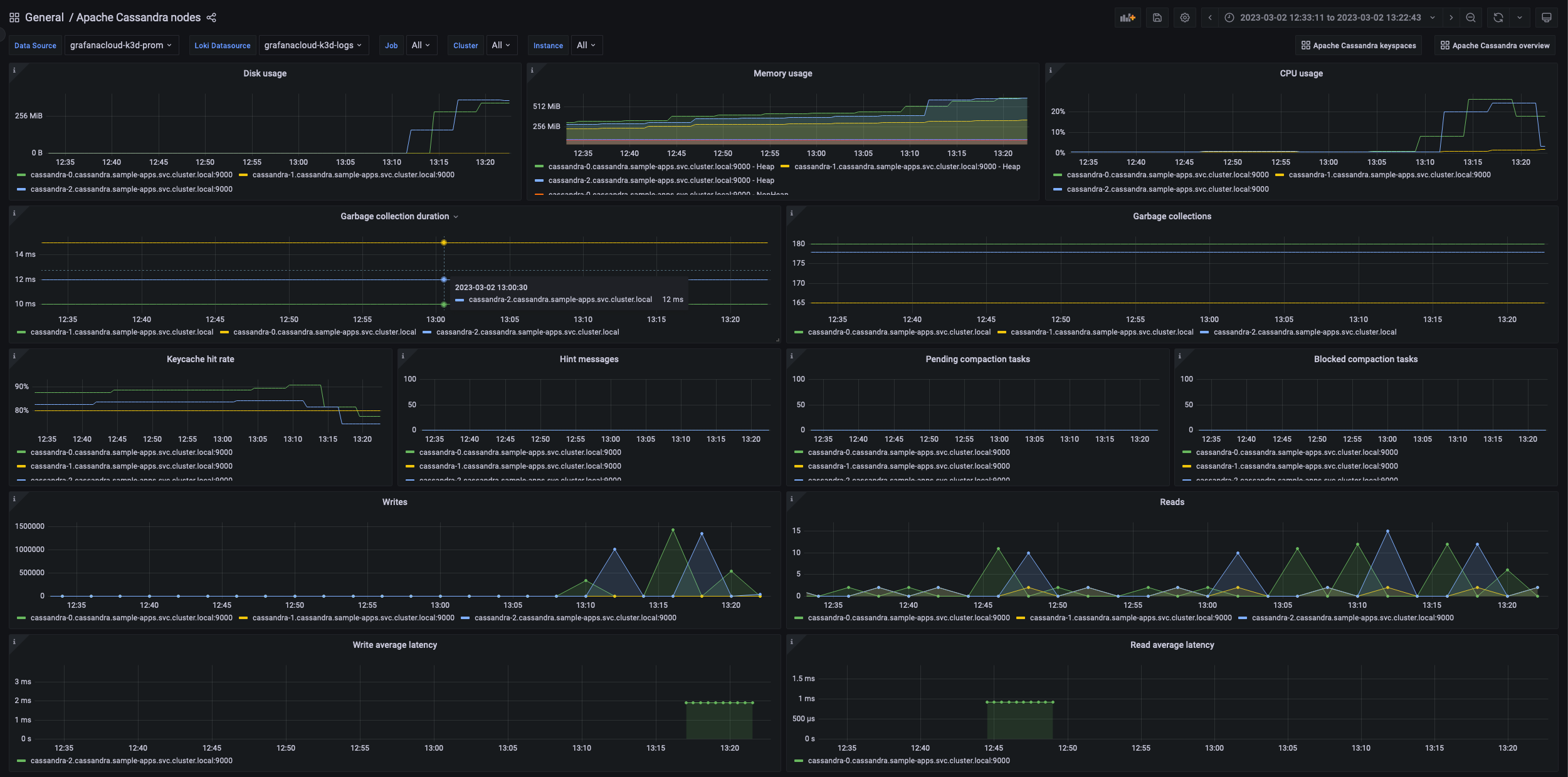

Apache Cassandra nodes 1
