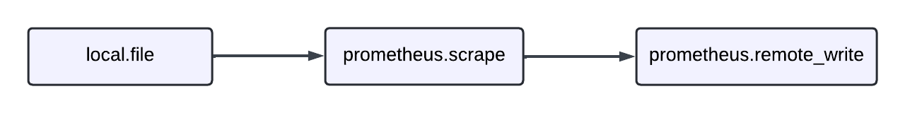

In the preceding example, you wired together a very simple pipeline by writing a few Alloy expressions.
Example of a pipeline
