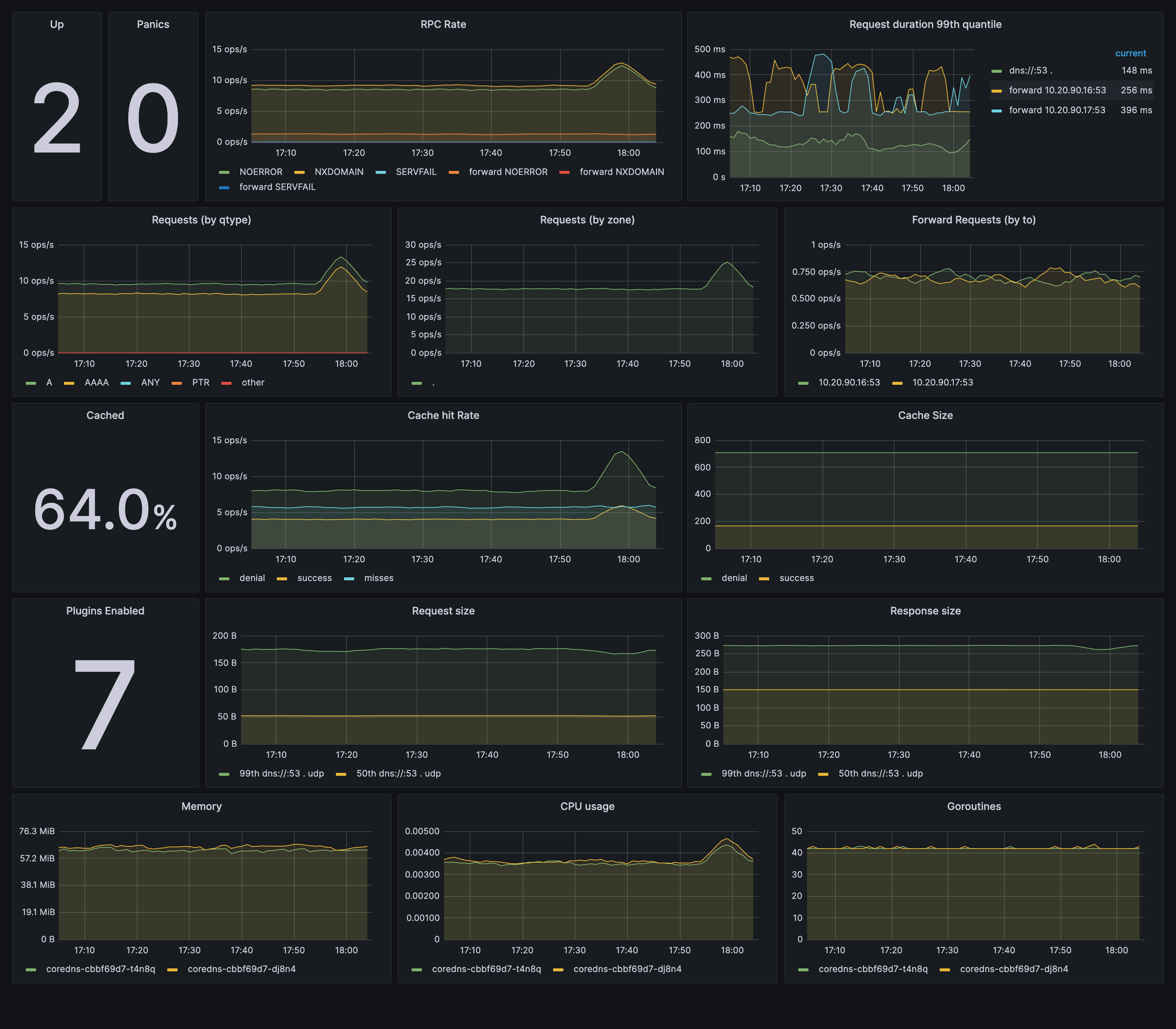

The CoreDNS integration installs the following dashboards in your Grafana Cloud instance to help monitor your system.
- CoreDNS
CoreDNS dashboard
