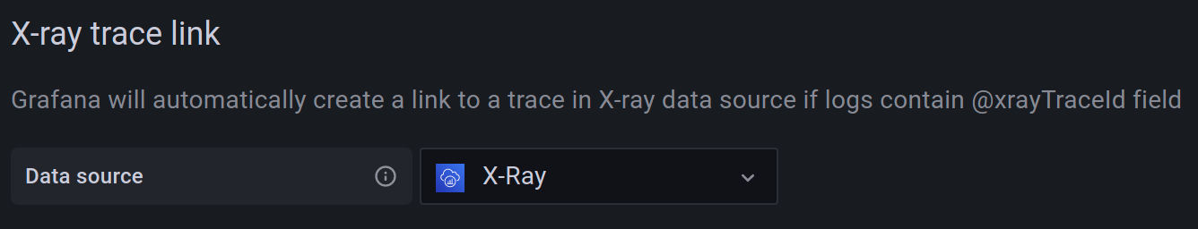

X-Ray trace links
To automatically add links in your logs when the log contains the @xrayTraceId
field, link an X-Ray data source in the “X-Ray trace link” section of the data source configuration.
The data source select contains only existing data source instances of type X-Ray. To use this feature, you must already have an X-Ray data source configured. For details, see the X-Ray data source docs.

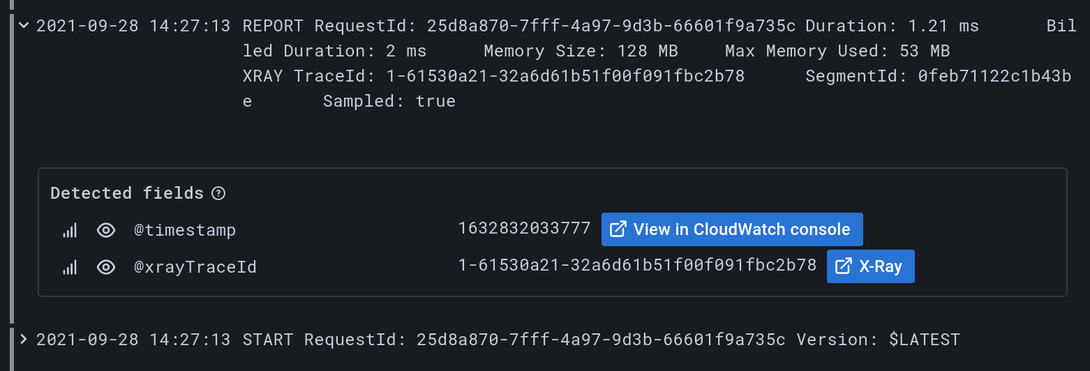

To view the X-Ray link, select the log row in either the Explore view or dashboard Logs panel to view the log details section.
To log the @xrayTraceId
, see the AWS X-Ray documentation.
To provide the field to Grafana, your log queries must also contain the @xrayTraceId
field, for example by using the query fields @message, @xrayTraceId
