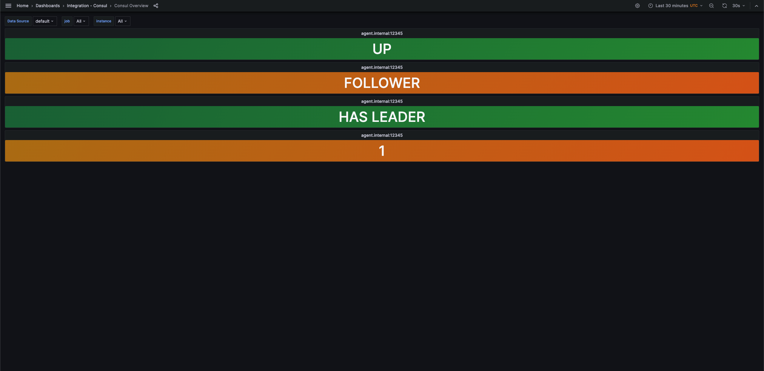

Dashboards
The Consul integration installs the following dashboards in your Grafana Cloud instance to help monitor your system.
  • Consul Overview
Consul Overview
Consul Overview
