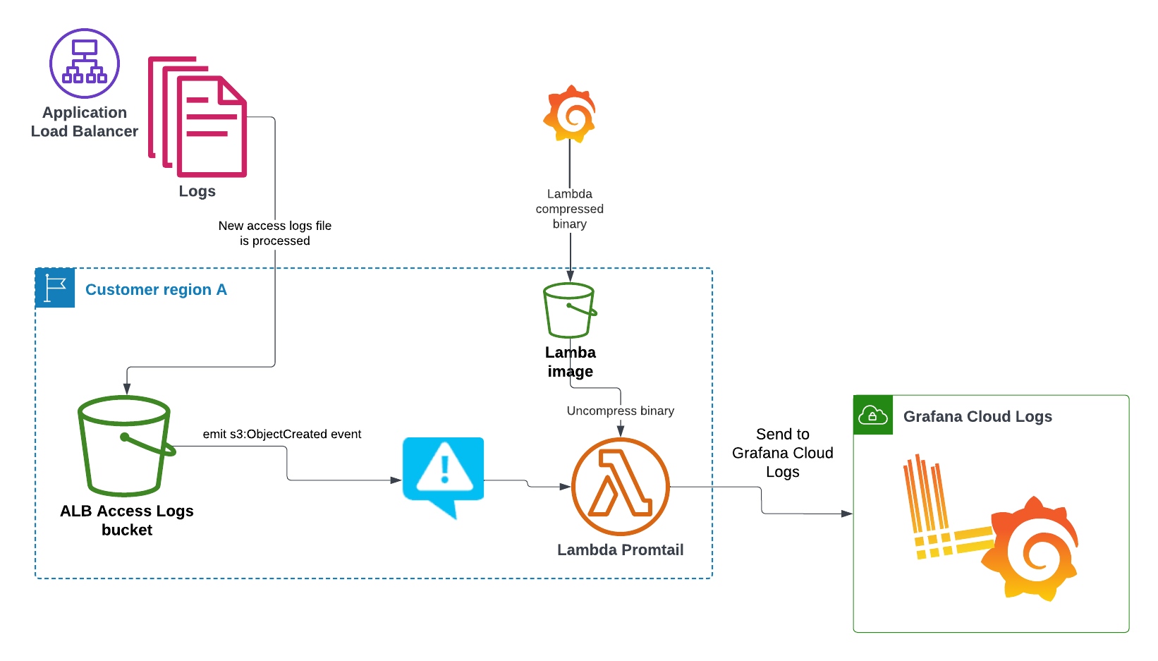

Send Application Load Balancer access logs to Grafana Cloud Logs using a Lambda function.
Whether you configure with CloudFormation or Terraform, the following diagram shows the components required and how the process works:
ALB logs processing and sending

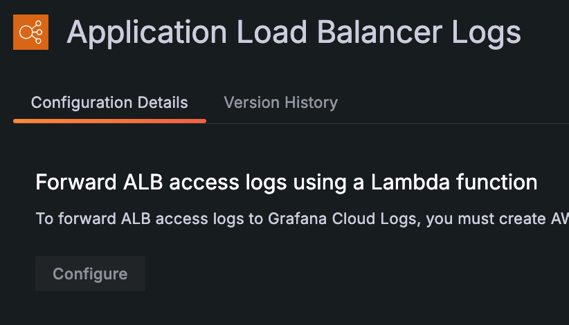

  5. On the Application Load Balancer Logs page, click Configure.
    **Configure** button
    Configure button
