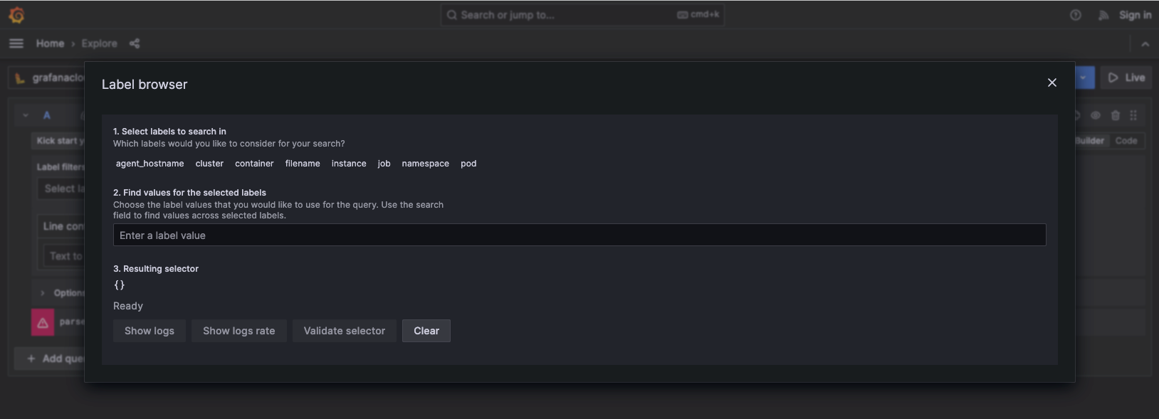

Label browser
You can use the Loki label browser to navigate through your labels and values, and build queries.
To navigate Loki and build a query:
Choose labels to locate.
Search for the values of your selected labels.
The search field supports fuzzy search, and the label browser also supports faceting to list only possible label combinations.
Choose a query type between logs query and rate metrics query. You can also validate the selector.
