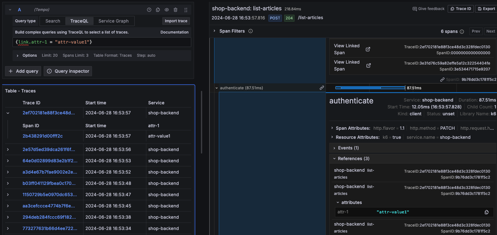

We’ve added event attributes and link scopes. Like spans, they both have instrinsics and attributes.
The event scope lets you query events that happen within a span. A span event is a unique point in time during the span’s duration. While spans help build the structural hierarchy of your services, span events can provide a deeper level of granularity to help debug your application faster and maintain optimal performance. To learn more about how you can use span events, read the What are span events? blog post. [PRs 3708, 3708, 3908]
If you’ve instrumented your traces for span links, you can use the link scope to search for an attribute within a span link. A span link associates one span with one or more other spans. [PRs 3814, 3741]
For more information on span links, refer to the Span Links documentation in the Open Telemetry project.
You can search for an attribute in your link:
{ link.opentracing.ref_type = "child_of" }
A TraceQL example showing link scope
We’ve also added autocomplete support for events and links. [PR 3846]

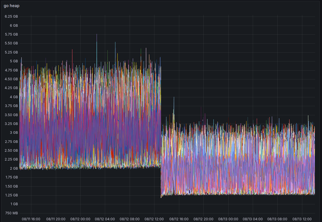

Performance improvements
One of our major improvements in Tempo 2.6 is the reduction of memory usage due to polling improvements. [PRs 3950, 3951, 3952]
Comparison graph showing the reduction of memory usage due to the polling improvements
This improvement is a result of some of these changes:
