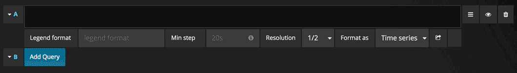

Prometheus query editor
Open a graph in edit mode by clicking the title > Edit (or by pressing e key while hovering over panel).
NameDescription
Query expressionPrometheus query expression, check out the Prometheus documentation.
Legend formatControls the name of the time series, using name or pattern. For example {{hostname}} is replaced with the label value for the label hostname.
Min stepAn additional lower limit for the step parameter of Prometheus range queries and for the $__interval variable. The limit is absolute and not modified by the Resolution setting.
Resolution1/1 sets both the $__interval variable and the step parameter of Prometheus range queries such that each pixel corresponds to one data point. For better performance, lower resolutions can be picked. 1/2 only retrieves a data point for every other pixel, and 1/10 retrieves one data point per 10 pixels. Note that both Min time interval and Min step limit the final value of $__interval and step.
Metric lookupSearch for metric names in this input field.
Format asSwitch between Table, Time series or Heatmap. Table will only work in the Table panel. Heatmap is suitable for displaying metrics of the Histogram type on a Heatmap panel. Under the hood, it converts cumulative histograms to regular ones and sorts series by the bucket bound.
InstantPerform an “instant” query, to return only the latest value that Prometheus has scraped for the requested time series. Instant queries return results much faster than normal range queries. Use them to look up label sets.
Min time intervalThis value multiplied by the denominator from the Resolution setting sets a lower limit to both the $__interval variable and the step parameter of Prometheus range queries. Defaults to Scrape interval as set in the data source options.
