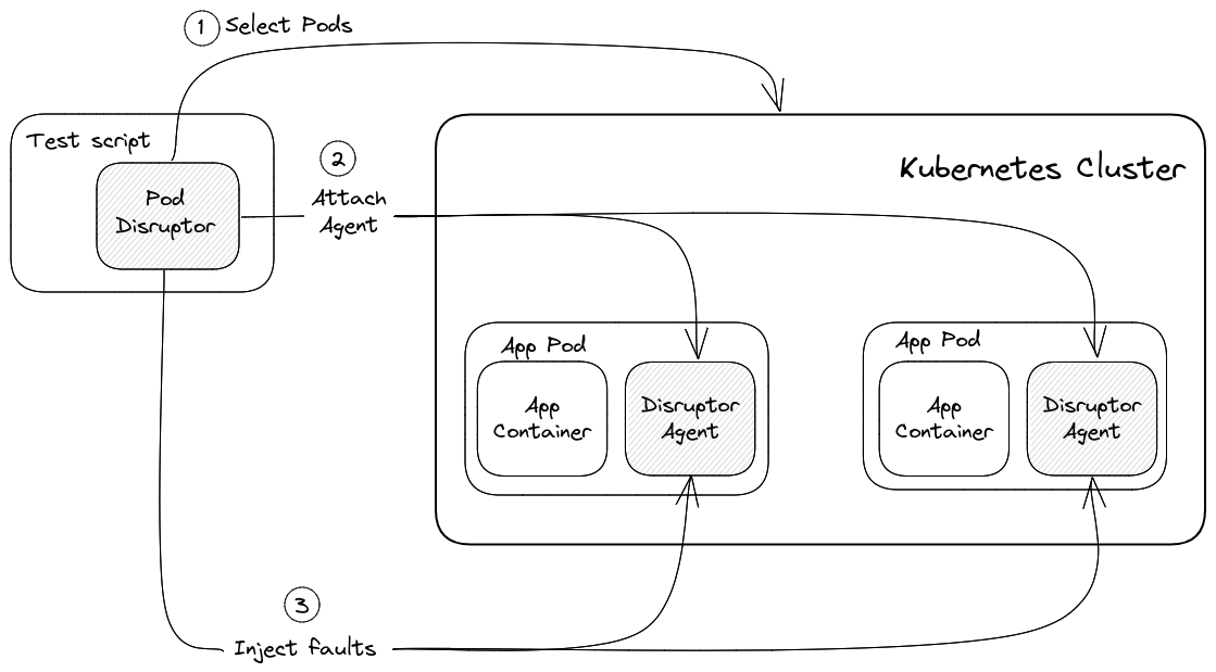

PodDisruptor
The following diagram shows how PodDisruptor works:
  1. The PodDisruptor selects the target pods based on the selector attributes defined in the constructor
  2. The PodDisruptor attaches the xk6-disruptor-agent to each of the target pods
  3. When a fault is injected (e.g. calling the injectHTTPFaults) the PodDisruptor sends a command to the agents to inject the fault in their respective pods
How PodDisruptor works

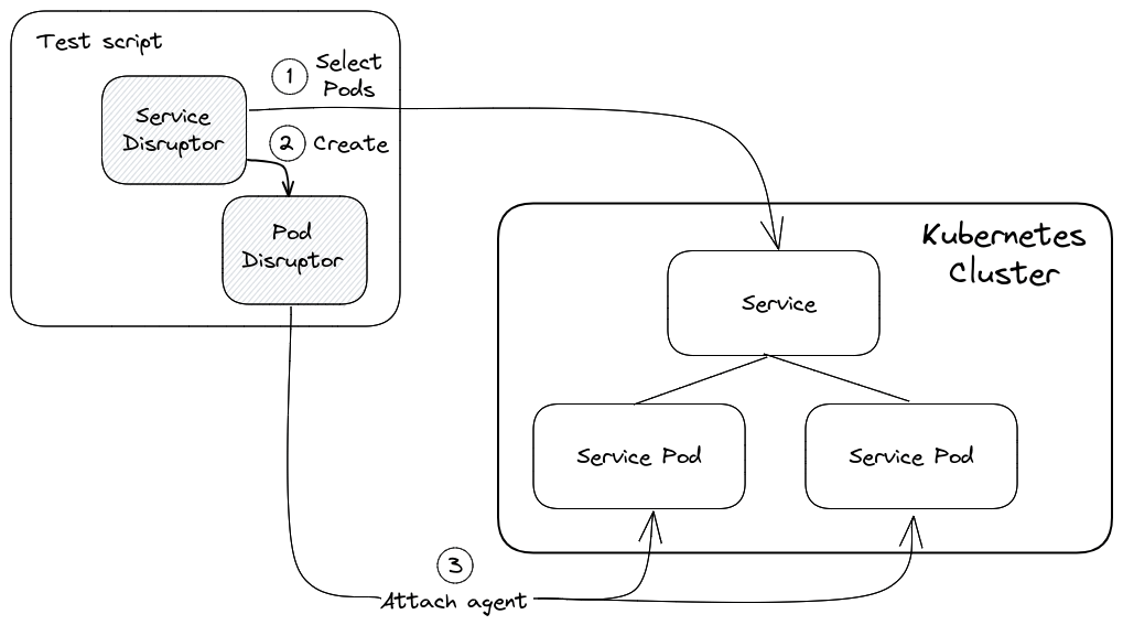

ServiceDisruptor
The ServiceDisruptor works as a wrapper around a PodDisruptor, which targets the pods that back the service.
  1. The ServiceDisruptor uses the definition of the service specified in the constructor to create a pod selector that matches the pods that back the service.
  2. The ServiceDisruptor creates a PodDisruptor using this pod selector.
  3. The PodDisruptor installs the agent in the target pods.
From this point, the PodDisruptor works as described before.
How ServiceDisruptor works
