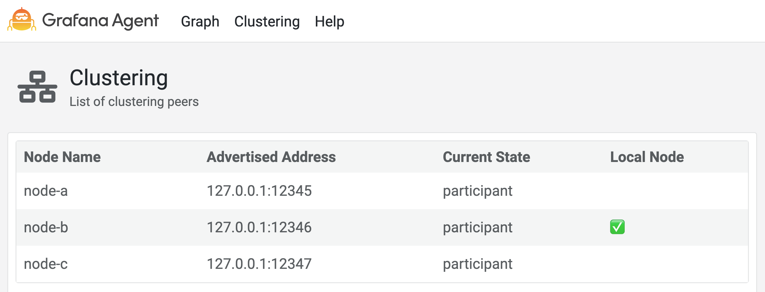

Clustering page
The clustering page shows the following information for each cluster node:
  • The node’s name.
  • The node’s advertised address.
  • The node’s current state (Viewer/Participant/Terminating).
  • The local node that serves the UI.

Debugging clustering issues
To debug issues when using clustering, check for the following symptoms.
  • Cluster not converging: The cluster peers are not converging on the same view of their peers’ status. This is most likely due to network connectivity issues between the cluster nodes. Use the Flow UI of each running peer to understand which nodes are not being picked up correctly.
  • Cluster split brain: The cluster peers are not aware of one another, thinking theyโ€™re the only node present. Again, check for network connectivity issues. Check that the addresses or DNS names given to the node to join are correctly formatted and reachable.
  • Configuration drift: Clustering assumes that all nodes are running with the same configuration file at roughly the same time. Check the logs for issues with the reloaded configuration file as well as the graph page to verify changes have been applied.
  • Node name conflicts: Clustering assumes all nodes have unique names; nodes with conflicting names are rejected and will not join the cluster. Look at the clustering UI page for the list of current peers with their names, and check the logs for any reported name conflict events.
  • Node stuck in terminating state: The node attempted to gracefully shut down and set its state to Terminating, but it has not completely gone away. Check the clustering page to view the state of the peers and verify that the terminating Agent has been shut down.
