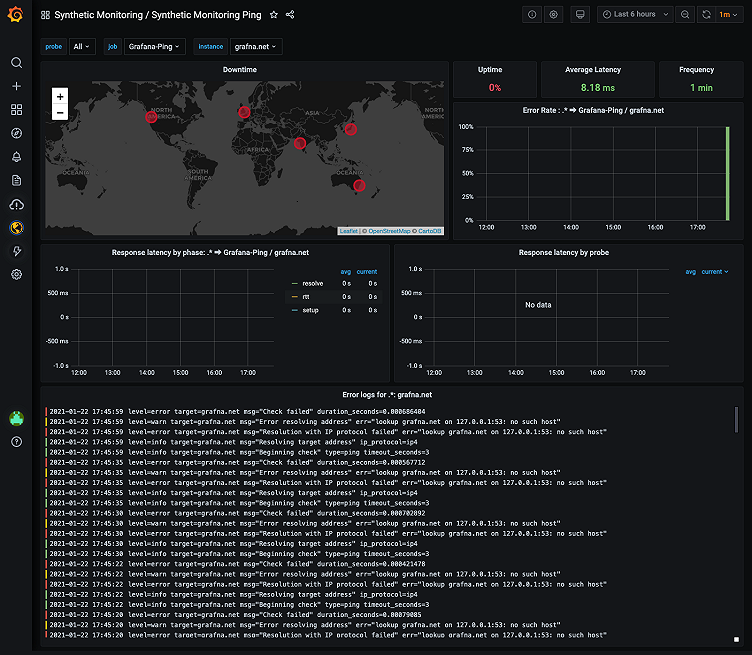

Once selected, the dashboard for our ping check will be opened, and it will look like this:
Note that the top of the dashboard has three selectable dashboard variables: probe, job, and instance. The probe variable allows you to select a single probe for more detailed information on metrics returned by it. (All is selected by default, using averages of all probes configured for the check). The job is the ping job to display information on, and as we currently only have the one job, this is set to Grafana-Ping. Finally, the instance variable allows you to find all prior instances of the target.
There are some interesting panels here, although a couple of them are empty. This is, as you may have guessed, because the check is currently failing. The Downtime panel shows the locations of the probes that we added for the check. Red shows a failed check from a probe, while green shows a successful check. There’s also a stats panel that shows the Average Latency for the check, the Frequency for it (currently 60 seconds), and the Uptime for the check target.
So why’s the check failing? Well, we actually made a typographical error when specifying the target for the grafana.net server when we configured the check. Take a look at the Error logs for .*: grafna.net panel (which includes the target typo). You’ll see a repeated set of errors that look like this:
2021-01-22 17:52:35
level=info target=grafna.net msg="Resolving target address" ip_protocol=ip4
2021-01-22 17:52:35
level=info target=grafna.net msg="Beginning check" type=ping timeout_seconds=3
2021-01-22 17:52:30
level=error target=grafna.net msg="Check failed" duration_seconds=0.000799491
2021-01-22 17:52:30
level=warn target=grafna.net msg="Error resolving address" err="lookup grafna.net on 127.0.0.1:53: no such host"
2021-01-22 17:52:30
level=error target=grafna.net msg="Resolution with IP protocol failed" err="lookup grafna.net on 127.0.0.1:53: no such host"
This shows that the grafna.net target didn’t return an ICMP echo, because it couldn’t be reached (at the time of writing, this host doesn’t exist).
Having looked at the logs and determined why the check is failing, you can now go back to the configuration page for this check to change it.
Do this by going back to the Synthetics homepage, selecting the option to view the existing checks, and then clicking the edit check option, represented with a pencil right below latency metrics. Change the Target from grafna.net to grafana.net, and then select Save at the bottom of the page.
Shortly after changing the target, go back to the dashboard page for the check. Now you’ll be able to see that the check is working correctly, and you’re getting data from all six probes.
