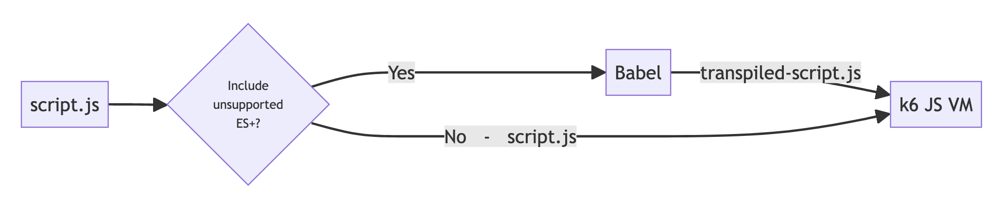

To enable ES module support, k6 uses Babel internally to transform ESM to CommonJS. The process is as follows:
Babel transformation in k6

As illustrated in the previous diagram, if k6 detects unsupported ES+ features while parsing the test script, it then transforms the script with Babel to polyfill the unsupported features.
Currently, the k6 Babel transformation only adds ESM support and sets global (node’s global variable) with the value of globalThis.
