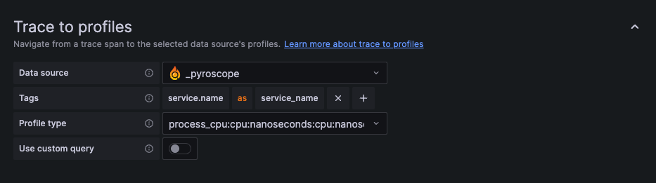

Trace to profiles
Using Trace to profiles, you can use Grafana’s ability to correlate different signals by adding the functionality to link between traces and profiles.
Trace to profiles lets you link your Grafana Pyroscope data source to tracing data. When configured, this connection lets you run queries from a trace span into the profile data.
There are two ways to configure the trace to profiles feature:
  • Use a basic configuration with default query, or
  • Configure a custom query where you can use a template language to interpolate variables from the trace or span.
Note
Traces to profile requires a Tempo data source with Traces to profiles configured and a Pyroscope data source.
As with traces, your application needs to be instrumented to emit profiling data. For more information, refer to Linking tracing and profiling with span profiles.

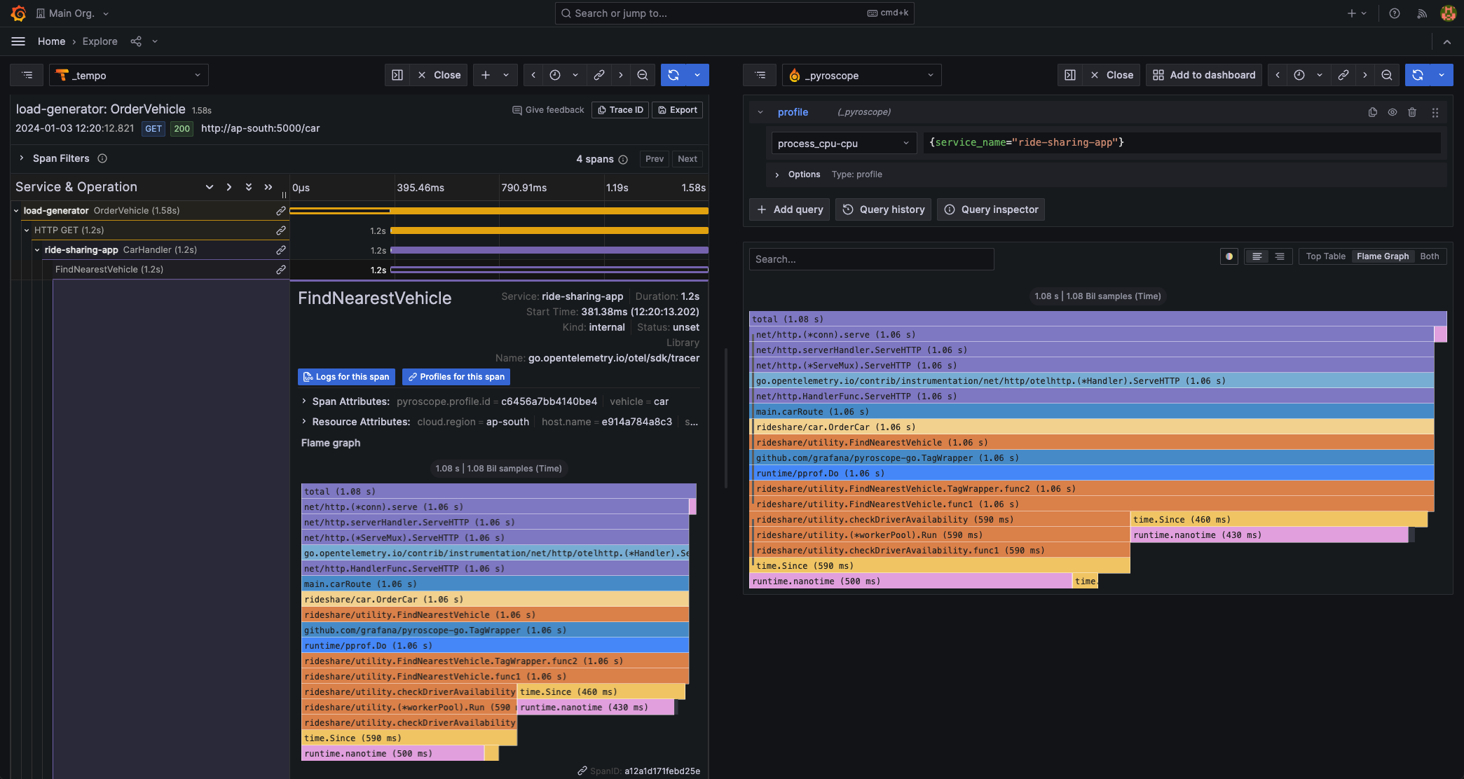

To use trace to profiles, navigate to Explore and query a trace. Each span links to your queries. Clicking a link runs the query in a split panel. If tags are configured, Grafana dynamically inserts the span attribute values into the query. The query runs over the time range of the (span start time - 60) to (span end time + 60 seconds).
Selecting a link in the span queries the profile data source
To use trace to profiles, you must have a configured Grafana Pyroscope data source. For more information, refer to the Grafana Pyroscope data source documentation.
Embedded flame graphs are also inserted into each span details section that has a linked profile. This lets you see resource consumption in a flame graph visualization for each span without having to navigate away from the current view. Hover over a particular block in the flame graph to see more details about the consumed resources.
Configuration options
The following table describes options for configuring your Trace to profiles settings:
Setting nameDescription
Data sourceDefines the target data source. You can select a Pyroscope [profiling] data source.
TagsDefines the tags to use in the profile query. Default: cluster, hostname, namespace, pod, service.name, service.namespace. You can change the tag name for example to remove dots from the name if they’re not allowed in the target data source. For example, map http.status to http_status.
Profile typeDefines the profile type that used in the query.
Use custom queryToggles use of custom query with interpolation.
QueryInput to write custom query. Use variable interpolation to customize it with variables from span.
To use a basic configuration, follow these steps:
  1. In the left menu, select Connections > Data sources.
  2. Select your configured Tempo data source from the Data source list.
  3. Scroll down to the Traces to profiles section.
  4. Select a Pyroscope data source in the Data source drop-down.
  5. Optional: Add one or more tags to use in the query. If left blank, the default values of service.name and service.namespace are used.
    The tags you configure must be present in the spans attributes or resources for a trace-to-profiles span link to appear.
    You can optionally configure a new name for the tag. This is useful if the tag has dots in the name and the target data source doesn’t allow dots in labels. In that case, you can remap service.name to service_name.
  6. Select one or more profile types to use in the query. Select the drop-down and choose options from the menu.
    The profile type or app must be selected for the query to be valid. Grafana doesn’t show any data if the profile type or app isn’t selected when a query runs. Traces to profile configuration options in the Tempo data source
  7. Select Save and Test.

      tracesToProfiles:
        datasourceUid: 'grafana-pyroscope-datasource'
        tags: ['job', 'instance', 'pod', 'namespace']
        profileTypeId: 'process_cpu:cpu:nanoseconds:cpu:nanoseconds'
        customQuery: true
        query: 'method="${__span.tags.method}"'
