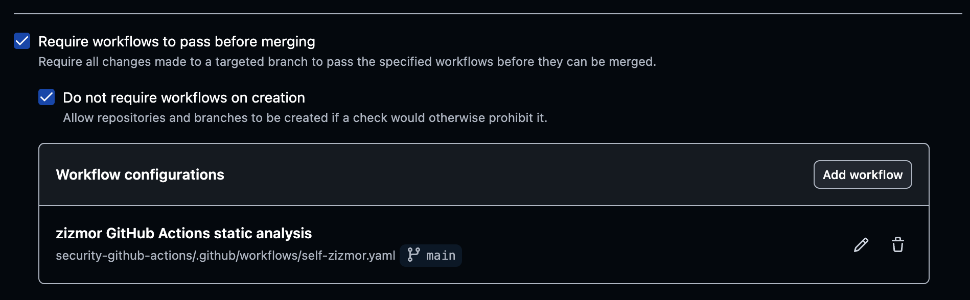

Now that we have an action, we can use rulesets to roll this out to all of the repositories in our organization. We use the “Require workflows to pass before merging” check to define that from the security controlled repository.
GitHub Branch Ruleset configuration for zizmor workflow

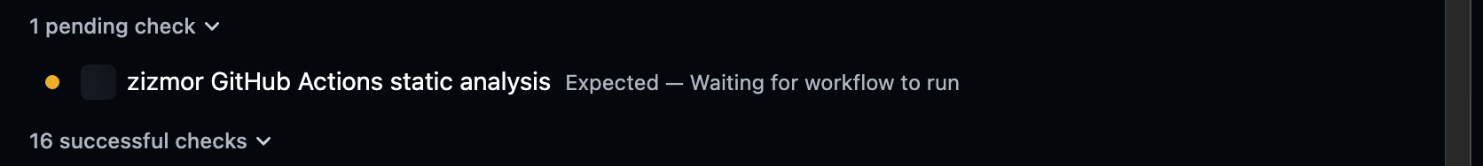

Once we enable the check (in evaluation mode initially) we start to see workflow runs being expected on existing and new PRs. It’s worth noting that GitHub’s system requires existing PRs to either be closed and re-opened or to have an empty commit pushed to the branch.
Zizmor check expecting result in repository
