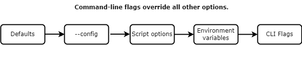

This was a good warm up. I knew about the k6-option lookup order, because I keep changing the diagram. (I can’t ever decide how to represent precedence: with equality operators? Through arrows? Through some sort of vertical and horizontal positioning?)
A diagram showing that the CLI flags override all other options.

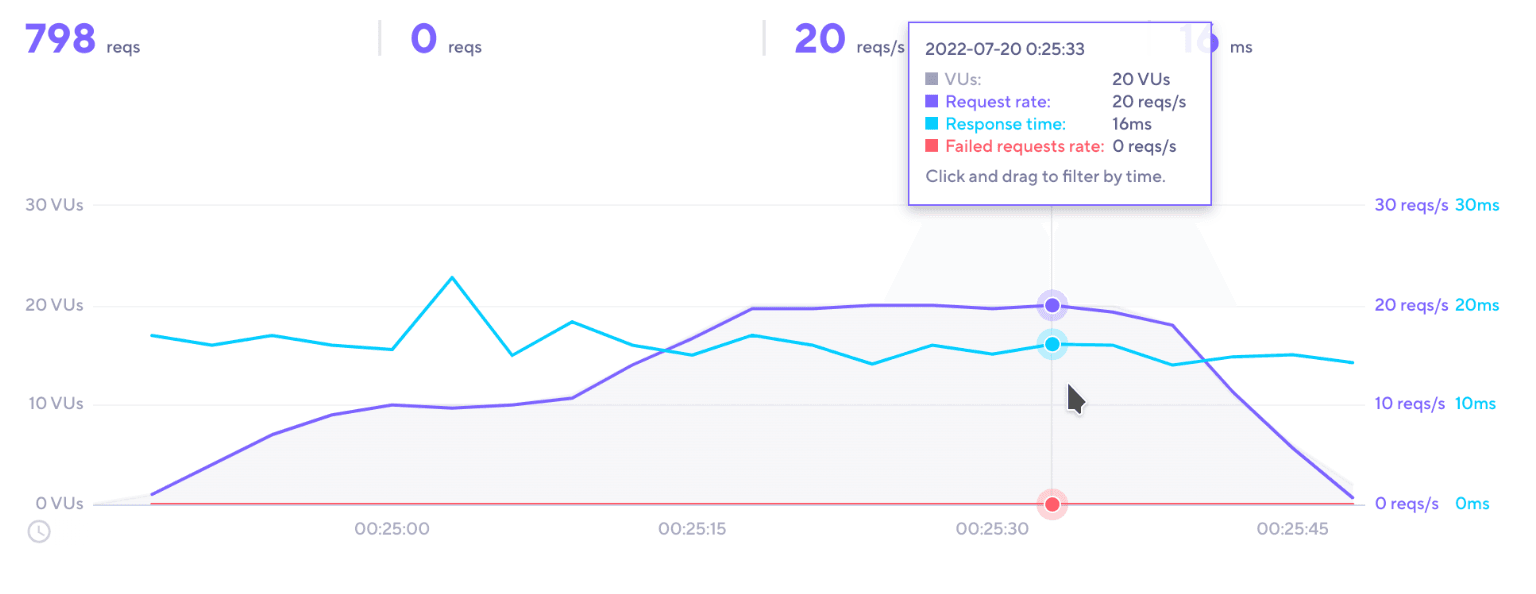

Run the same test on the cloud and visualize the ramping
Overall, I expect that stages that have these values:
tages : [
    { duration: "10s", target: 10 },
    { duration: "10s", target: 20 },
    { duration: "20s", target: 20 },
    { duration: "10s", target: 0 },
…should have a request-per-second throughput that looks something like this:
               xxxxxxxxxxxxxxxxxxxxxxx
             xxx                     xx
           xxx                        xx
     xxxxxxx                           xx
   xx                                   xx
  xx                                     xx
xx                                        xx
Let’s see:
k6 cloud stages.js
Here’s how this test looked in the cloud:
A screenshot of the test results in k6 Cloud.

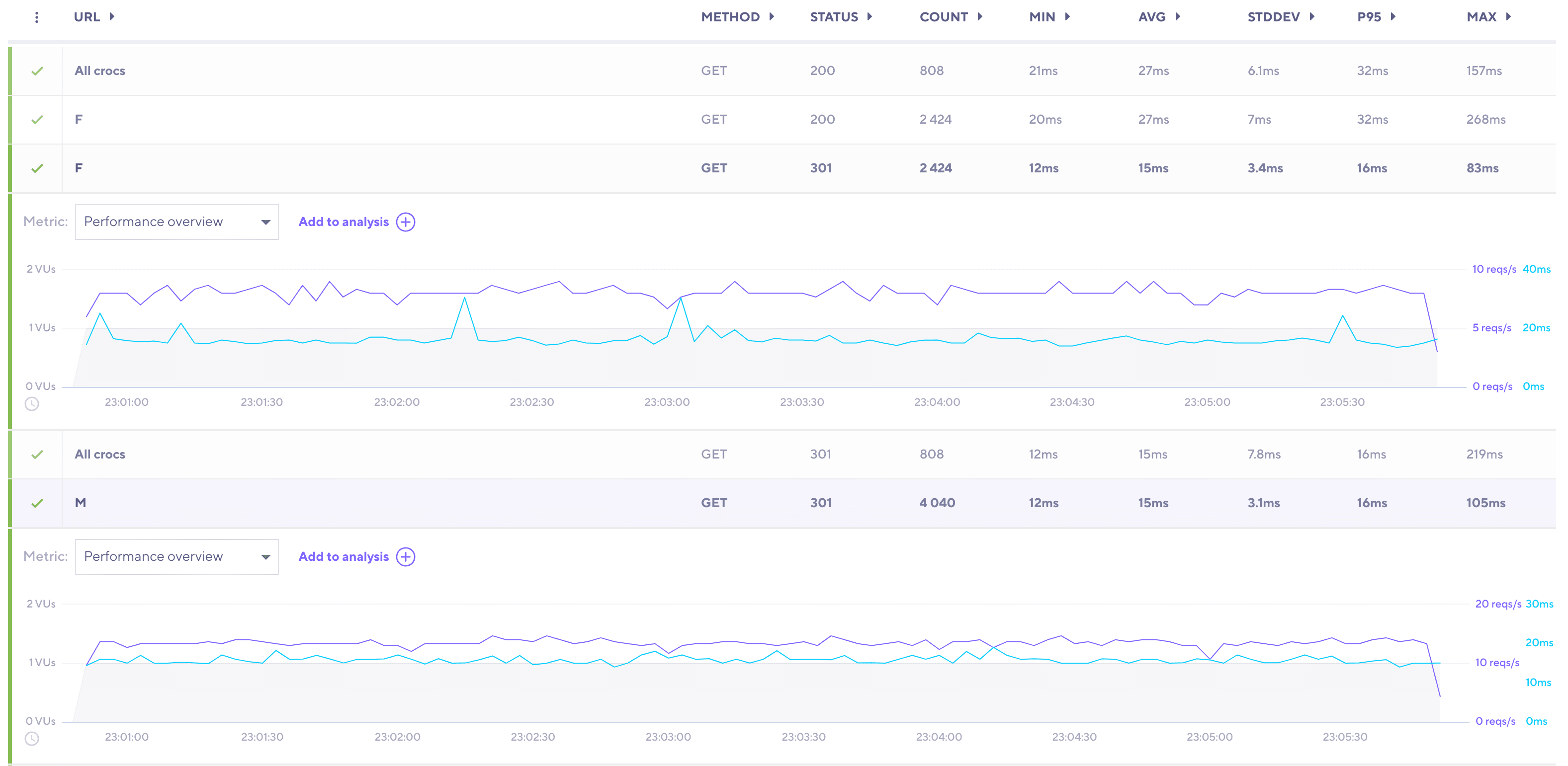

Group dynamic URLs and visualize the test on k6 Cloud
By default, each requested URL is going to have its own tag. This can create a big mess with dynamic URLs.
Of the crocodile objects, the sex property was the only one that had repeated values. That seems like a good candidate for a name.
Solution: group dynamic URLs
JavaScript
import http from 'k6/http';
import { sleep } from 'k6';
export default function () {
  const response = http.get('https://test-api.k6.io/public/crocodiles', {
    tags: { name: 'All crocs' },
  const crocs = JSON.parse(response.body);
  crocs.forEach((croc) => {
    http.get(`https://test-api.k6.io/public/crocodiles/${croc['id']}`, {
      tags: { name: `${croc['sex']}` },
k6 run --out json=grouped_crocs.json api/grouped.js
Now, to run it on the Cloud:
k6 cloud api/grouped.js
A screenshot of a k6 Cloud visualization of grouped URLs.

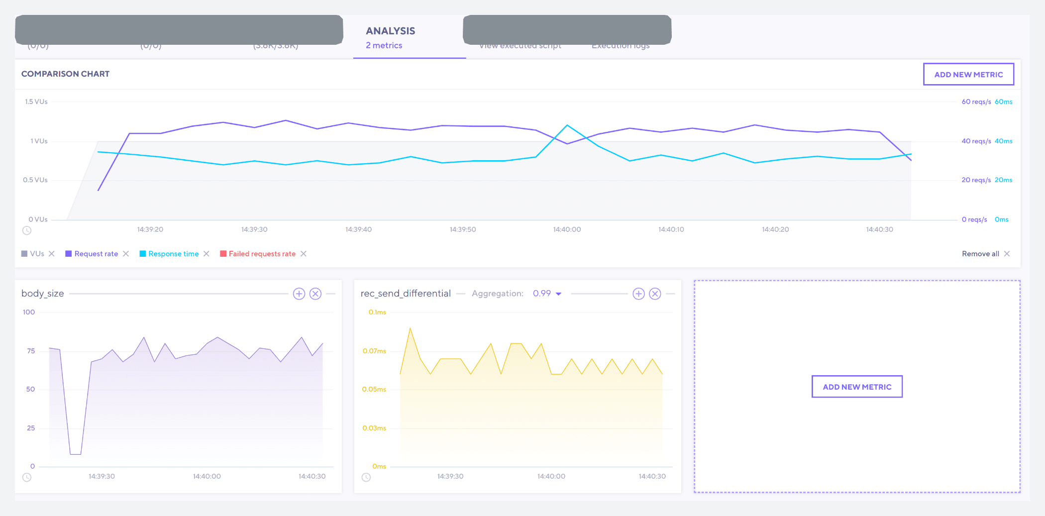

Create one or two types of custom metrics (Counter, Gauge, Trend, Rate)
I decided to make two metrics:
  • A gauge to save a maximum value
  • A trend to make a p99 value
The gauge wasn’t hard, but it took me so long to make a trend metric that didn’t seem trivial. Finally, I came up with the idea of making a differential between sending and receiving time. Maybe this is still trivial, but I think it works (in the sense that it doesn’t throw errors or emit evidently junk data).
Solution: custom gauge and trend metrics

Results on the cloud:
I’m cranking up the iterations here, so the graph has more obvious data points.
k6 cloud --iterations 200 metrics/trend.js
Of the many ways to aggregate the data, this chart compares the metric’s p99 values.
A screenshot of a k6 Cloud visualization for custom metrics.
