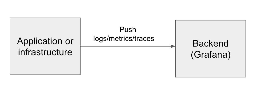

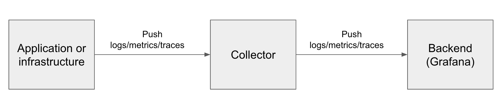

When you use OpenTelemetry SDKs to collect logs, metrics, and traces from infrastructure or an application, you’ll find many references to people using Grafana Agent and OpenTelemetry Collector. They start with an application or infrastructure that sends telemetry, and that data is sent to a collector, which then sends it to a backend like Grafana that may perform many functions, including visualization. The architecture looks like this:
The purpose of this article is to discuss why these intermediate collectors are so popular — and, ultimately, recommended. And don’t worry, I won’t make you wait for the punchline: if you want to collect any amount of telemetry with any frequency, you should use a collector. Now, let’s get into exactly why that is.
What’s a collector, and do I need one?
The telemetry “Collector” in the middle of the diagram above is a tool that can connect to various sources to gather telemetry (logs, metrics, and traces). These collectors serve as intermediaries, scraping and collecting data from different places and then transmitting it to a storage backend, abstracting away the complexities of data collection and storage. This collector model is common in the telemetry world; Prometheus is also used as intermediate software, for example, to gather metrics from applications like NGINX and send them to Grafana.
But if the application is already pushing telemetry, why have yet another software component to manage when we could just send the telemetry directly to the backend? After all, it is possible to send data directly to Grafana’s OpenTelemetry Protocol (OTLP) endpoint, without a collector or agent, by configuring your OTel SDK with an environment like this:
OTEL_EXPORTER_OTLP_PROTOCOL=http/protobuf
OTEL_EXPORTER_OTLP_ENDPOINT=https://otlp-gateway-prod-us-east-0.grafana.net/otlp
HEADER="Basic $(echo -n $GRAFANA_INSTANCE_ID:$TOKEN | base64)"
OTEL_EXPORTER_OTLP_HEADERS="Authorization=$HEADER"
OTEL_TRACES_EXPORTER=otlp
OTEL_METRICS_EXPORTER=otlp
OTEL_LOGS_EXPORTER=otlp
OTEL_SERVICE_NAME="my-cool-service"
This configuration works for testing setups. However, in real deployments we will run into many reasons why we want a collector in the middle.

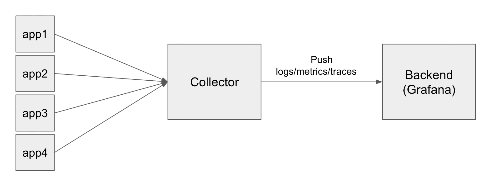

This gets particularly intense if you have a large number of microservices, or hundreds of different Linux machines. It just makes more sense to configure all of those telemetry reporters to point to a single collector (or fleet) of collectors. These collectors allow for much greater operational flexibility because:
- They can all be managed in one place
- Your apps and infrastructure remain coupled to the collectors
- The collector is responsible for routing the information beyond that point
The final consideration is switching backends. If you are switching from another observability platform to Grafana, or migrating from Grafana Enterprise to Grafana Cloud, it’s much easier to do this by targeting and changing only the collector layer of the architecture, rather than modifying all of the apps.
