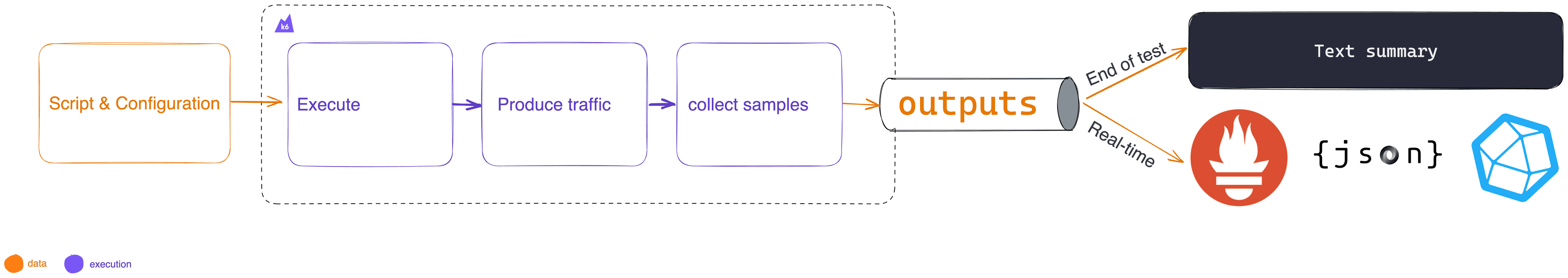

To fulfill its mission, k6 is centered around two main components: an execution pipeline and a data pipeline.
Think about k6 as a simplified work scheduler, similar to those found in operating systems. Users write code to define the operations they want to perform and specify the constraints they wish to apply. k6 then creates an execution plan based on this code and its configuration, and orchestrates the process until completion.
As the code is executed and the scheduled plan progresses, k6 gathers measurements and funnels them into the data pipeline. This data is directed to real-time external outputs, enabling users to analyze it with their preferred tooling and according to their specific needs, as described above. In parallel, k6 classifies and aggregates the data to generate an end-of-test summary.
Finally, as a load testing tool, k6 is engineered to execute code and carry out its plan swiftly and efficiently. To manage heavy workloads and high traffic volumes, it maximizes available hardware resources.
