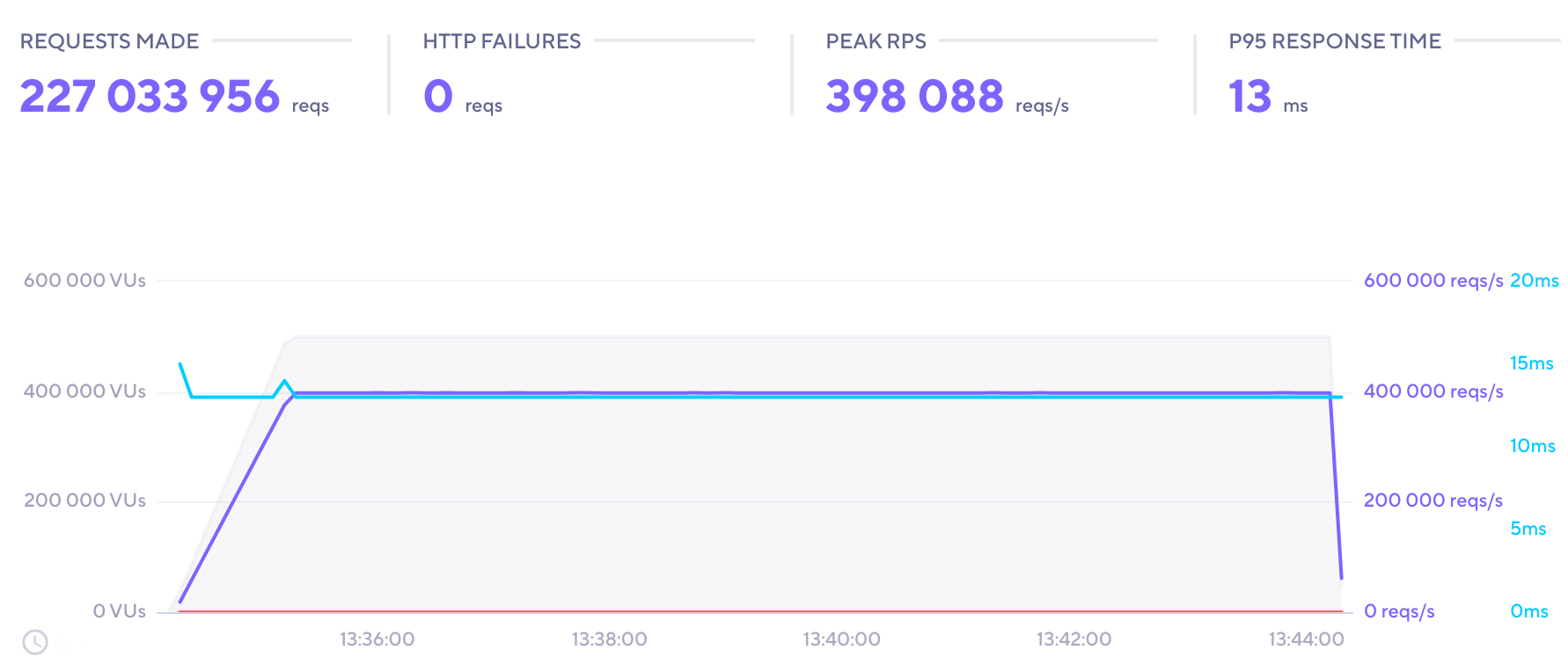

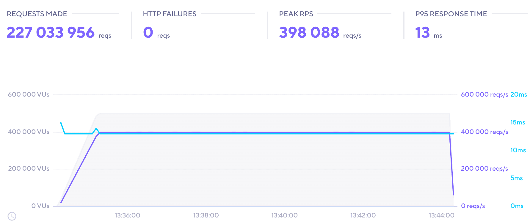

Peak load test
A stress test to see whether k6 could maintain an RPS that corresponded to peak load.
Load configuration:
- VUs: 500k
- Duration: 10m
- Unique URLs: 50
- Peak RPS: 400k
- Total reqs: 227M
- Load zones: 2
Output:
- Time-series: 23k
- Raw records: 1.3M
Observations: The system handled this decently, but only after auto-scaling kicked in. It also took a bit of time for the RabbitMQ queue to drain after this.

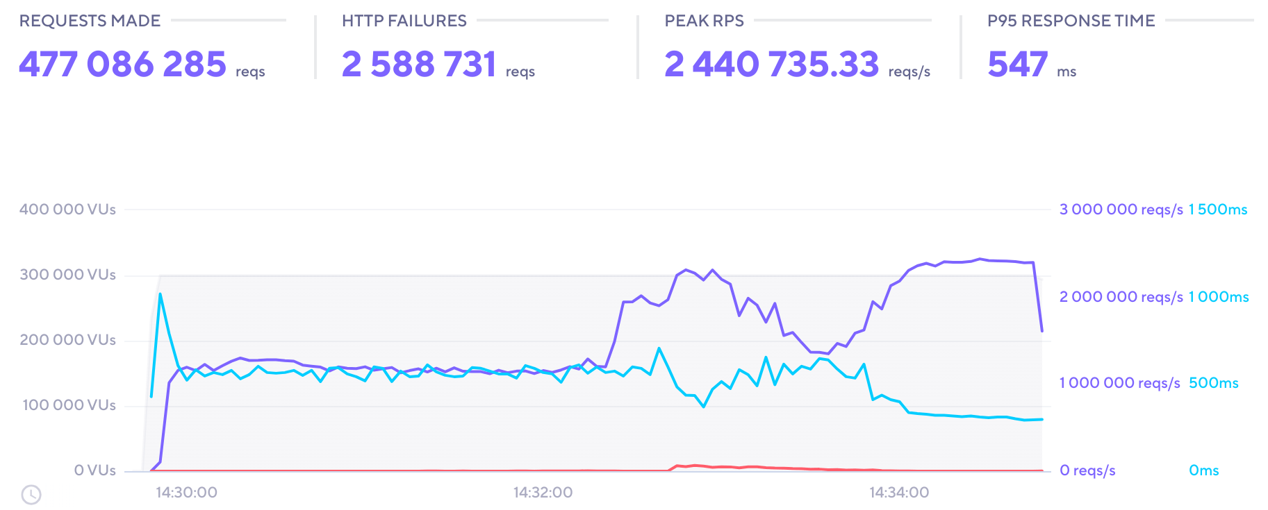

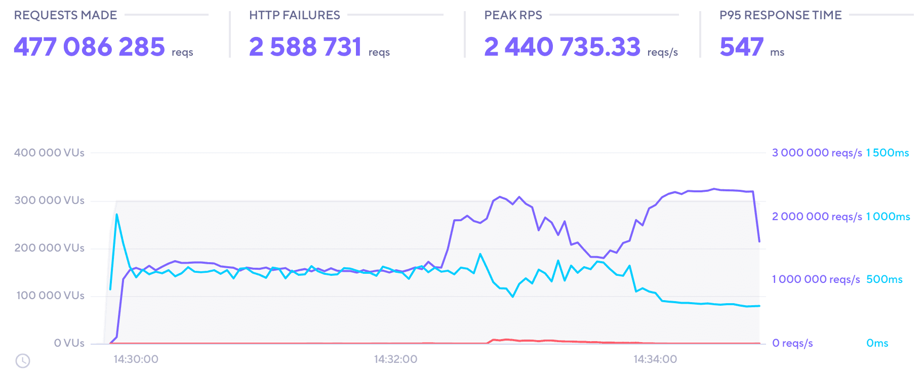

Spike test
A spike test to generate as high an RPS as possible in a short period of time.
Load configuration:
- VUs: 300k
- Duration: 5m
- Unique URLs: 40
- Peak RPS: 2.4M
- Total reqs: 477M
- Load zones: 4
Output:
- Time-series: 13k
- Raw records: 210k
Observations: With the relatively low number of records, data-read time was lower than it was in the stress test. However, the CPU utilization of the load generators became very high.

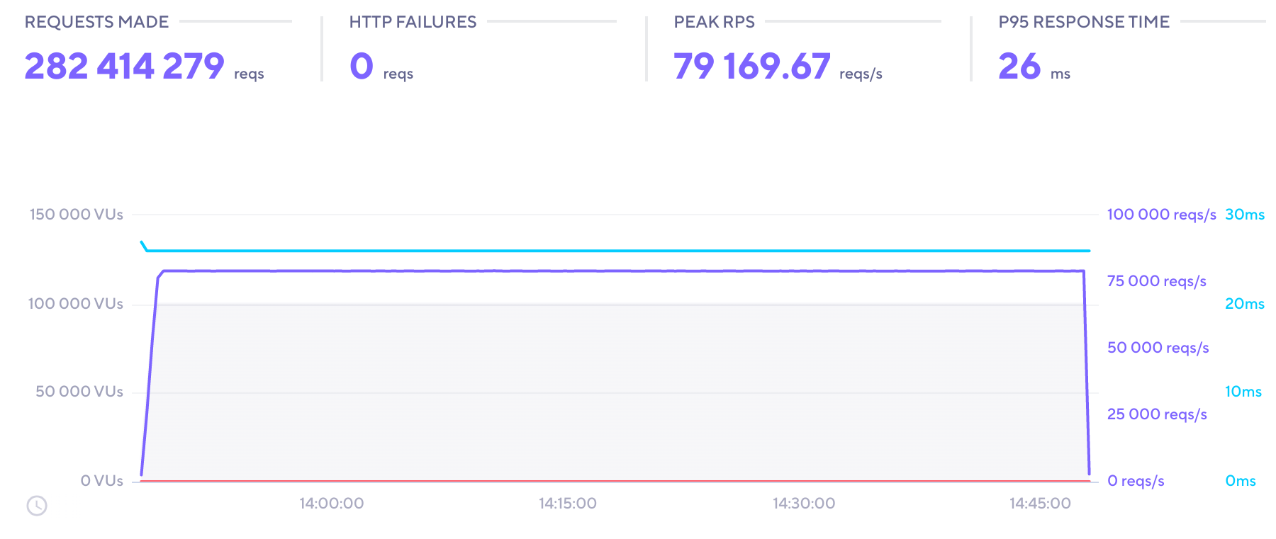

Soak test
A soak test to discover how read time increases with test duration.
Load configuration:
- VUs: 100k
- Duration: 60m
- Unique URLs: 50
- Peak RPS: 80k
- Total reqs: 282M
- Load zones: 4
Output:
- Time-series: 5k
- Raw records: 1.7M
Observations: While the system could handle this, read time for metric data gradually increased over the course of the hour. Comparing this with the other tests, we concluded that read time increases more or less linearly with the number of records.

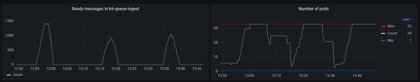

The RabbitMQ-autoscaling wave pattern
Our autoscaler uses the number of queued RabbitMQ messages to determine whether it needs more ingest worker pods. When a long test run starts and the system catches up, the number of messages drops, then flatlines. After some time, the system then downscales the number of pods. However, since the same heavy test run continues to run, the number of messages rises again, and the cycle recurs in a “wavy” pattern.
We are investigating how to implement smarter autoscaling to keep the pod count at optimal numbers at all times.
