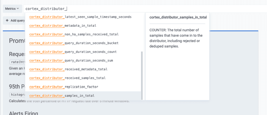

Let me be the bearer of the good news of how we’ve made working with Prometheus easier. Since Prometheus v2.15+ and Grafana v6.6+, you now get metric metadata directly in Grafana’s Explore view. Also, Cortex v1.1+ supports this too, if you pair it with our shiny new Grafana Agent.

More than once, I’ve seen Gauges with highly monotonic increases that could pose as Counters, or asked myself “Why are these metric names so similar? What is the difference between them?” Each time, I needed to look at the definition of the metric, typically in-code, to answer my questions. Given my low attention span, I find this approach highly disruptive to my workflow. This feature is designed to solve these common pain points.
As you type in the name of a metric, the AutoComplete panel now shows the metric metadata. This includes:
  • The Type. No more guessing on when you should apply rate to this function.
  • The Help. No more ambiguity on what this metric does.
  • The Unit. No more _seconds suffixes.
