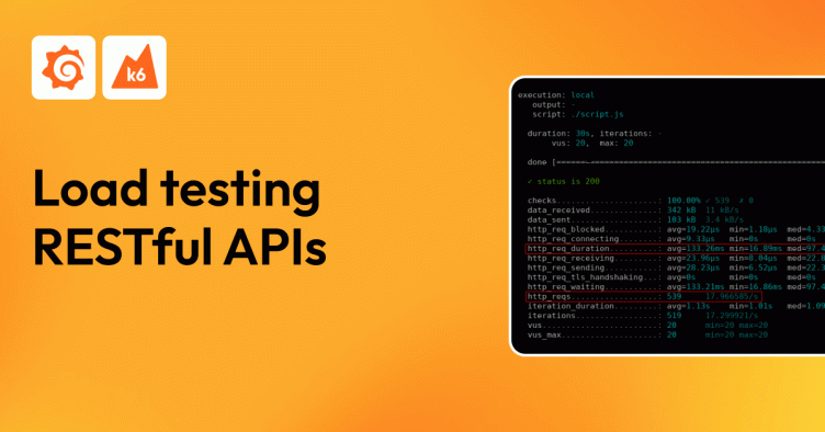

A screenshot of load test results showing all GET requests finish.
Load test results show all GET requests finish with 200 status; 95% of requests served in under 283.43ms
Some things we notice from the above output:
  • All requests finished in a timely manner, with the correct status code
  • 95% of our users got served a response in under 283.43ms
  • In the 30 second test duration we served 539 responses, at a rate of ~18 requests per second (RPS)
Now we have a better idea of the capabilities of this endpoint when responding to GET requests, in our particular environment.
