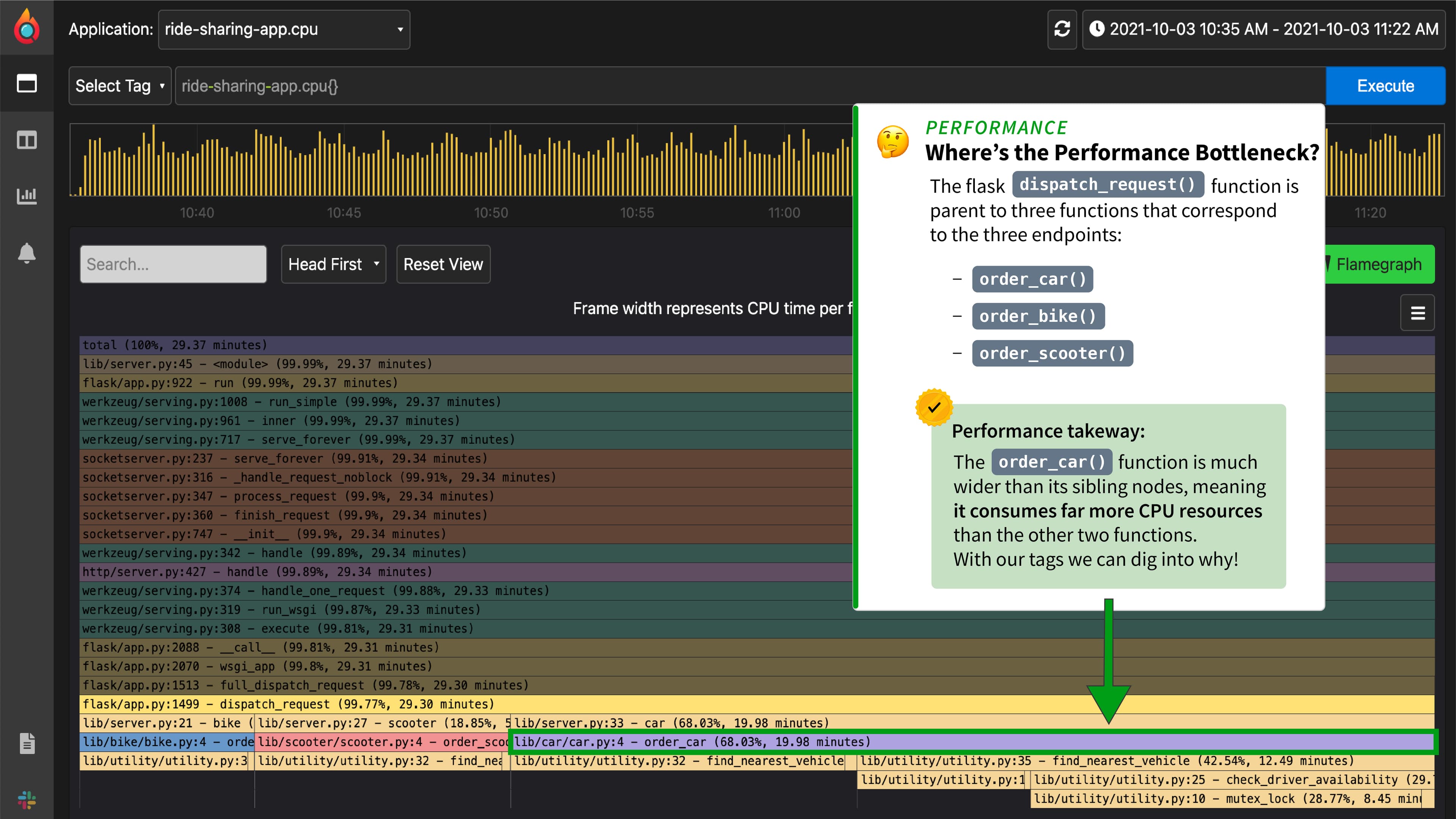

# docker-compose downWhat this example will do is run all the code mentioned above and also send some mock-load to the 3 servers as well as their respective 3 endpoints. If you select our application: ride-sharing-app.cpu from the dropdown, you should see a flame graph that looks like this (below). After we give 20-30 seconds for the flame graph to update and then click the refresh button we see our three functions at the bottom of the flame graph taking CPU resources proportional to the size of their respective search_radius parameters.
Where’s the performance bottleneck?
The first step when analyzing a profile outputted from your application, is to take note of the largest node which is where your application is spending the most resources. In this case, it happens to be the order_car function.

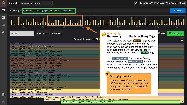

The benefit of using the Pyroscope package, is that now that we can investigate further as to why the order_car() function is problematic. Tagging both region and vehicle allows us to test two good hypotheses:
- Something is wrong with the
/carendpoint code - Something is wrong with one of our regions
To analyze this we can select one or more tags from the “Select Tag” dropdown:
Narrowing in on the issue using tags
Knowing there is an issue with the order_car() function we automatically select that tag. Then, after inspecting multiple region tags, it becomes clear by looking at the timeline that there is an issue with the us-west-1 region, where it alternates between high CPU times and low CPU times.
We can also see that the mutex_lock() function is consuming almost 70% of CPU resources during this time period.

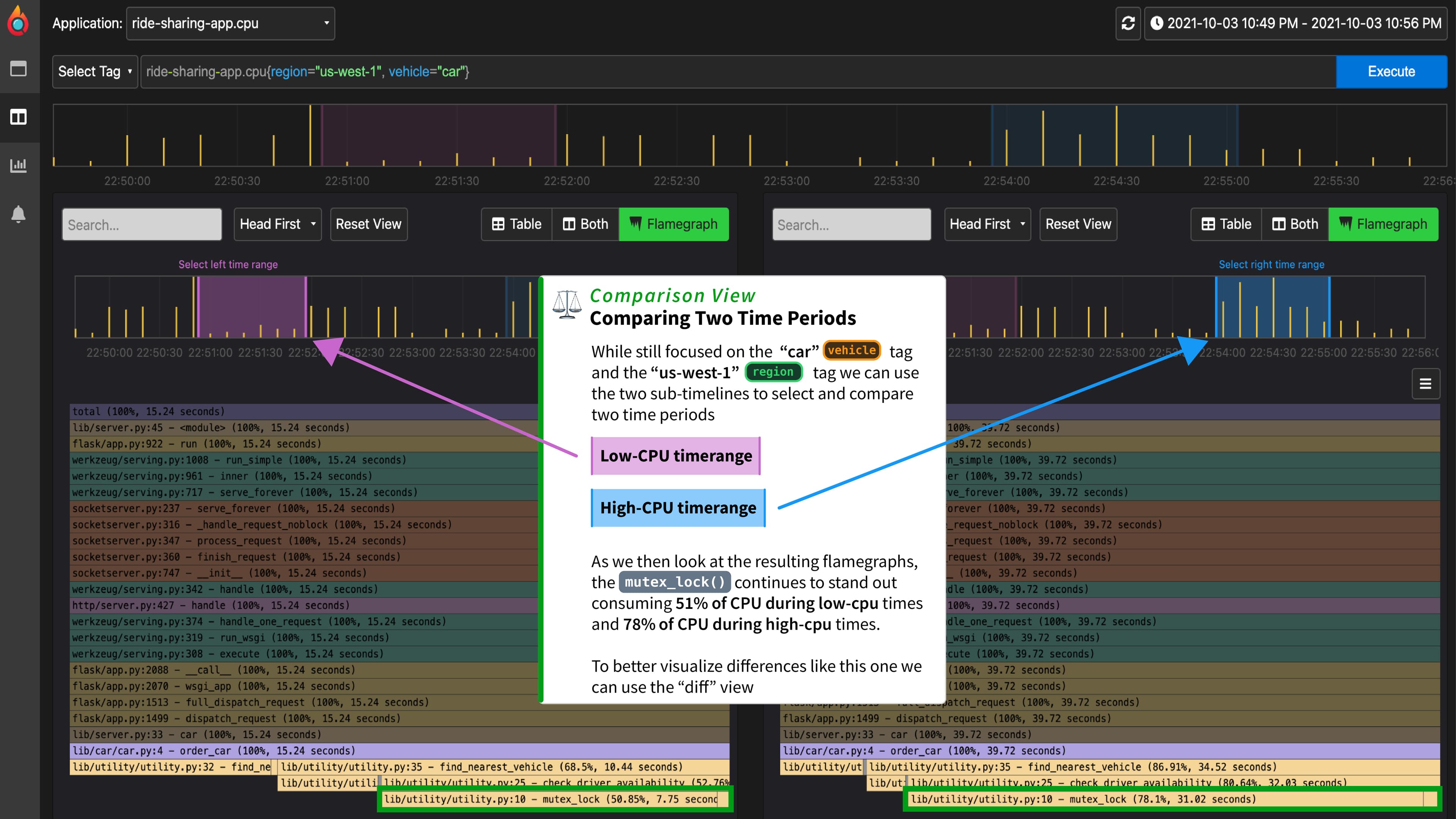

Comparing two time periods
Using Pyroscope’s “comparison view” we can actually select two different time ranges from the timeline to compare the resulting flame graphs. The pink section on the left timeline results in the left flamegraph, and the blue section on the right represents the right flame graph.
When we select a period of low CPU utilization and a period of high CPU utilization we can see that there is clearly different behavior in the mutex_lock() function where it takes 51% of CPU during low CPU times and 78% of CPU during high CPU times.

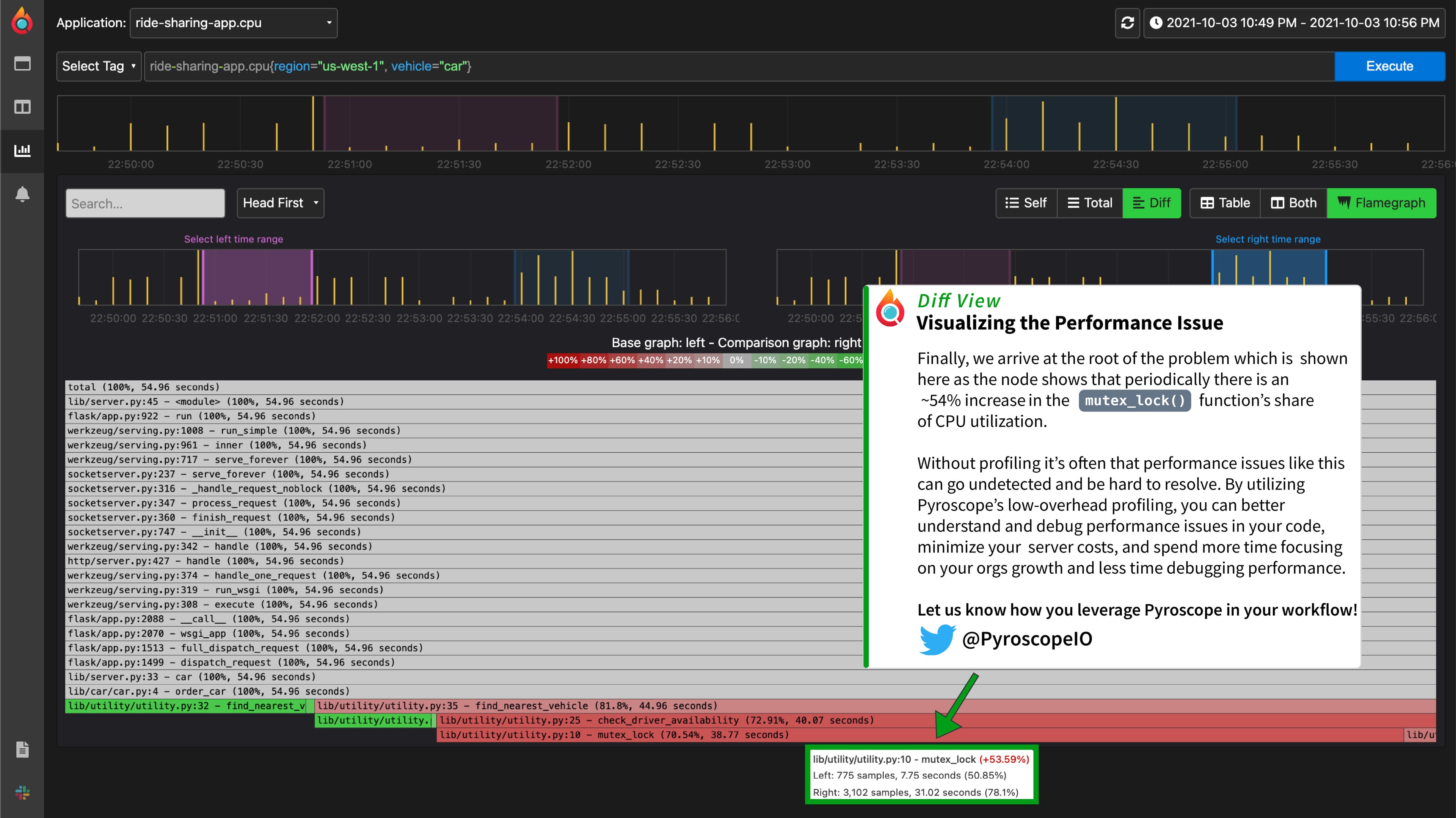

Visualizing the difference between two flame graphs
While the difference in this case is stark enough to see in the comparison view, sometimes the diff between the two flame graphs is better visualized with them overlayed over each other. Without changing any parameters, we can simply select the diff view tab and see the difference represented in a color-coded diff flame graph.
