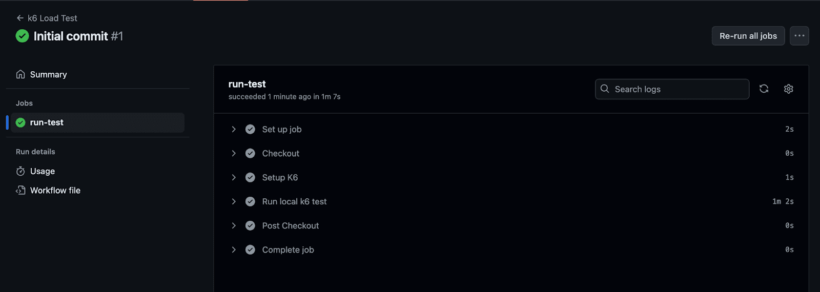

Setting up the GitHub Actions workflow
To have GitHub Actions pick up and execute our load test, we need to create a workflow configuration and place it in .github/workflows. Once this file has been pushed to our repository, each commit to our repository will result in the workflow being run.
name: k6 Load Test
on:
  push:
    branches:
jobs:
  run-test:
    runs-on: ubuntu-latest
    steps:
      - name: Checkout
        uses: actions/checkout@v4
      - name: Setup K6
        uses: grafana/setup-k6-action@v1
      - name: Run local k6 test
        uses: grafana/run-k6-action@v1
        with:
          path: test.js
k6 has official GitHub actions to make it easy to execute your load tests. They are divided into two parts:
  1. Setup k6 action: This action allows you to install and configure k6 in the pipeline easily. You can use it to customize what version of k6 you want or optionally configure a browser to easily run k6 browser tests.
You can use the following options with this action to modify its behavior:
  • k6-version: Specify the k6 version to use – for example, ‘0.49.0’. If not set, the latest k6 version will be used.
  • browser: If set to true, a chromium browser is set up along with k6, allowing you to run k6 browser tests. By default, it is set to false.
  1. Run k6 action: This action allows you to execute k6 tests with ease. You can use it to execute multiple test scripts in parallel, run cloud test runs, automatically add a comment on a PR with URLs to test run results, and more.
The following action inputs can be used along with the action:
  • path: Glob pattern to select one or multiple test scripts to run.
  • cloud-run-locally: If true, the tests are executed locally and the results are uploaded to Grafana Cloud k6, our fully managed performance testing platform powered by Grafana k6. By default, it is true.
  • parallel: If true, and multiple tests are executed, all of them run in parallel.
  • fail-fast: If true, the whole pipeline fails as soon as the first test fails.
  • flags: Additional flags to be passed on to the k6 run command, e.g., --vus 10 --duration 20s
  • cloud-comment-on-pr: If true, the workflow comments a link to the cloud test run on the pull request (if present). By default, it is true.
  • only-verify-scripts: If true, only check if the test scripts are valid and skip the test execution.
A screenshot the run-test job.A screenshot of code for running a local k6 test.

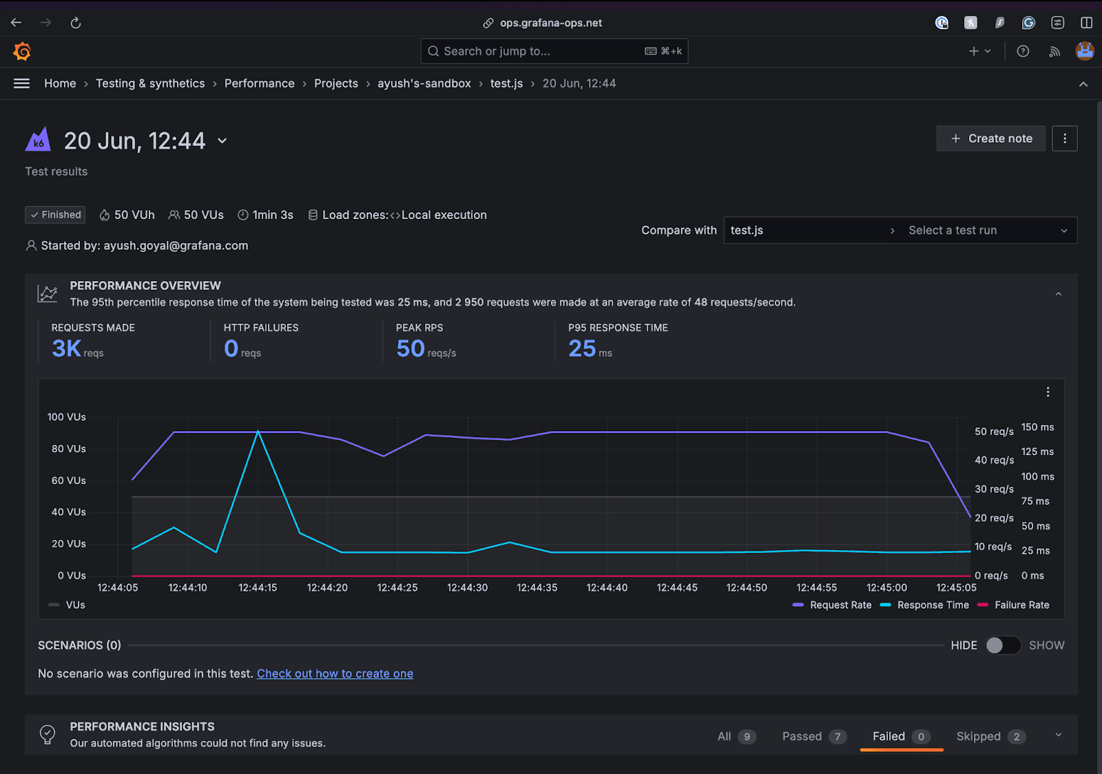

Once we commit and push these changes, k6 will run the cloud test, and output the URL to our test results as part of the workflow logs.
A screenshot of the output URL.
And if we copy the highlighted URL and navigate to it in a new tab:
A screenshot of the test results performance overview page.

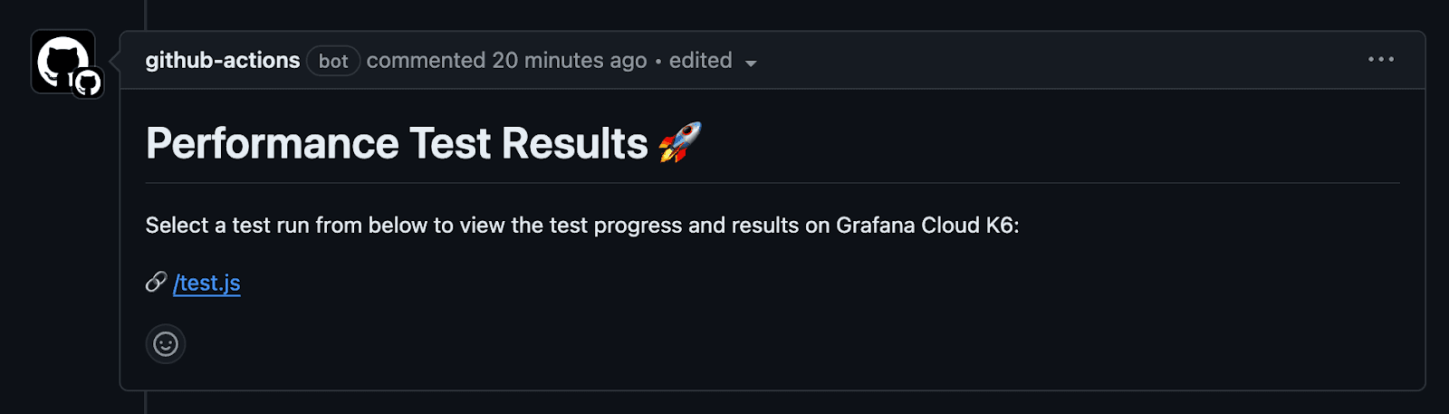

Comment cloud test run URLs on the PR
In both the cloud execution modes discussed above, if the commit is associated with an open pull request, the action will automatically try to add a comment on the pull request with the cloud test run URLs.
A screenshot of a comment on a pull request.
To disable this behavior, set the action input cloud-comment-on-pr to false.
If the comment is not being created for you, make sure the GitHub action has write permissions on the repository. Follow the instructions from the official GitHub docs to update the permissions for the GITHUB_TOKEN to have read and write permissions.
