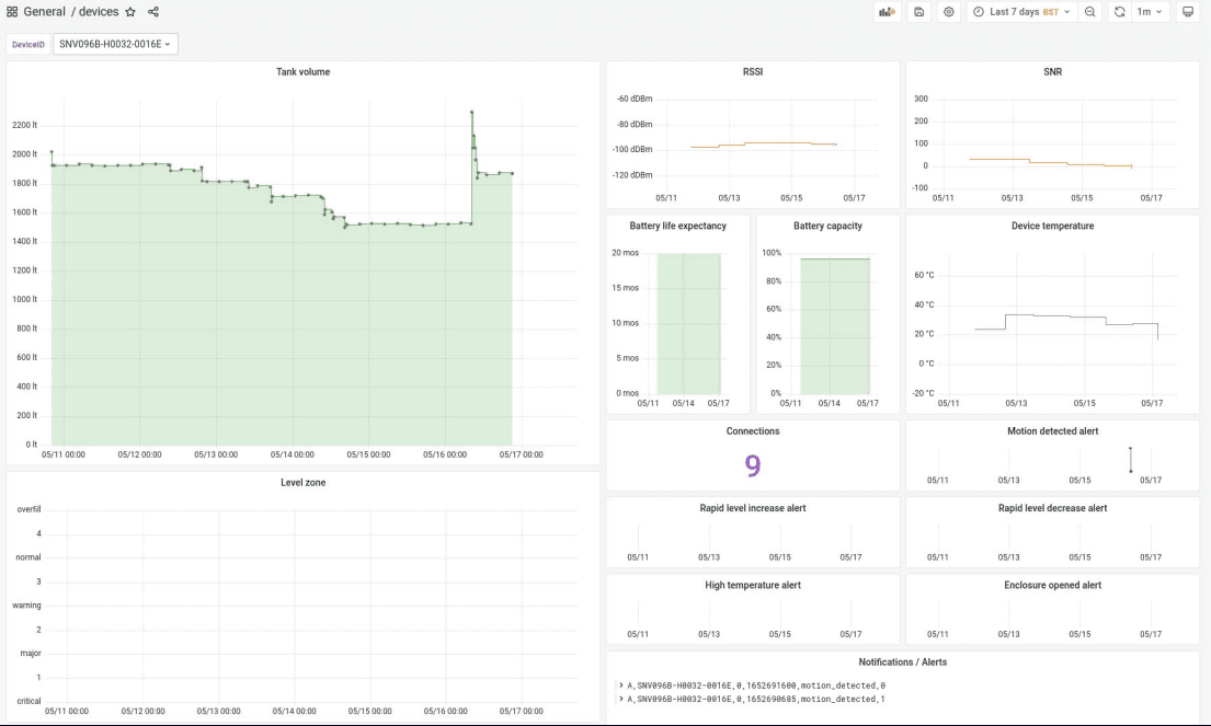

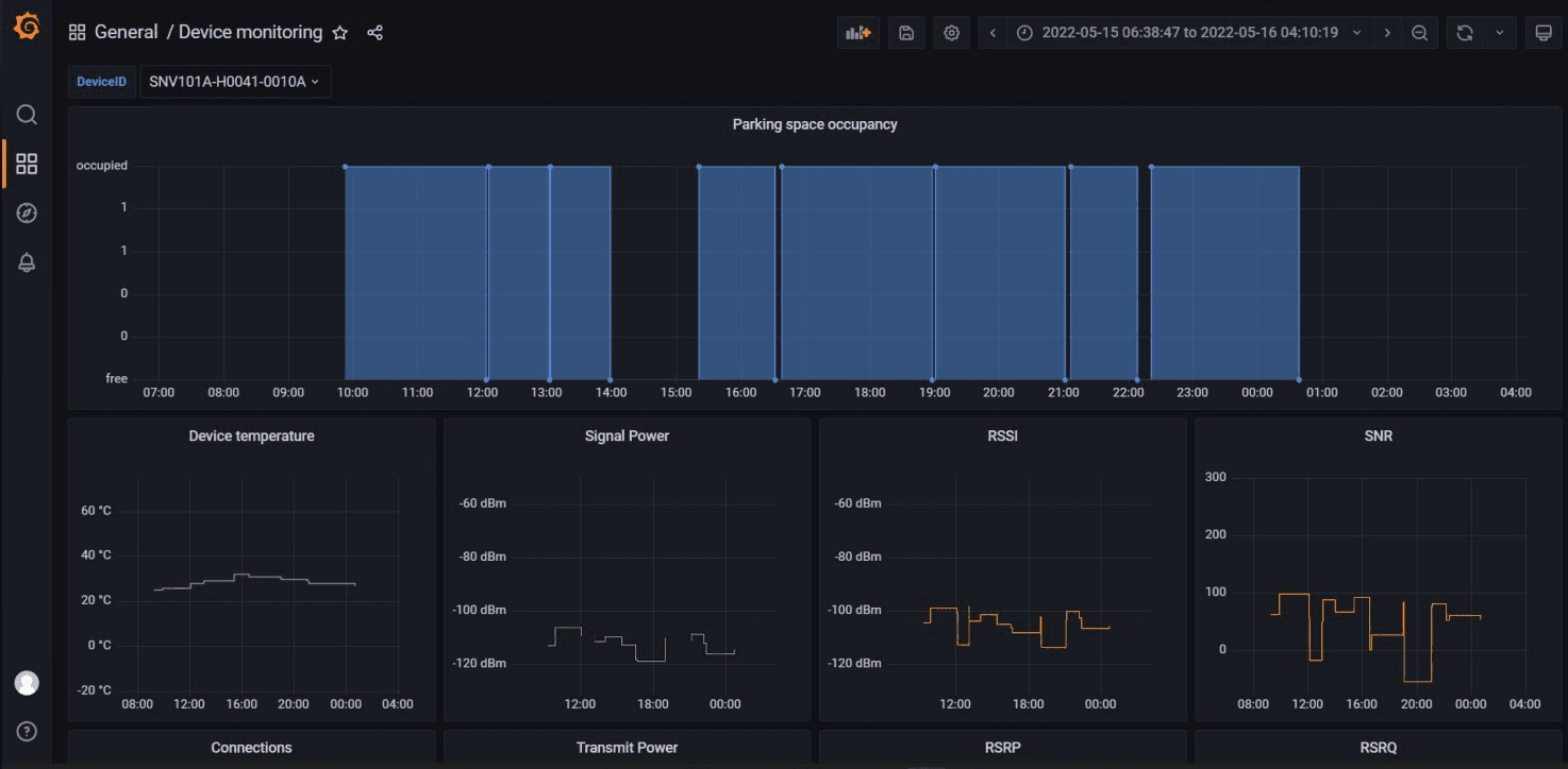

The Fuelics team utilizes a variety of Grafana dashboards to visualize measurements, track device metrics like battery life and capacity, and cross-check events to ensure accuracy and monitor sensor health.
One of the most valuable features of these Grafana dashboards is the ability to cross-relate events between the panels. For example, if there’s a spike in the motion detection alert panels, they can correlate the info with another data point like fuel level. This confirms that the tank has been refilled. “That’s how we actually double-check the successful implementation of the calibration parameters and the correctness of the measurements before we send them to the web app to be viewed by our client,” said Klavdianos.
Because they are able to collect so much data via Grafana Loki, each dashboard can display many data points over a seven-day time period for each sensor. The data is then simplified for clients and shared via a web application to provide accurate measurements and deliver insights on the resources being tracked. Grafana, said Klavdianos, “is a very useful way for us to frequently check the measurement correctness, accuracy, and generally monitor each sensor’s behavior.”
