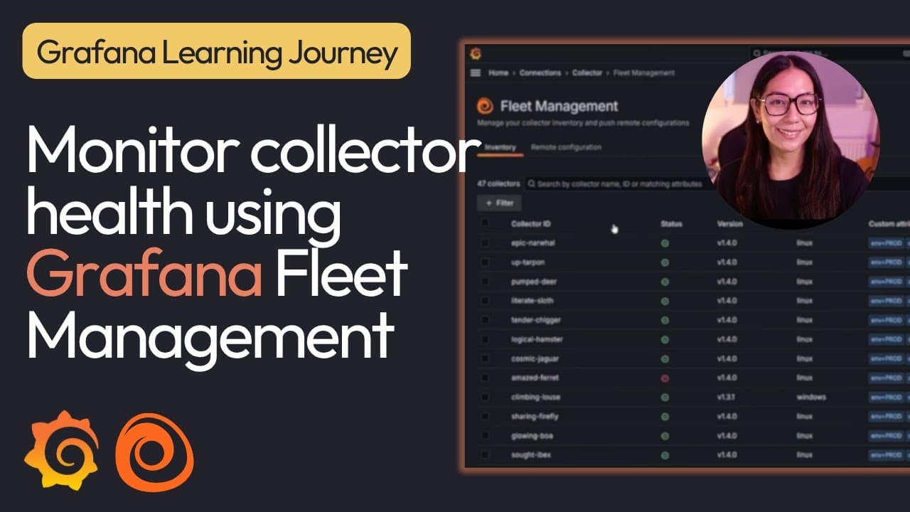

Fleet Management is a centralized control plane designed for managing observability collectors (primarily Alloy) at scale within Grafana Cloud. It enables remote configuration, monitoring, and optimization of telemetry pipelines (metrics, logs, traces, and profiles) across hundreds or thousands of collector instances, ensuring consistent observability without manual intervention on each device.
Fleet Management also helps you manage your inventory and centrally provision remote configurations. Under Inventory in the Fleet Management UI, you will see a registered list of your collectors, their health statuses, Alloy version, operating system, and attributes for each collector.
With remote configuration you can create, edit, activate, and delete configuration pipelines. Remote configuration allows you to build your telemetry pipelines, test the pipeline syntax, and then add matching attributes to assign the configuration pipeline to collectors. You can then activate or deactivate a pipeline with a toggle of the switch.
