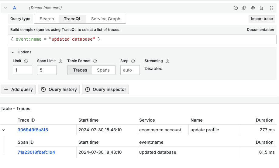

To query for event names, simply use the syntax event:name. Below is an example query for spansets where there is at least one event with name value of updated database.
{ event:name = "updated database" }
TraceQL query for span event

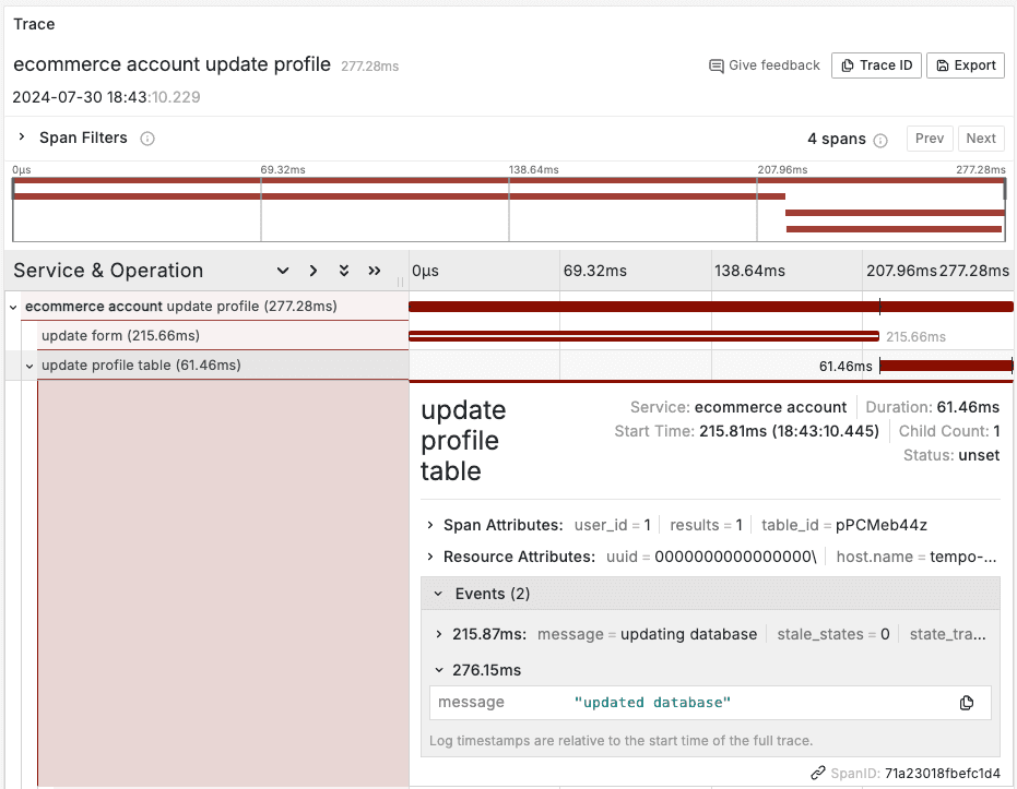

The query returned this matching trace where there is one span with one event matching the name updated database. By clicking on the span id, we can see more information about this event.
TraceQL query results for a span event
Here we can see that there were actually two events within this span. One event with the name updating database and another with the name updated database, which is the one we searched for. Based on the two events’ timestamps, we can see that it took about 60ms for the database operation to finish.

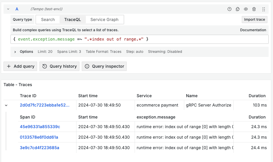

To query for event attributes, simply use the event. syntax. Below is an example of a query for an event attribute key called exception.message with the value partially matching index out of range.
{ event.exception.message =~ “.*index out of range.*” }
Event attribute query in TraceQL using span events

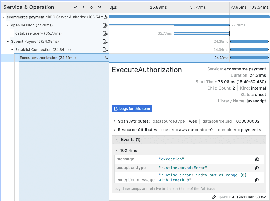

Here, we were able to find a matching trace with spans containing an event where the attribute exception.message partially matched index out of range. By clicking on the corresponding span id, we can see a detailed view of the trace.
Detailed view of trace after TraceQL query for event attributes
With the trace view open, we can see the sequence of steps that took place up until the error.
