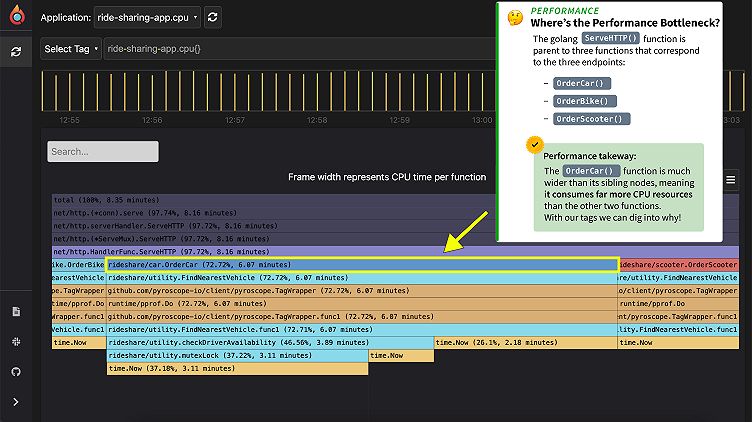

What this example will do is run all the code mentioned above and also send some mock-load to the 3 servers as well as their respective 3 endpoints. If you select our application: ride-sharing-app.cpu from the dropdown, you should see a flame graph that looks like this (below). After we give 20-30 seconds for the flame graph to update and then click the refresh button we see our 3 functions at the bottom of the flame graph taking CPU resources proportional to the size of their respective search_radius parameters.
Where’s the performance bottleneck?
Performance bottleneck pointed out in Pyroscope
The first step when analyzing a profile outputted from your application, is to take note of the largest node which is where your application is spending the most resources. In this case, it happens to be the OrderCar function.
