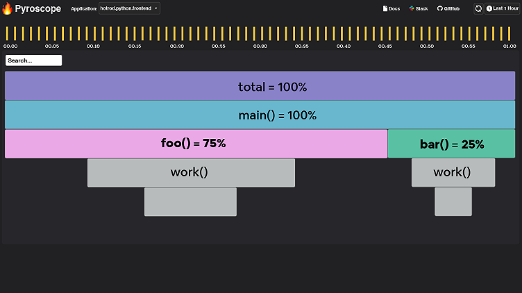

Let’s say the flame graph below represents the time span that corresponds with the “incident” in the picture above where CPU usage spiked. During this spike, the server’s CPUs were spending:
  • 75% of time in foo()
  • 25% of time in bar()
  • $100,000 on server costs
Flame graph
You can think of a flame graph like a super detailed pie chart, where:
  • The width of the flame graph represents 100% of the time range
  • Each node represents a function
  • The biggest nodes are taking up most of the CPU resources
  • Each node is called by the node above it
In this case, foo() is taking up 75% of the total time range, so we can improve foo() and the functions it calls in order to decrease our CPU usage (and save $$).

To recreate this example with actual code, we’ll use Pyroscope,an open source continuous profiler that was built specifically for debugging performance issues. To simulate the server doing work, I’ve created a work(duration) function that simulates doing work for the duration passed in. This way, we can replicate foo() taking 75% of time and bar() taking 25% of the time by producing this flame graph from the code below:
Pyroscope UI
# where each iteration simulates CPU time
def work(n):
    i = 0
    while i < n:
        i += 1
# This would simulate a CPU running for 7.5 seconds
def foo():
    work(75000)
# This would simulate a CPU running for 2.5 seconds
def bar():
    work(25000)
