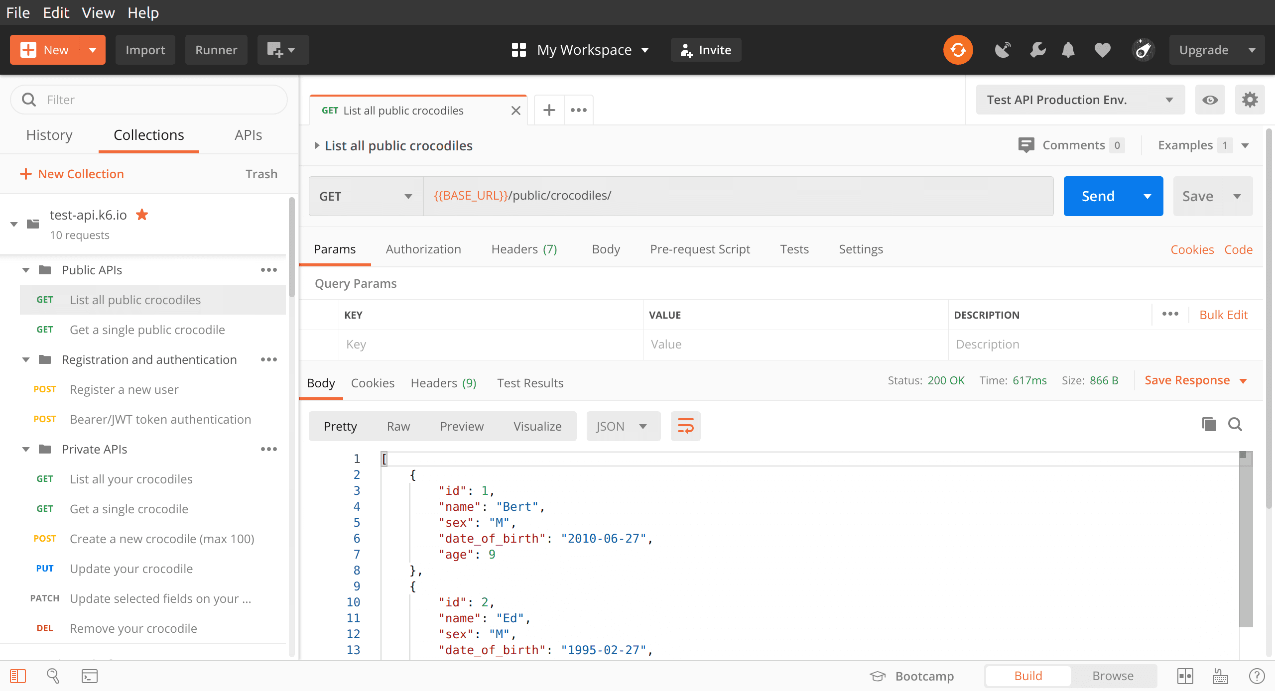

Our test API postman collection
To ease testing of our test API and demonstrate the usage of our Postman to k6 converter, I’ve created a Postman collection with almost all of our test API requests. You’ll see how you can access this Postman collection later on this load testing example.
This collection includes a set of collection variables, environment variables, pre-scripts, tests, authorization with two different mechanisms, and usages of the Postman Sandbox API.

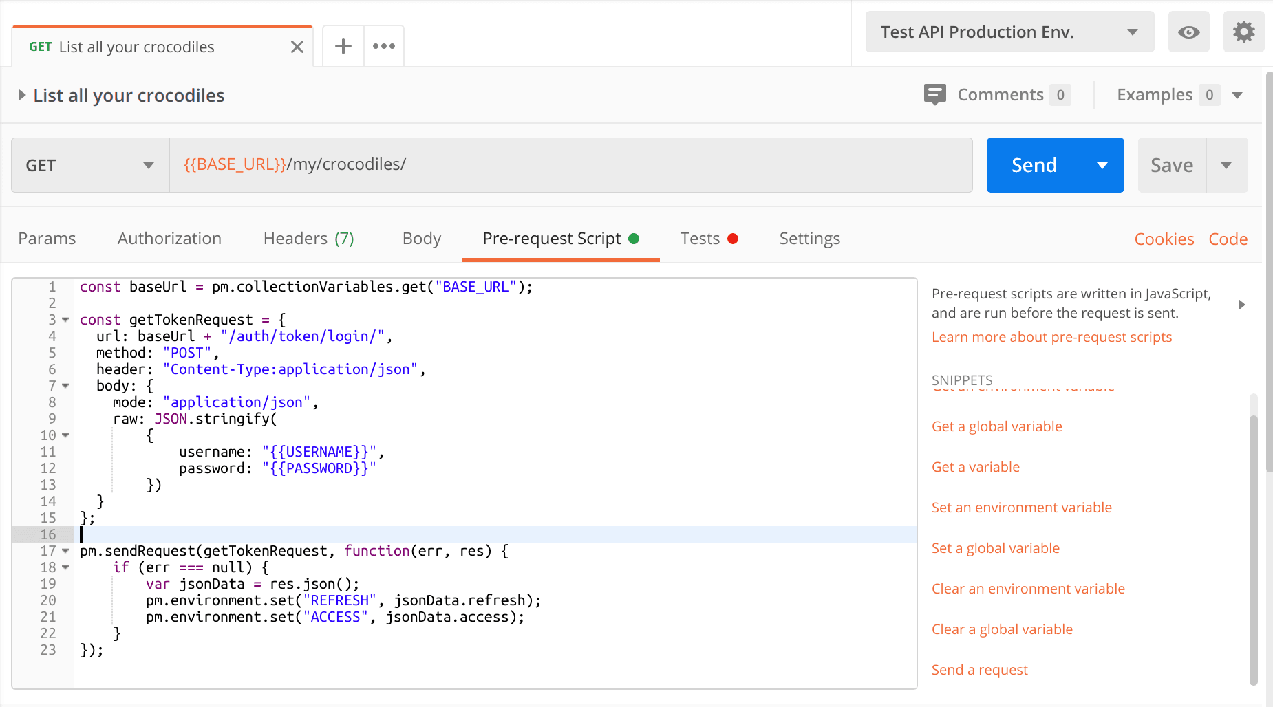

3. What adjustments did you make to the script to make it work?
First, I removed the pre-script containing pm.sendRequest, because it is not supported by the converter. Then, I replaced the jsonData.hasOwnProperty syntax with the equivalent k6 syntax for extracting JSON response information: response.json("selector").
