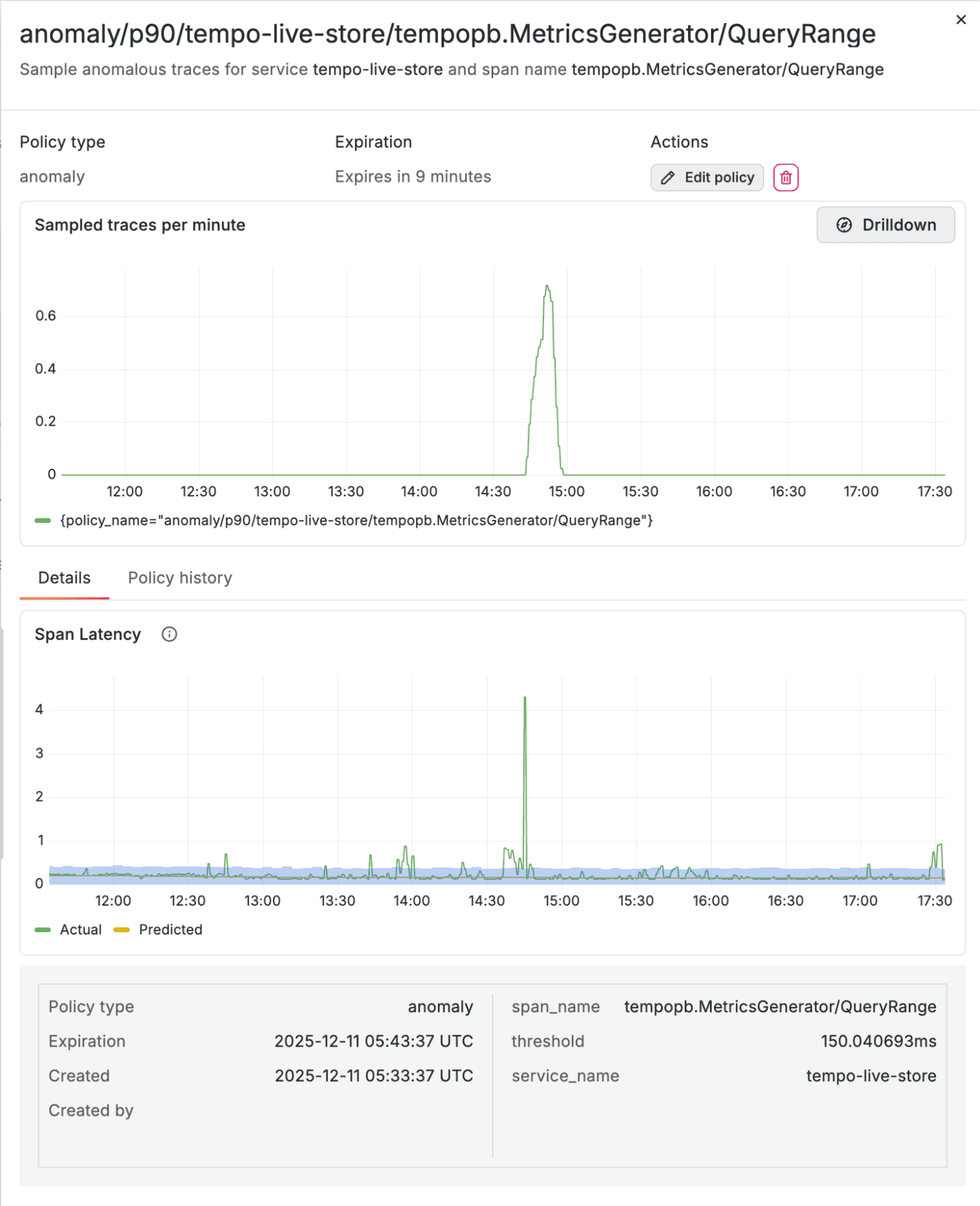

Anomaly detection
Adaptive Traces continuously analyzes ingested traces and sample anomalies, and uses machine learning forecasts on span metrics to detect when an operation is anomalous. If an anomaly is detected, it will automatically create a temporary policy that samples traces exceeding the predicted P90 latency or error rate. This process ensures the most interesting traces are there when your team needs them most.
Adaptive Traces will mark the anomalous traces with the attribute grafana.adaptivetraces.anomaly, which makes them easy to find using either the TraceQL query language or Grafana Traces Drilldown, an application that lets you explore tracing data through a queryless, point-and-click experience.
