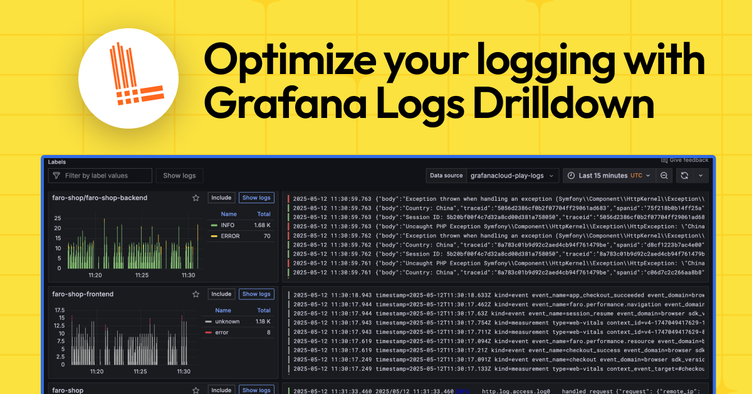

No one wants to waste time sifting through endless log lines, which is why we continue to invest in Grafana Logs Drilldown as a tool to help you find the information you need faster. With Logs Drilldown, you can easily filter your logs, dig deeper into your data using volume and text patterns, get automatic visualizations, and uncover related logs—all without having to write queries.
