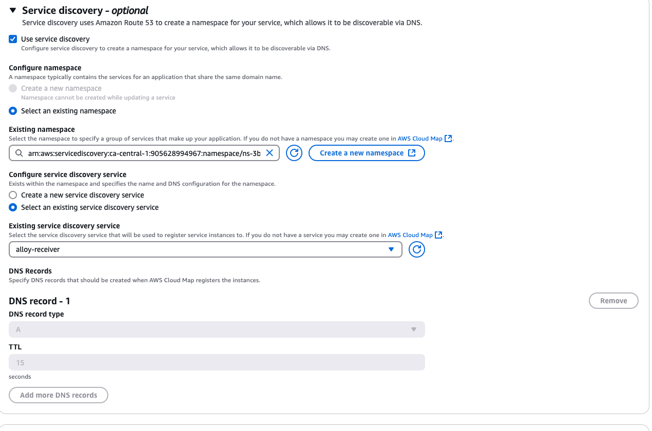

Finally, Alloy will use service discovery with a DNS name so that Beyla can send telemetry data to it.
A screenshot of the service discovery page for Amazon ECS.

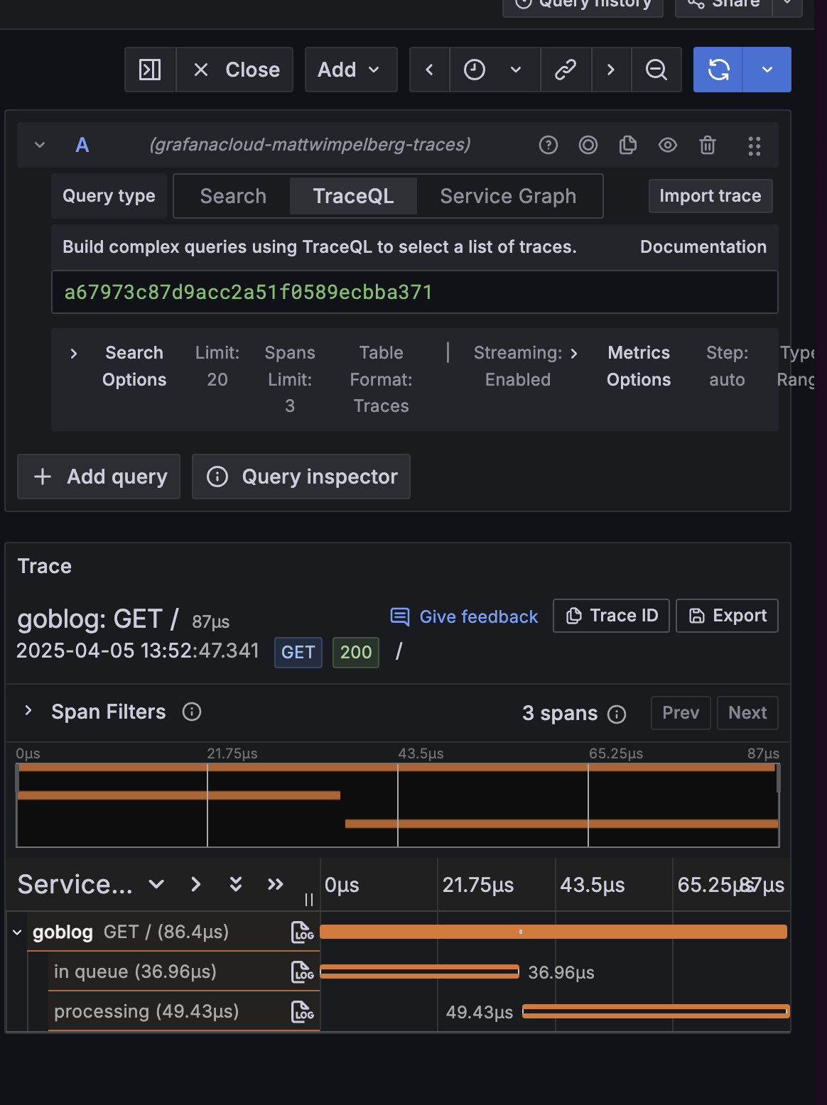

Once the data is received in Grafana Cloud Traces — the fully managed distributed tracing system powered by Grafana Tempo — you can query it alongside all other traces, regardless of source, to monitor and optimize application performance. The example below shows the TraceQL result, but metrics are also generated from Cloud Traces automatically, which enables Grafana Cloud Application Observability.
