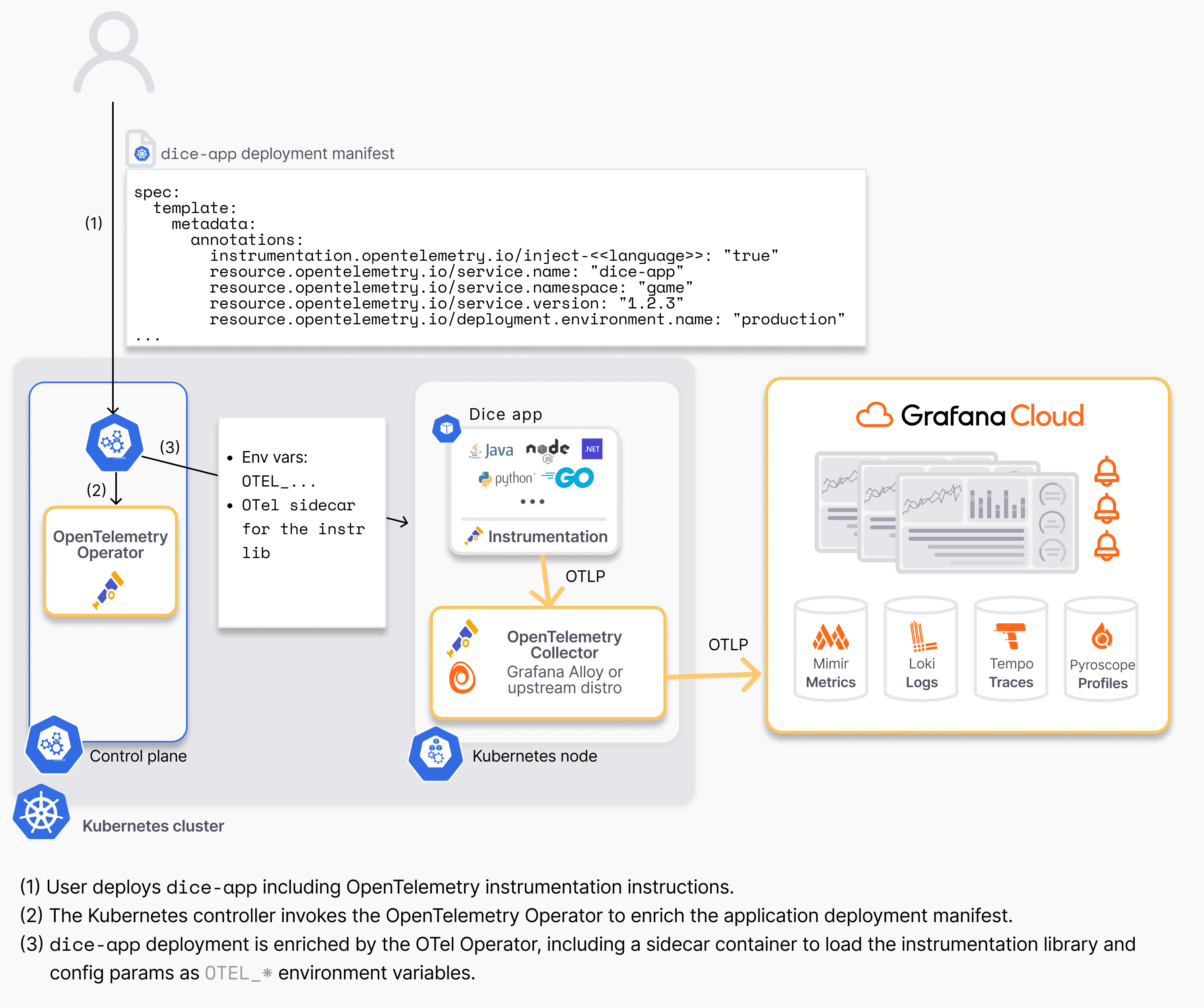

The OpenTelemetry Operator follows the Kubernetes operator pattern. In essence, it is a process running in your cluster watching for Kubernetes events. For example, the operator might detect that a new pod has been created, inspect its manifest, and decide to manipulate it to inject a new container depending on certain conditions (such as the presence of specific annotations in its PodSpec).
The operator can be configured via custom resources. Custom resources are a generalization of built-in Kubernetes resources (such as “Service” or “Deployment”) and allow extending the Kubernetes API with new, user-defined types of resources. New resource types can be added via CustomResourceDefinitions, which define the schema for each specific resource type.
In the case of the OpenTelemetry Operator, the operator watches for changes to custom resources it defines, including:
  • Collector: Manages the lifecycle of OpenTelemetry Collector instances running within the cluster.
  • Instrumentation: Defines how auto-instrumentation should be configured.
When a change is detected, the operator will do certain actions like creating/deleting pods or changing the way it instruments applications.

The OpenTelemetry Operator will inject auto-instrumentation agents/SDKs into our running pods. The custom resource my-instrumentation we just created defines default settings for every supported language, including the OTLP endpoint (our collector service). Additional auto-instrumentation directives can be specified (docs here). Using this information, the operator will add the right environment variables and libraries to our running pods.

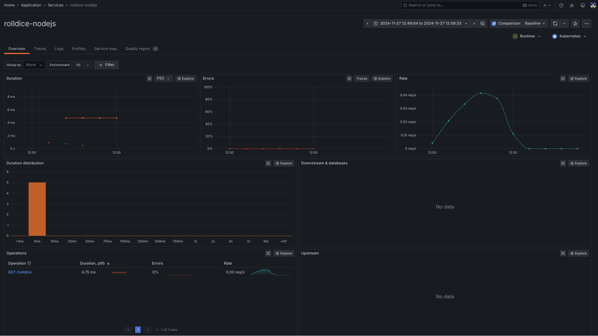

Grafana Cloud dashboard
