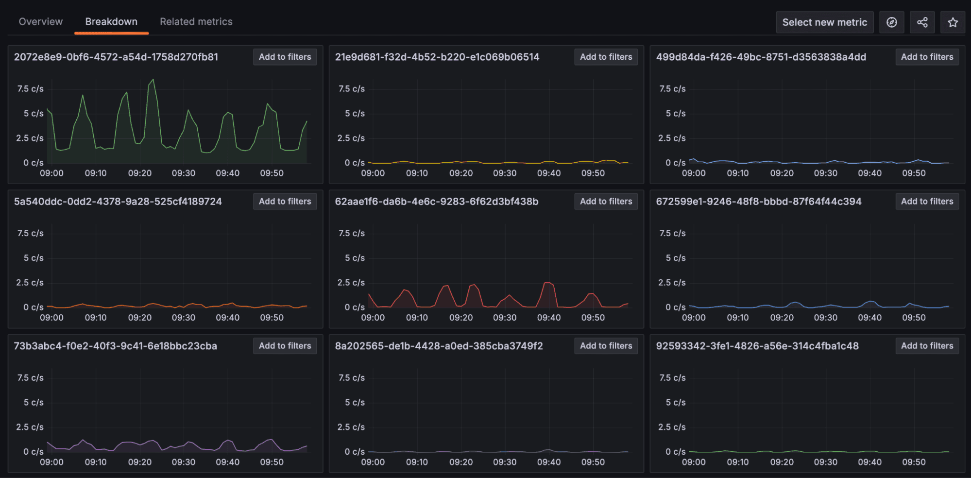

For example, select the chart for traces_spanmetrics_latency_count and it will open a page that lists all possible resources that you can do a breakdown on. By clicking on any of the values, you can see different charts broken down by the different attribute values of the resource you selected. You can also make this selection by clicking on the Breakdown tab, and then on any of the resource names. Here is how it looks when selecting host_id:
A screenshot of the Breakdown tab.
In this example, we can see that the first chart has higher values compared to the other ones. If you already know the difference of that host compared to the others, that can help you identify what is causing the higher latency values for that specific resource. This would work similarly if choosing other resources, such as service_instance_id and so on.
