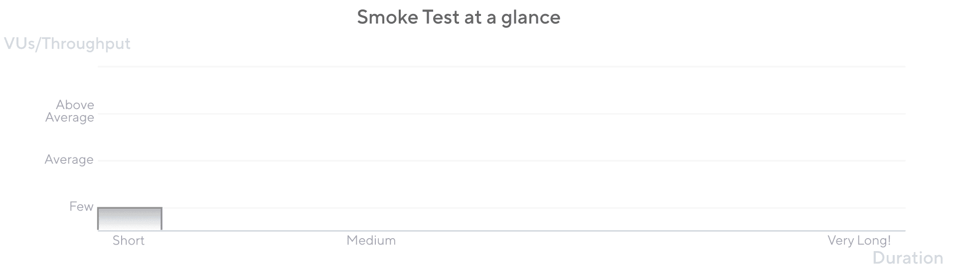

Smoke tests are a load testing type that have a minimal load, and they are used to verify that the system works well under minimal load and to gather baseline performance values.
This type of load testing consists of running tests with a few VUs—more than 5 VUs could be considered a mini-load test.
Similarly, the test should execute for a short period, either a low number of iterations or a duration from seconds to a few minutes maximum.
Smoke test chart in Grafana k6

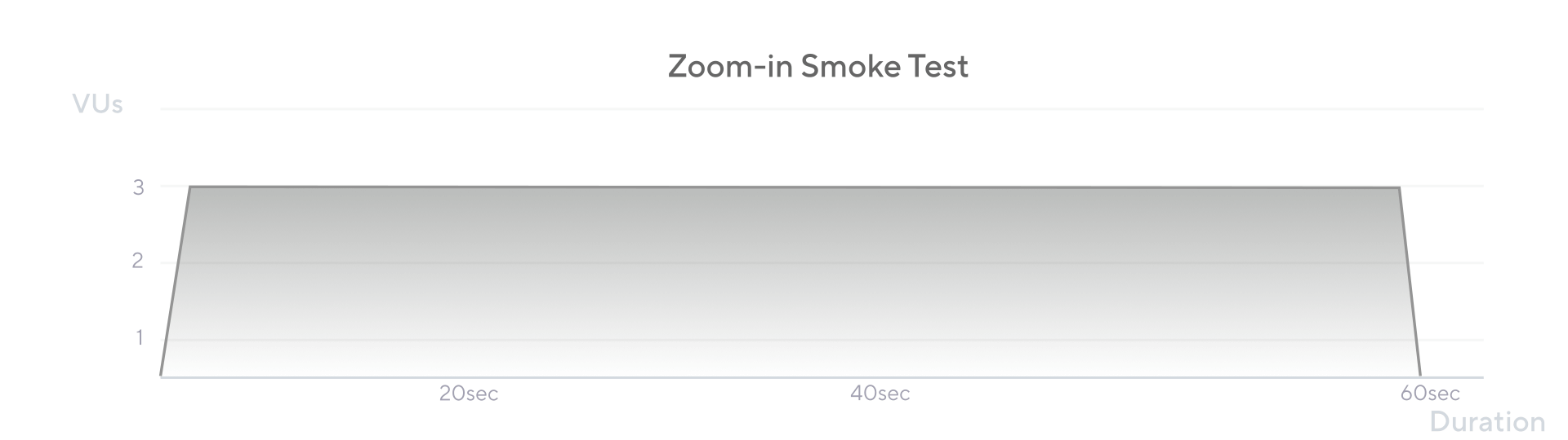

The following script is an example smoke test. You can copy it, change the endpoints, and start testing. For more comprehensive test logic, you can find more load testing examples in our k6 documentation. The VU chart of a smoke test should look similar to this:
Smoke test chart for a longer duration in Grafana k6.
