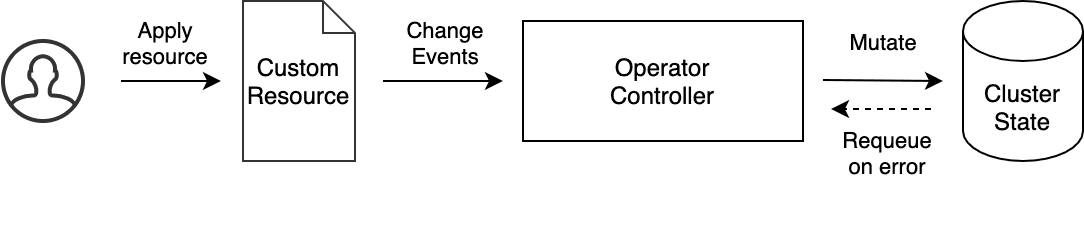

The Kubernetes operator pattern
The operator pattern is a way of extending Kubernetes so that you may use custom resources to manage applications running in the cluster. The pattern aims to automate the tasks that a human operator would usually do, like provisioning new application components, changing the configuration, or resolving problems that occur.
This is accomplished using custom resources which, for the scope of this article, could be compared to the traditional service requests that you would file to your system operator to get changes applied to the environment.
Operator pattern.

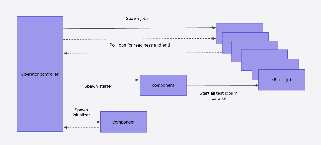

The operator will listen for changes to, or creation of, k6 custom resource objects. Once a change is detected, it will react by modifying the cluster state, spinning up k6 test jobs as needed. It will then use the parallelism argument to figure out how to split the workload between the jobs using execution segments.

The pods have now been created and put in a paused state until the operator has made sure they’re all ready to execute the test. Once that’s the case, the operator deploys two other jobs, k6-sample-starter and k6-sample-initializer, which are responsible for making sure all our runners start execution at the same time and for coming up with some sanity limits for the test run.
Let’s wait a couple of seconds and then list our pods again:
$ kubectl get pods
NAME                          READY   STATUS      RESTARTS   AGE
k6-sample-3-s7hdk             1/1     Running     0          76s
k6-sample-4-thnpw             1/1     Running     0          76s
k6-sample-2-f9bbj             1/1     Running     0          76s
k6-sample-1-f7ktl             1/1     Running     0          76s
k6-sample-initializer-29799   0/1     Completed   0          66s
k6-sample-starter-scw59       0/1     Completed   0          56s
All right! The starter and the initializer have completed and our tests are hopefully running. To make sure, we can check the logs of one of the jobs:

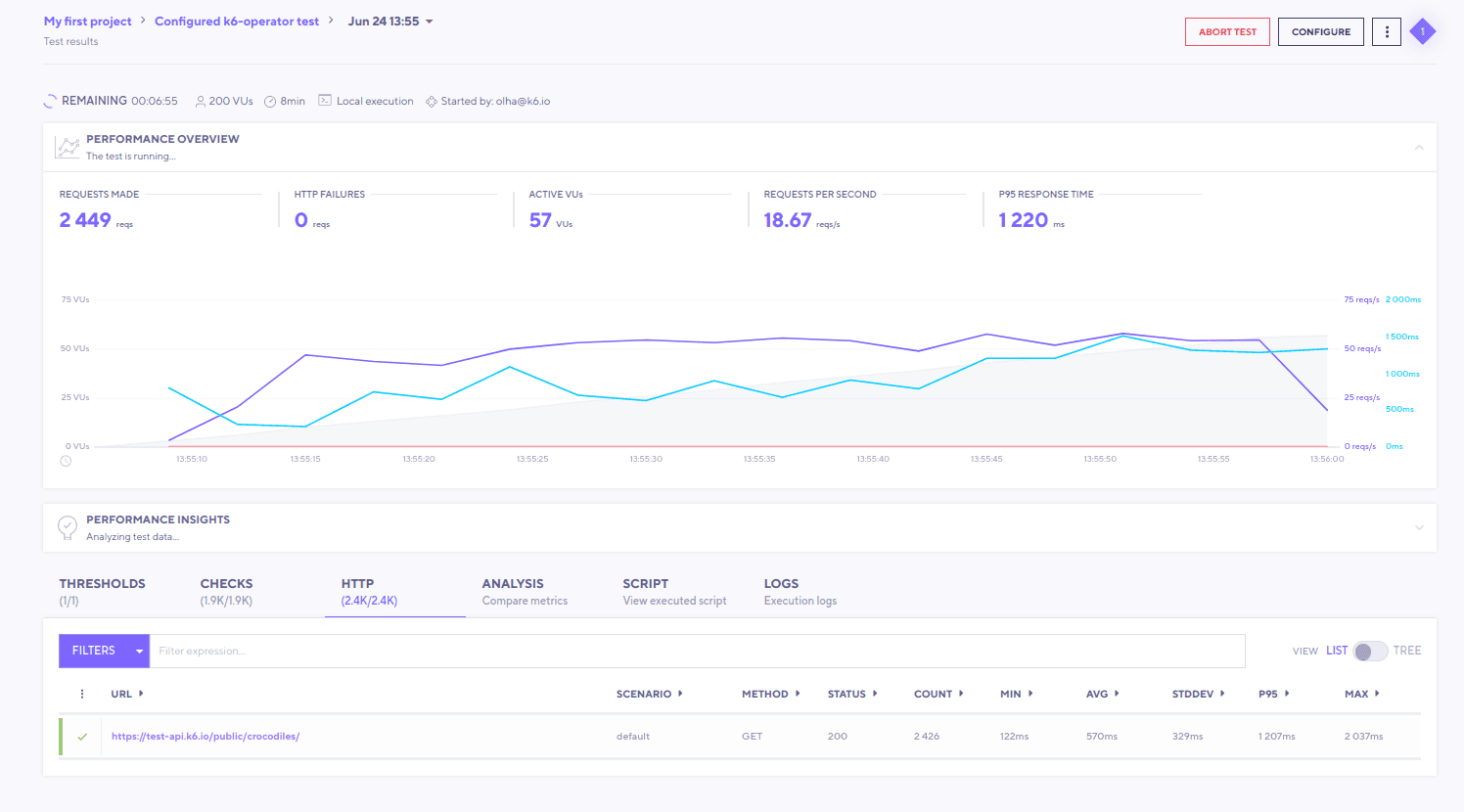

Cloud output
Starting with v0.0.7, k6 operator has support for Cloud output, as a subscription feature. This is a distributed version of local Cloud output in context of Kubernetes operator.
To use it, we need to firstly deploy our k6 Cloud token. We do that by uncommenting the Cloud output section in main kustomization.yaml and paste our token to the token field. See the Cloud app’s settings to retrieve that token. Once that is done, we need to run make deploy to make sure our token is deployed to the cluster:
$ make deploy

Note the appearance of the secret/k6-operator-cloud-token-f295md8b95 line.
Now we can simply pass the --out cloudto our custom resource definition:
apiVersion: k6.io/v1alpha1
kind: K6
metadata:
spec:
  parallelism: 4
  arguments: --out cloud
  script:
    configMap:
      file: test.js
And that’s it! Once the test starts, each runner will start sending metrics to k6 Cloud and we’ll be able to see them in the app:
Cloud output test run.
It must be noted that, currently, this feature has limitation on parallelism: it should be no more than 20.
