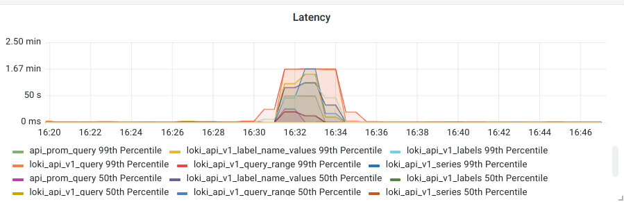

We’ll start by checking the Loki / Reads dashboard, which is included in the loki-mixin:
Embedded image
It looks like that’s a period of time in which our QPS (queries per second) nearly halted at the same time that our latencies skyrocketed. This makes me think that our read path is congested, queueing up queries and causing the queries that do execute to be very slow. We notice that all the query types see increased latencies during this surge, which supports the idea that either there aren’t enough queriers or that the queriers are overloaded.

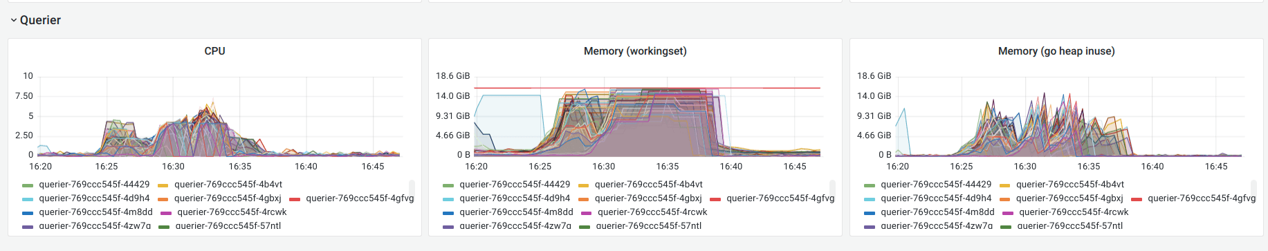

Next, let’s pivot over to the Loki / Reads Resources dashboard, which is also included in the loki-mixin. This dashboard shows resource usage:
Embedded image

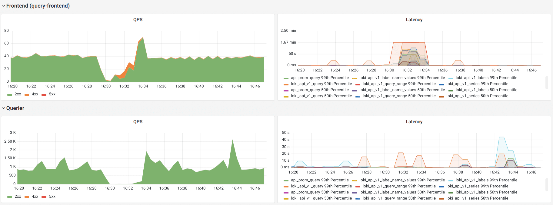

Oof, that’s a lot of memory! It looks like the querier pods jumped straight to their limits during this high-resource usage time period. Pivoting again to the Loki / Operational dashboard, we can also see this caused a bunch of the queriers to restart!
Embedded image
Well, that’s one way to go from bad to worse.

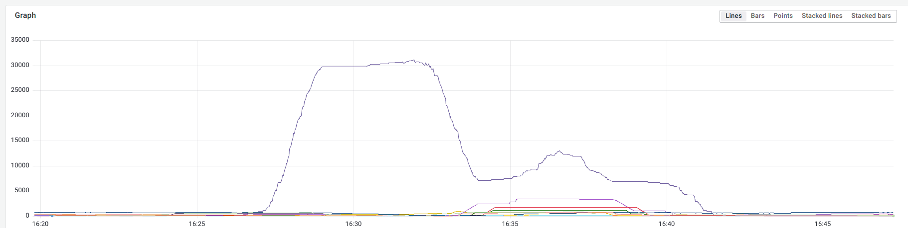

The query results show us the following. The tenant identifiers are omitted:
Embedded image
As we can see in this graph, one tenant stands out dramatically from the others! I then ran this LogQL query with the < cluster >, < namespace >, and < offending_tenant > fields filled in, to see what type of queries were being run:
