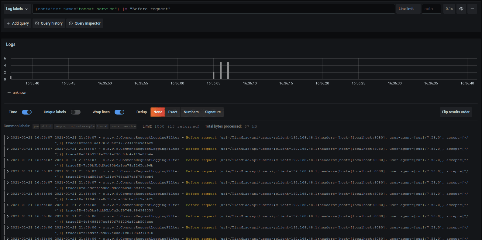

After I rebuilt the war file with maven, the following log lines began appearing in Loki:
Embedded image
I assume it has something to do with the @Bean or @Configuration annotation. I didn’t ask questions, and Java yielded no answers.

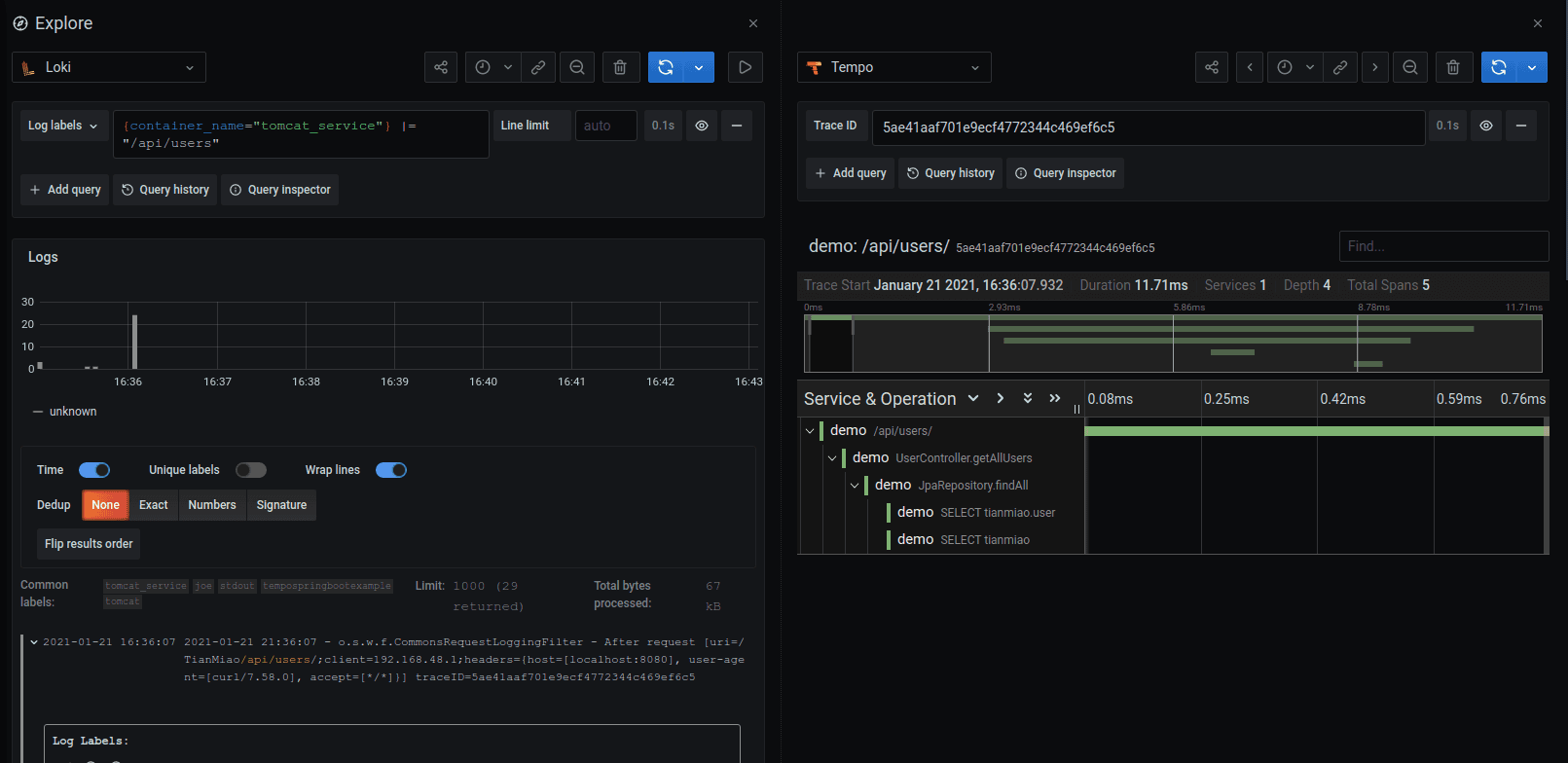

Now that we have our logs in Loki and our traces in Tempo, we can easily search for traces and then jump directly to them via a handy link in Grafana:

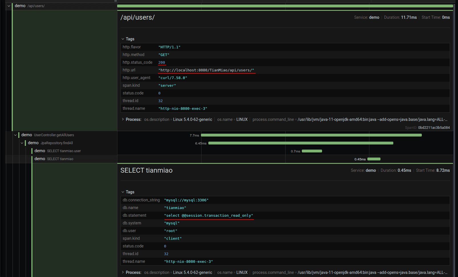

Looking closer at the trace, we can see valuable information such as the path requested and the query executed. Nice work, OTel Java folks!
